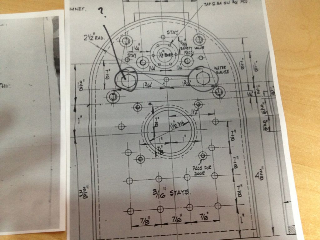

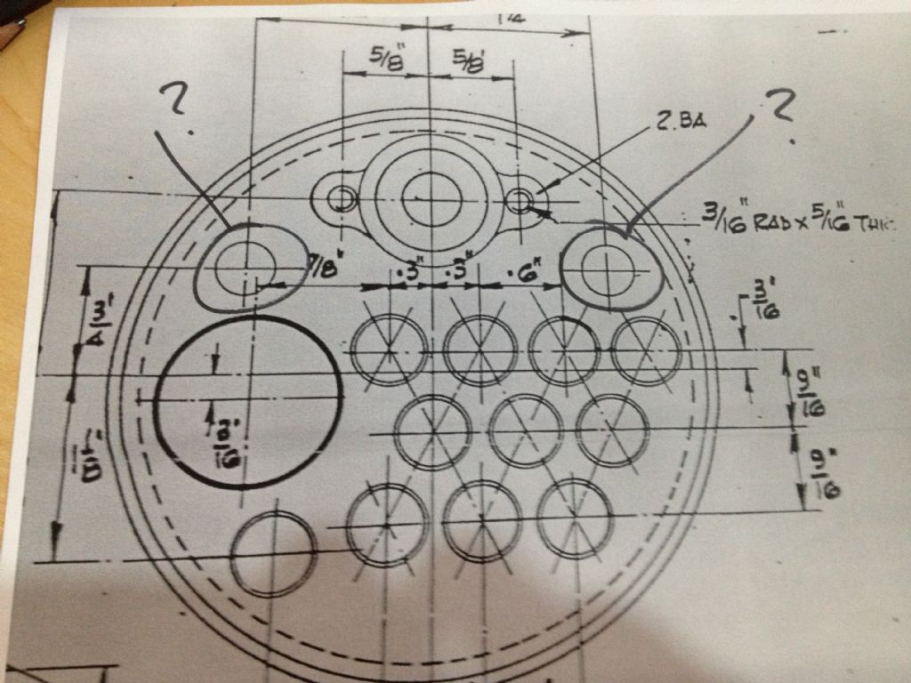

      Hi all,
      I am at the final stages of soldering my boiler up and i noticed on the drawing some holes that i am struggling to see what purpose they serve.
      The back head has 2 holes with what look like plugs in,yet the drawing does not call for threaded bronze inserts to be soldered in or any reference to what size thread etc,Could these be some type of run out plug?
      The front tube plate again has 2 holes with no corresponding boiler tube plug or anything?
      Any idea or help much appreciated!

        3 1/2 Guage Lilla Locomotive Boiler

          Possibly they are for a couple of boiler stays which run from front to back, have seen similar on a RobRoy

            They are for 1/4" Boiler Stays. Take a look at the other Fire-Box Drawing.

              Yes i was beginning to think that,why then do you think that one end is shown as a blind nut (SS to backhead) and the other end on the front tube plate with no diameter?
              Also in the EIM write up it makes no reference to them at all,do i presume they are like tie rods with blind nuts ss to place?
              Thanks for your replies the fog is clearing,just didn't want to finish the soldering to have to start again or even make a schoolboy error.
