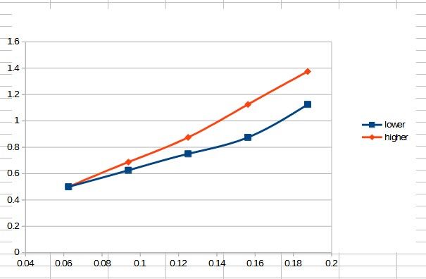

                                        There is not and cannot be a relationship between tube plate thickness and barrel thickness. Require tube plate thickness is dependant on material properties, working pressure and stay (or tube) pitch.
                                        I have given references to where formula for working out stay pitch can be found. There seems to be some reluctance to follow these up.

                                          The relationship between end plate thickness and stay pitch is linear in those and is not linear in the K.N. Harris table.

                                            so who are you going to believe, national standards (both UK and Aus) or KNH? I've no idea where KNH got his figures from.
                                            Reading KNH again after many years, he quotes stay pitch for pressures of 100-120 psi, and then goes on to give a range for the required pitch. Perhaps this is meant to mean take the lower for 100 and the higher for 120, but he only quotes one figure for 16g, which makes no sense. In any case, if you plot the upper and lower figures for stay pitch against material thickness you get this
                                            Bearing in mind that KNH only quotes to nearest 1/16" I'd call that fairly linear. I wouldn't expect to get close agreement with the Aus standard or my figure derived from UK standard.as KNH uses an acceptable working stress of 3125 psi, which is somewhat lower than UK or Aus

                                              The problem is that if you work out the loading on a stay threaded 5BA @ 120psi it is not strong enough at 1/2" spacing and comes below Harris's suggested factor of safety
                                              Using his calcs a stay supporting 120psi @ 1/2" spacing needs a Cross section of 0.012 sq in. but the core dia of 5BA is 0.0073 sq in this falls below his suggested average safety factor of 8 ( 25000/8 = 3125). The 6BA at the same 1/2" spacing would be outside his safety factor range of 6 to 10 completely.
                                              His spacing table does seem fairly linea going down 1/8" spacing for each 1/32" drop in plate thickness. So you could say that for 1mm / 0.040" plate the spacing of 1/8" stays would need to be about 10mm, so 7mm between stay or tube edges. Just need to arrange enough of your 10mm tubes to meet that spacing withing the 50mm or so dia of teh end plates. Probably needs a ring of eight tubes around a central one so 9 tubes in total, they will be stronger than stays.
