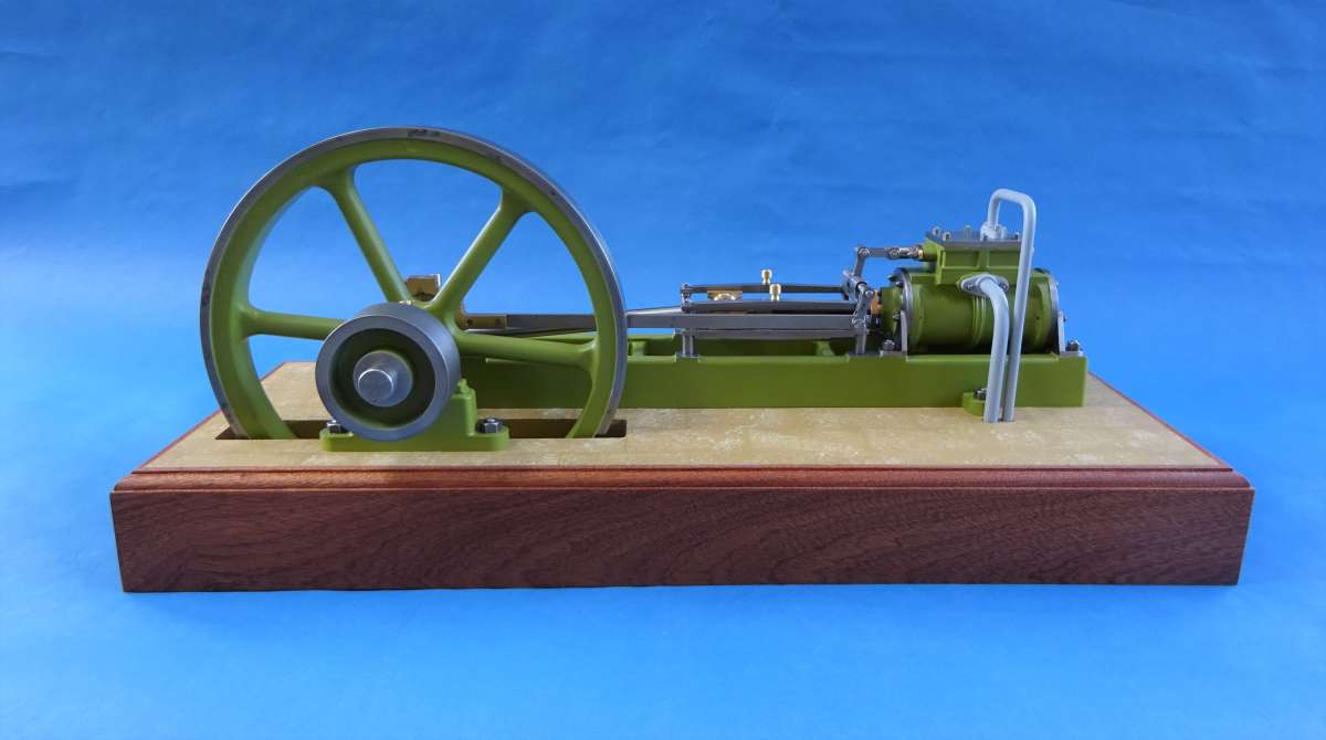

      I have just completed a Stuart Victoria stationary engine, my first build from castings. I originally planned to just run it from compressed air but my ambitions have grown to considering the live steam option.
      The engine has a 1″ bore and stroke, ~13cc swept volume, x2 per revolution (double acting cylinder). @ 300rpm thats approx 7.8L of steam.
      I am considering 3 boilers, but its impossible to know the volume of steam they could supply.
      For burners I think gas via a regulator is the cleanest option giving instant heat control.
      1. Pisces stationary Babcock type boiler 250Lx100wx370H  (inc burners) pressure vessel made from clevedonsteam.co.uk. Unlike its full size counterpart this does not appear to have a superheater, but I wonder if one could feed the steam outlet under the boiler to achieve this ??
      2. Virgo Steam plant kit  250Lx110Wx250Hmm pressure vessel made from clevedonsteam.co.uk. This is a conventional flu type boiler which seems very inefficient to me. With such a low flu gas to copper area I would not expect large steam volumes, but never having had a boiler I have no clue.
      3.Maccmodels horizontal 280L x 115 W x  444mm high. This is a complete kit so silver soldering is a must. This is one of the few boilers which gives clear information and technical info.
      The door openings are 1-1/2″ high x 2-5/8″ wide. The water space is 3″ dia. x 8″ long, 44 cubic inch volume. The fire box is 3″ wide, 7″ long x 1-3/4″ high. It also has a cleanout door that opens to access the flues. It has five copper flues 5/8″diameter, 127 square inches of heating surface.
      My current thinking is to go with #1, the babcock type. It can hold more water and level is not so critical. It has no internal flues to clean and is easy to inspect, plus it is already silver soldered.
      I would very much appreciate any comments from owners/users.
      I am planning to drive a dynamo, feed pump and governor via a gear drive from the crankshaft. I have also replaced the std piston oring seal with a graphited ptfe ring which was a worthwhile improvement.
      Any advice or comments much appreciated.

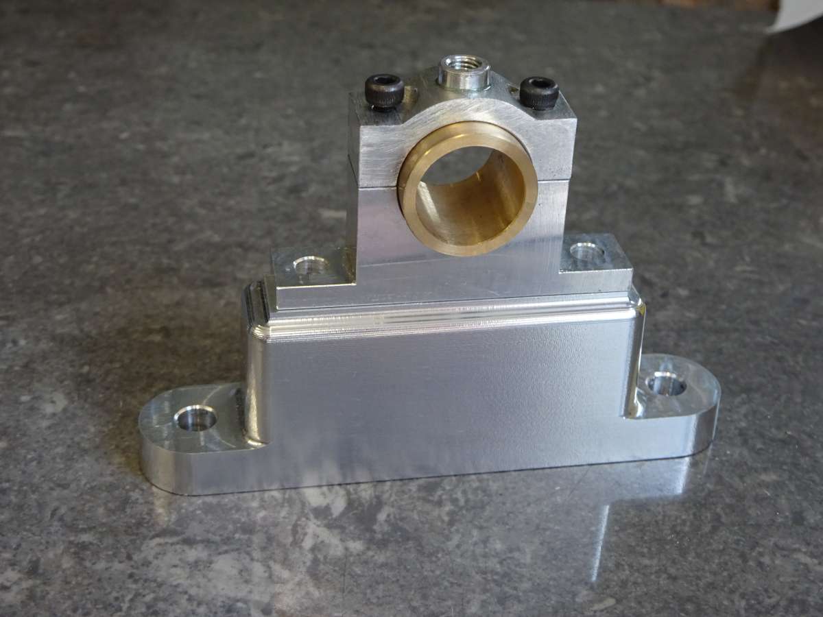

                                          One of the snags with the Victoria is that the flywheel and its support are on different levels to the base casting. On mine its 53mm. However this is quite a boon allowing a lot of room for hidden chicanery.
                                          The 300 rpm was just something I estimated from running on compressed air, I would think 1/2 that speed would be adequate. I will do some tests with a mock up and see what the performance performance is with various loads.

                                          #694696
                                            The different level issue is easily solved by changing the cast outrigger bearing support to a new one that can be made from a couple of bits of aluminium and suitable shaped to look like a casting.
                                            You can then mount the engine on a hollow wooden base which make sit easy to hide wiring, pipework and anything else you want to keep out of site. This is my Victoria

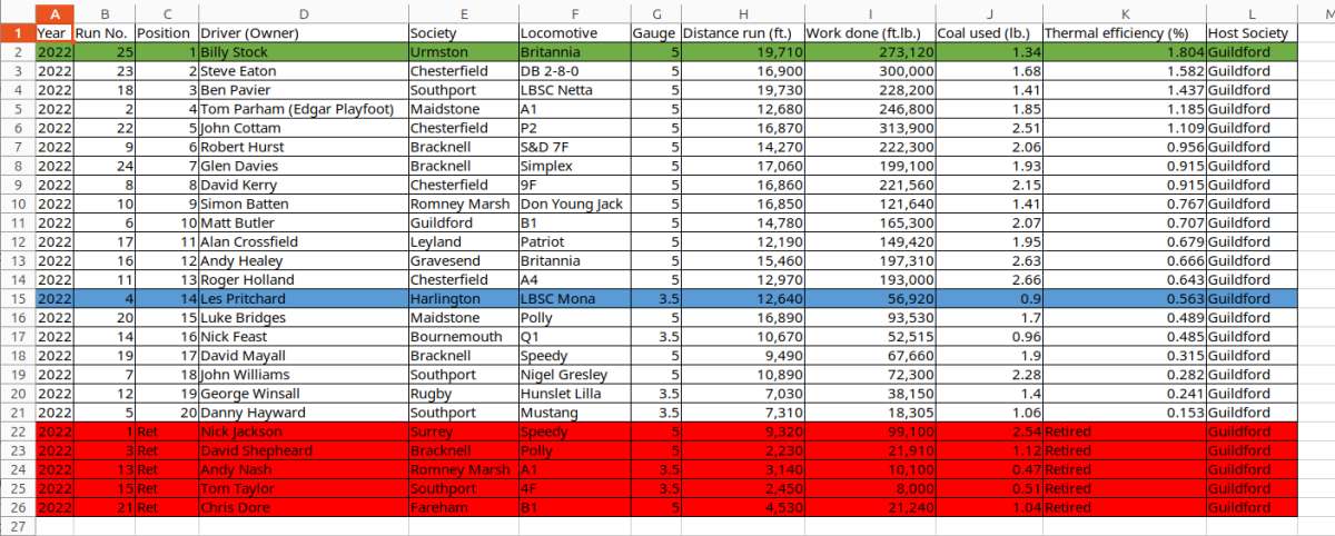

                                              IMLEC is the International Model Locomotive Efficiency Competition, a more or less annual event in the UK where several model locos compete for an efficiency prize – thermal efficiency.
                                              Great fun and not completely scientific, but you might get a decent description of the engine, an account of the run, and they measure the coal consumption (heat input), work done, and distance travelled.  From this can be calculated the Specific Coal Consumption in lbs/HP/hour and/or Thermal Efficiency.  Spreadsheet results here.  Also, an account of each was published in Model Engineer magazine.
                                              Perhaps the most striking feature of the competition is how inefficient model locomotives are, and that the reasons some do better than others isn’t obvious.   The 2022 results:
                                              2022imlec
                                              Best engine achieved an efficiency of 1.804%, whilst the least was 0.153% efficient – a range of 10 to 1!   Reasons not necessarily the engine is inferior: they include things like greasy rails, heavy handed drivers, fire too small or over-coaled, flanges grinding, valve timing wrong, mechanics slipping out-of-order, load larger or smaller than the engine’s sweet-spot, poor coal,  etc etc etc.   I think small defects  are amplified in small engines compared with big ones:  scale matters!
                                              As far as I know, no-one has ever done a fully controlled scientific comparison or a completely modern redesign; for example most CAD packages can do thermal and other mechanical analyses, which might allow a modern loco to achieve peak efficiency by optimising everything.  Hard work though, and the law of diminishing returns applies.   Improving efficiency becomes progressively more difficult.
