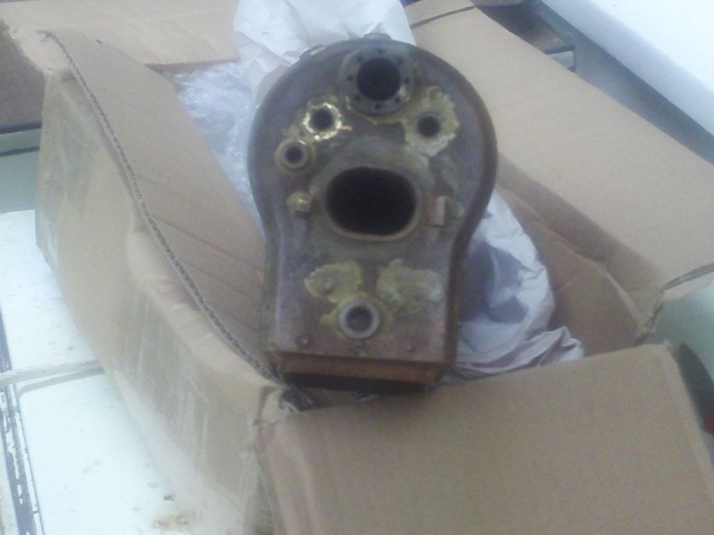

      Can anyone please identify this 3.5inch boiler?
      #1071
      jon elbourne
        @jonelbourne66394
        unknown loco boiler

          @doubletop
          Jon
          I’ll have no idea what it is but can I suggest more pictures would help? Side view, plan view, firebox and smokebox at least.

          Steambuff
            @steambuff
            Jon
            Some dimensions would also help …. Take the photo with a 12″ rule next to it?

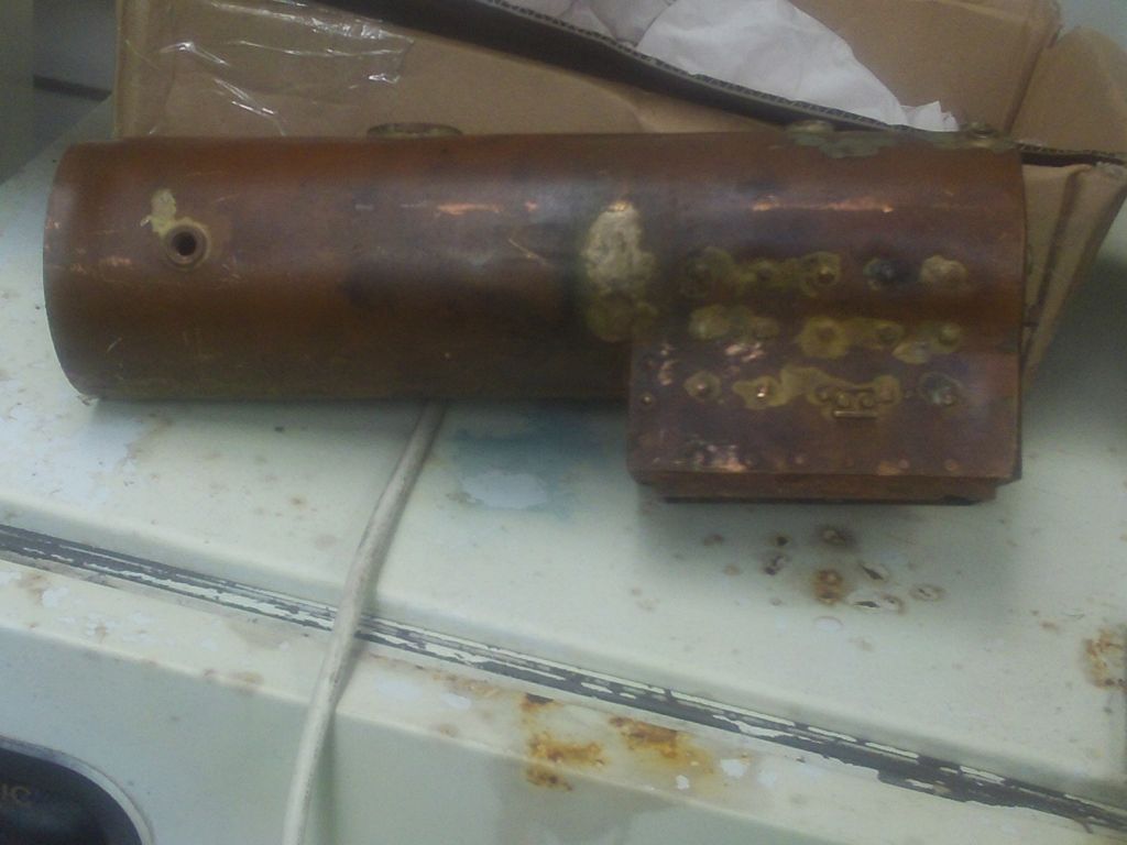

            jon elbourne
              @jonelbourne66394
              Its 310mm long overall and 93mm diameter.

              nigel jones 5
                @nigeljones5
                not got drawing to hand but looks like Juliet
                #83292
                AndyP
                  @andyp13730
                  My Juliet drawings show 12 1/4″ by 3 1/2″ OD so could be, backhead arrangement is about right once the stays go back in, 9 off 3/8″ flues and 2 off 3/4″ superheater flues ?
                  Andy
                  #83293
                  nigel jones 5
                    @nigeljones5
                    checked drawings…Its definately Juliet
                    #83296
                    jon elbourne
                      @jonelbourne66394
                      Thanks Nigel and Andy. Flues are right. Must be Juliet! Maybe I should try this one before my 5inch Minx? It needs an awkward repair and I will consult boiler inspector before attempting anything!

                          Hullo Nigel, Postage to and from UK is pretty horrendous, but might be worthwhile! Tig welding on new boilers in Australia must be done by a certified welder and is strictly supervised. I don’t know what the UK equivalent would be. The Boiler I have looks as though it has never been fired, but someone has removed the two longitudinal stays, one of which I think was hollow. In the process they damaged the smokebox tubeplate rather badly and the tubeplate is copper welded to the barrel. My email is jone@ispdr.net.au if you would like to contact me or we can continue the discussion on the forum.

                            Richard Parsons
                              @richardparsons61721
                              Jon
                              If the only problem are the two longitudinal stays that is not too bad. The original is copper and was ‘Silver’ (hard) soldered. As these stays were under tension I would make two ‘Top Hat’ bushes for each stay to push in from the outside. I would probably had them threaded internally to fit the stay. Clean up the boiler area well where they where they would be fitted and silver them in using the lowest melting point Silver’ (hard) soldered spelter. Do not forget to clean flux everything before fitting.
