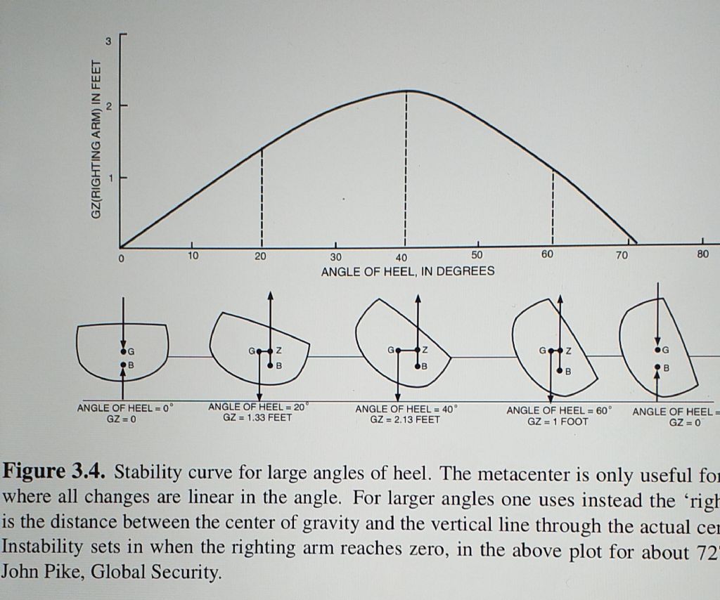

                      Andy_G
                        @andy_g
                        Posted by SillyOldDuffer on 08/12/2020 10:52:52
                        provided the total weight of the model is smaller than the displacement, it will float.
                        It won’t float for long unless the centre of gravity is also below the centre of buoyancy (lateral and transverse)
                        I’d be surprised if the displacement didn’t come out between 7 & 8 kg (15-18 lbs).

                          Buffer
                            @buffer
                            Posted by Andy Gray 3 on 08/12/2020 13:02:46
                            Are you sure about that?

                              Andy_G
                                @andy_g
                                Posted by Buffer on 08/12/2020 15:40:22:
                                Fair cop. Didn’t want to get into righting moments, but simplified it a step too far face 20
                                Point should have been that stability is a consideration as well as just displacement which requires consideration of the C of G.

                                #512427
                                Tim Rowe 1
                                  @timrowe1
                                  Buffer has it correct. A vessel has to have a positive Metacentric Height to be stable. The cg can be above the cb.
                                  His diagram shows that the cg stays fixed but the centre of buoyancy moves outwards creating a righting lever. All the time you have a righting lever the vessel will return to upright (wave motion excepted) but once a certain angle of heel reached, you are going to get wet.
                                  If a ship is carrying a very dense cargo such as iron ore, the cargo is built up into a pyramid to raise the cg. Otherwise the ship could be too stable and be over-stressed by the more violent motion this would produce.
                                  The is a high speed superyacht that was built with an alloy hull to save overall weight and a steel superstructure to make it less twitchy and more comfortable. It is true however that the other way around is the norm.
                                  Tim
