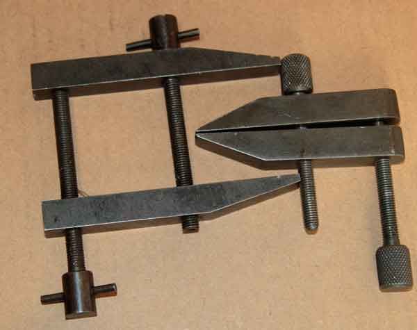

          This is a practical example of two different techniques, not recent I add. There is some wear, but it does illustrate the durability, albeit with the limitations of the photo reproduction
          The one of the left  I made at school, I think in 1978 and was blued by heating and dipping in in old engine oil.
          On the right was an apprentice piece, made in 1980 and phosphated using a commercial process.

                      Stuart's photo illustrates well that most bluing methods (with the exception of the gentle heating to tempering colour method explained by Martin in his post above) result in a black or nearly black colour. I wonder why it got to be called bluing?

                          Rod, I think you will find that blacking and blueing are two different processes. Blueing in the home workshop is a temperature sensitive process and blacking is a chemical one. On choices of material for blacking stay away from alloys that contain any chromium, don’t ask me how I know!3230bd40-4d31-4e82-b089-a656c39d05de.jpeg
