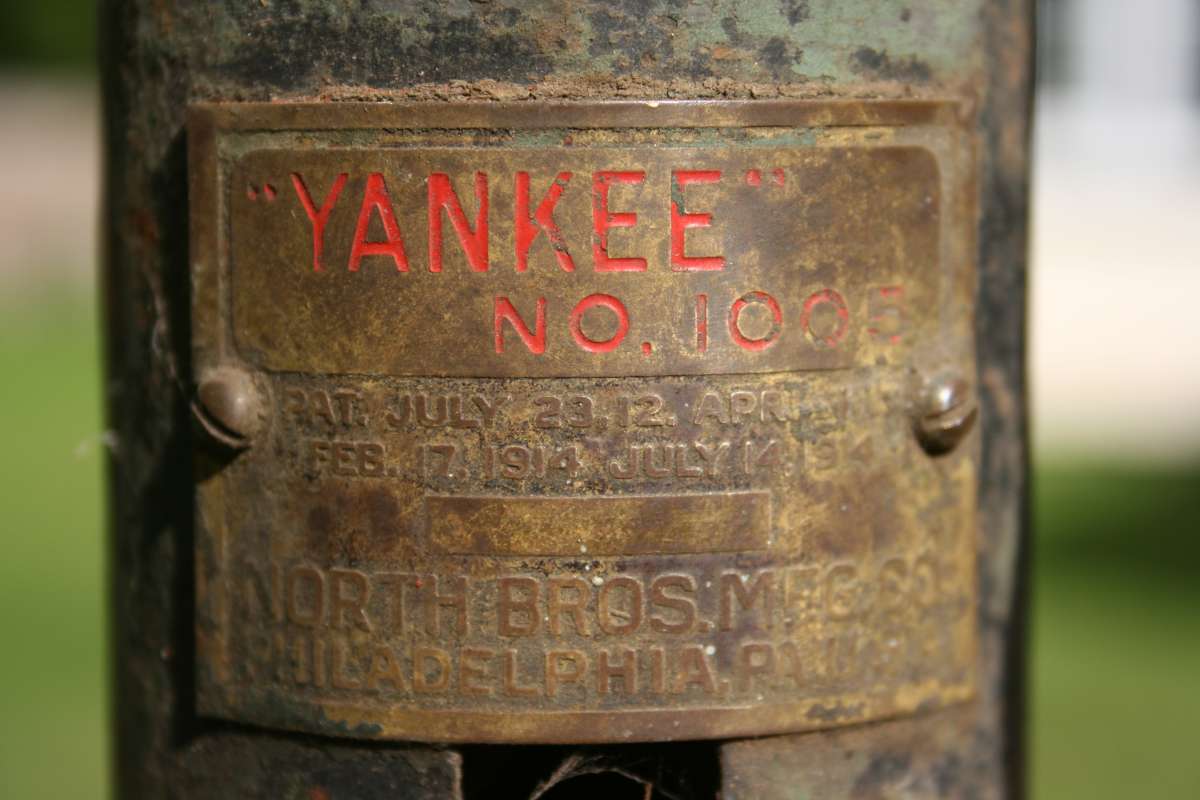

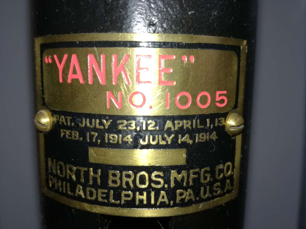

                                      Hi, I’ve never tried those edding paint markers for marking out, but they are good for marking metals. I have used both a red and black 780 (0.8 mm Tip) ones, for repainting the brass plate on my “Yankee” No. 1005 bench drill, the plate being about 55 mm x 38 mm, with very good success. Before and after photos below.
