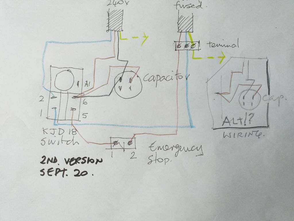

                                        I have uploaded my idea of how to wire a KJD18 switch the use of which was suggested weeks ago and I missed it……..I have been rather slow on the uptake, my apologies. The switch arrived by post the other day.
                                        The live wire going via the NVR is I'm sure correct but on reflection the wires through the switch terminals, ie. for 1 and 5, the connections should be mirrored so 1 would be for the live from the NVR including t 'black connections' from the capacitor. Terminal 2 is connected to A1 so can be live when switched. A1 is a small terminal measuring 2.5mm (others are 6mm). I have not used A1………I don't know what it is for.
                                        I do hope this is correct or 'almost' correct and am happy for all comments please. I can then go and buy a few spade terminals. Thank you.
                                        Marsh
                                        #495036
                                        Les Jones 1
                                          @lesjones1
                                          Hi Marsh,
                                          You still seem to be confused. The KJD18 IS an NVR. (No volt release switch. This is to prevent the saw from starting when the mains is restored after an interruption to the mains supply.) The A1 terminal is one end of the holding (Or maintainer.) coil. This coil is fed from the NVR's output to hold it closed after the start button has been pressed and released. The thing you have labelled "NVR" I think is the item that there is confusion about, (The thing that you called a trip.) (Which we all assumed was a thermal overload to protect the motor but seems to be called a micro switch by DeWalt.) To avoid risking destroying the new NVR if it was the motor that caused the original fault I suggest Connecting the motor directly to the mains with the belt removed from the speed change pulleys and monitoring the current it is taking. This is relying on the 13 amp fuse in the plug to blow if the motor is taking a much higher current than it should. You need to test the second new thing that you called a trip with your meter to see if it behaves like a thermal cut out or a NO micro switch. You also need to show a picture of the diagram on your KJD18 as the connection numbering seems to vary on information I have found online.
                                          Les.

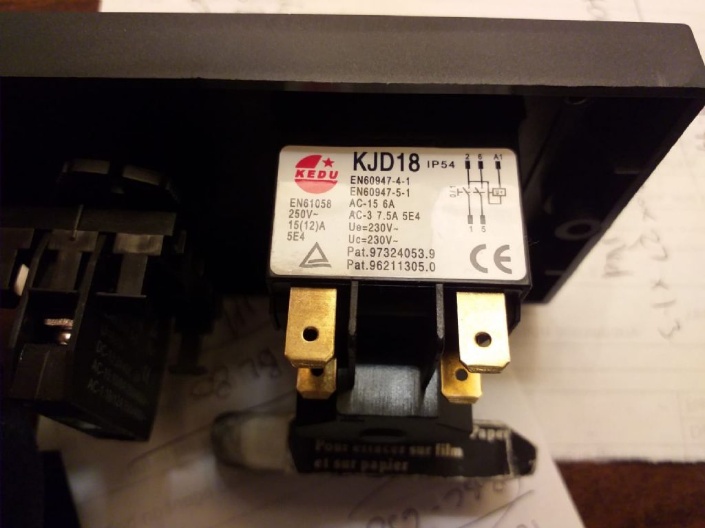

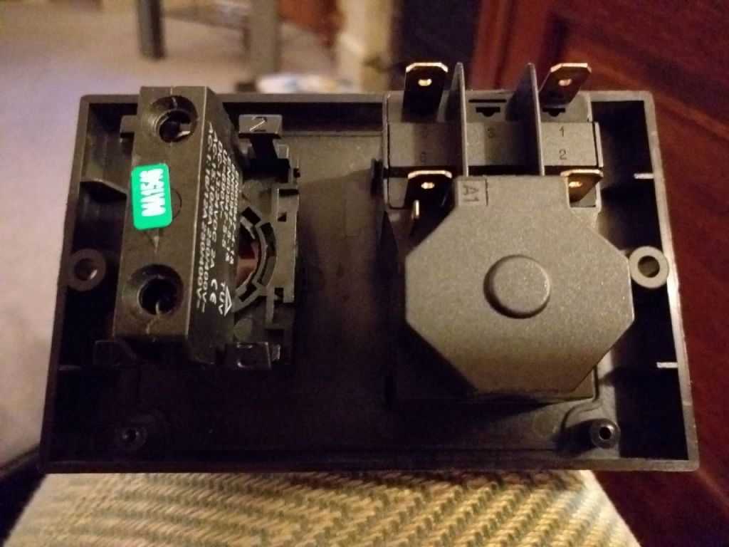

                                            Dear All
                                            My brains went AWOL a few weeks ago but seem to returning albeit slowly this week. They started back slowly and softly at the weekend.
                                            I have at last been able to give more thought to my previous misleading public ideas and include views of the back of the new switch, the diagram on the back, and my idea of wiring the switch taken from you tube and so on. My revised alternative is now shown to the right of the diagram and may actually be alright!
                                            If the switch is too big a capacity at 18 amps I can use it on another more simple higher rated machine with a red and a black wire! Les did suggest a smaller one of 12 amps.(I will double check back at replies/comments). I could just order overnight the smaller one…..just to get it done as my brains return so that I can mount in a suitable way on the machine.
                                            Thank you to everyone after so long a gap. Your thoughts have been such a support.

                                              Again……………..The switch may be 15 amp rating not 18 which is somewhat smaller than I thought. Sorry for the misleading info once again. M
                                              #500347
                                                Posted by Marischal Ellis on 09/10/2020 11:51:25:
                                                The switch isn't 15A either. The markings refer to Utilisation Categories, ie the rating depends on the type of load.
                                                AC15 is an AC electromagnetic load, for which the switch is rated at 6A.
                                                AC3 is a squirrel cage motor load, for which the switch is rated 7.5A
                                                Basically, it's OK for all motors up to about 1400 Watts input, and some types of motor up to about 1700W. Should be OK unless the machine
                                                Les Jones' post of 10/9 still seems valid.

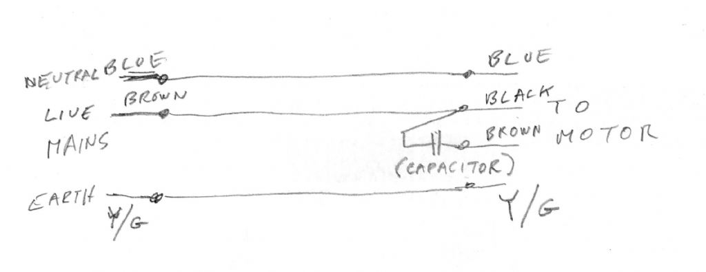

                                                Single phase motors aren't my thing, but I think your circuit must be wrong because both sides of the capacitor are connected to pin 6 on the switch. It doesn't do anything. Also, A1 should be connected to the output side of switch, 6.
                                                Help! Motor expert needed!
                                                #500374
                                                Les Jones 1
                                                  @lesjones1
                                                  I agree with Dave's comments. I am not going to draw a wiring diagram for you until we sort out the function of the thing you called a trip and DeWalt call a micro switch. I suspect that the item to the left of the KJD18 (NVR switch) is a emergency stop button. Can you post a picture of the front of the panel that it is on and also the side of this item so we can read the ratings ? (This is so I can decide between wiring it to break the full load or just the feed to the coil on the NVR switch.) Can you also measure the resistance between the connections second new micro switch both with it pressed and with it not pressed ? Can you also post a picture of where this switch is mounted so we can see if it is some kind of safety interlock ?
                                                  This is how to connect the motor directly to the mains to confirm that it is not drawing a very high current as I suggested in my post on September 10th. (This is to avoid damaging the new NVR switch if the original fault was caused by the motor.)
                                                  Les.

                                                      It looks like the motor is probably OK. Even if your mutlimeter has an AC current range it will probably be 10 amps maximum and the motor will take more than this when starting. This test was to ensure that the motor did not take a VERY large current that could destroy the new NVR switch. As it did not blow the fuse in the plug it is unlikely to damage the new NVR switch. We now just need to establish the exact purpose of the thing that you called a trip and DeWalt call a micro switch. It is a pity that you have disposed of the original item before we could establish if it was a thermal overload trip or just a NO micro switch.
                                                      Les.
