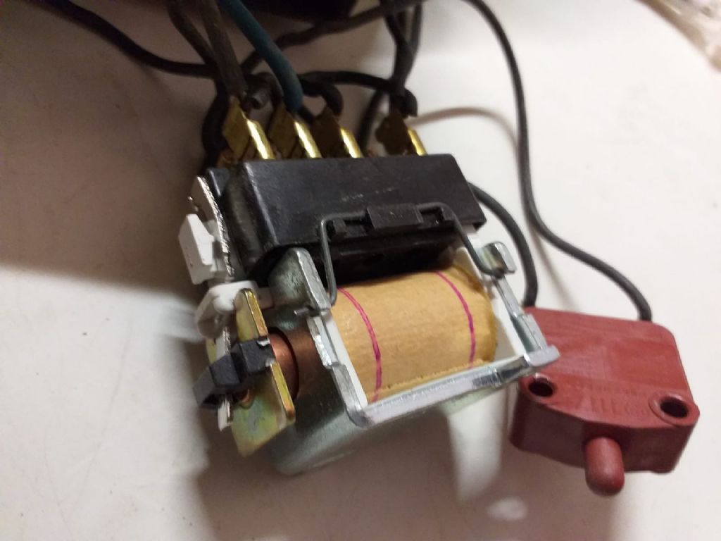

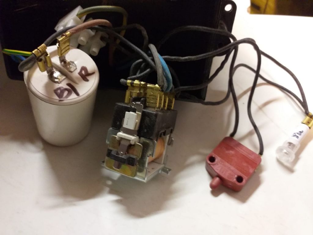

I did a long think through; the trip switch was not working (open or closed?) and bought a new one. I also bought a new neon warning light (white Light) which had never worked. (Possibly a running light). The start capacitor which I commenced the checking with was AOK . Re-assembled switch box but nothing happened. I pressed the trip switch and kept it pressed (open or closed?) to try it and motor started up, so that was OK. The contact switches as a set of four are now no longer available via De Walt and were about £40 + or so, years ago

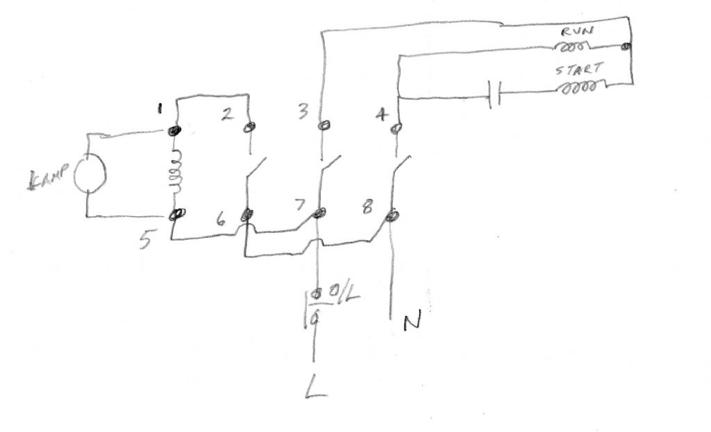

Having fiddled with things, and my mind, I now think that the contacts are bad (jammed open or shut?) but what do I replace them with, as the capacitor is required and 'modern' motors appear to have built-in capacitors which I think cut-out on functioning?
Current Off/On button switches (load is 16 amps) would seem possible but I don't know how a capacitor would be wired in as they appear to rely on cutting off instantly after firing up, so running as I did would not last too long. More correctly it is probably the magnetic coil that is damaged so no control over instant time.

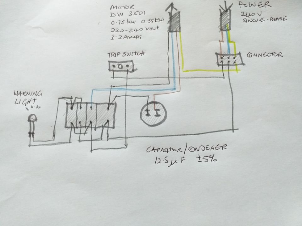

My question is : What can I ,replace my broken contacts and/or switches with. I can add a elect box housing or what ever is need, to house new 'bits'. I have drawn the circuit as I see it and can see why it presently works by keeping my finger on the trip switch.
Your help and advice would be most welcome as it is not my subject. As I grow older there are lots and more of 'not my subject' but that is another story for another day. A way of switching and a means of including a start capacitor would seem to be the way forward if that is correct.
Diagram of circuit.
