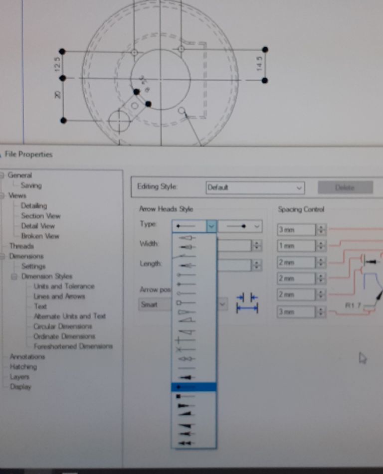

        MEW 313 arrived today. I was somewhat startled to find that on one article the drawings use blobs rather than an arrow.
        Maybe its a new idea, maybe its an old idea, I really don't know. As far as I can see they simply confuse the issue.

          Certainly not a new idea, remember working to architects drawings that were done like that 35odd years ago, and that was from a drawing board rather than just clicking an "arrow" option in your CAD package today. I quite like it actually.

                  Has been around all my 50 odd years in the DO. Ther are many options for the dimension line end connection to the leader, filled arrow, open arrow, slash, dot et al. The one chosen is set by company standard and industry choice, architects very often use the slash, while engineers use the closed arrow. Take you choice but stick to one, although in some circumstances a different form may be used on a drawing where the normal one used is too large for close dimension lines.

                    I have always seen the dots like that in Jason's post on electrical wiring as where wires join. I tend to put what I call a stick arrow a line with a v shape on the end either on the inside of a pair of lines or on the outside if not enough room

                        Personally I prefer no marker at all, although I used to use arrowheads, but the effort involved in editing every blob into an arrowhead makes it impractical for the tiny and questionable benefit.
