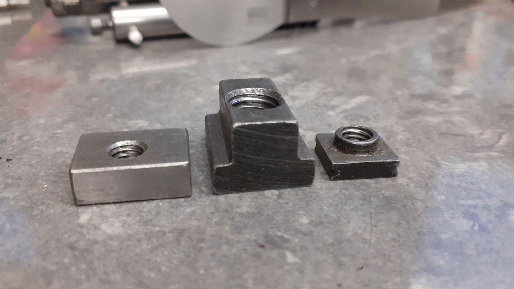

                                                  #576737
                                                    As mentioned earlier if making nuts for undersize studs I don't see much point in making them Tee section.
                                                    Take the photo below, in the middle are the Tee nuts I commonly use on my mill which has 12mm slots and nuts are tapped M10. on the right is an Emco nut for their M6 studs. On the left is the "bit of bar" that I used to make some nuts for use on the larger mill to accept M6, it's thicker than the Emco so less chance of pulling out being 1/4" thick rather than the Emco 5mm overall and a larger contact area than the emco's. Rectangular shape allows me to also use them on the rotary tables' 10mm wide (M8) slots too.
