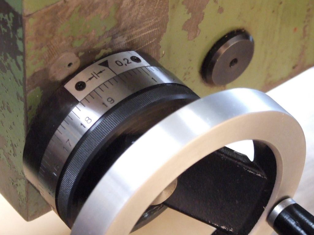

      A product I have used with some success is Curator Antiquing Fluid Black. While it is intended for brass the makers say it will work on steel. I must admit I was sceptical when I first read that, but as you can see from the photograph the finish is respectable.
      Being a cold process it will never compete with commercial hot salts blacking, but for the odd occasional usage the product is hard to better for the price.
      The fluid can be applied neat or the fluid can be diluted 10:1 and the parts immersed for 2 minutes, this is my preferred method. A coat of Shell Enisis after rinsing and drying with an air line is all that is needed.
      De-greasing is the key, and I usually use Isopropanol followed by a hot wash in washing up liquid followed by a hot rinse. Rubber gloves are a must.
      The photograph of the dial was taken 2 years ago and there are no signs of the blacking wearing off. The dials on the "Myford S7 Tailstock Micrometer Dial" thread were done using the same process.

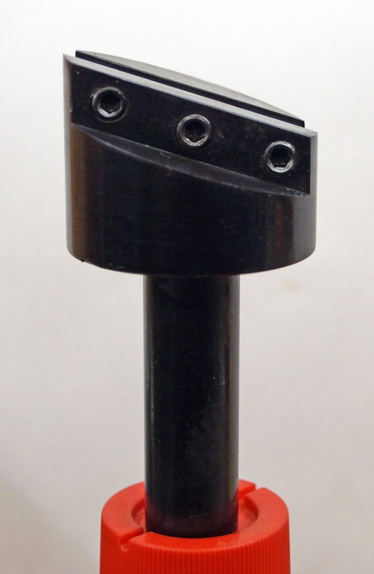

                          I’ve used Gun Blue many times and it works very well on small parts giving a very deep black. I find heating the parts a little and them immersing them in the liquid works best. An oil coating afterwards helps protect the surface. Bigger parts are not so easy unless you can afford to buy a gallon of the liquid (it’s not cheap). What I’ve found is that the surface finish hugely effects the blacking process. I’ve personally found shiny or polished parts are much more difficult to black than sand blasted parts. In fact I seldom seem to black parts these days, I just sand blast them then wipe them over with Microcrytalline Wax. Have a look at the pictures of the tool holder in my album. At least one person thought it was a computer generated image.

                            Posted by Vic on 14/12/2018 16:51:42:
                            … Have a look at the pictures of the tool holder in my album. At least one person thought it was a computer generated image.
                            Hands up … It was me blush
                            … and I remain astonished by its loveliness !!

                            Vic
                              @vic
                              You weren’t the only one Michael, several others on another forum thought it was a computer generated image.
