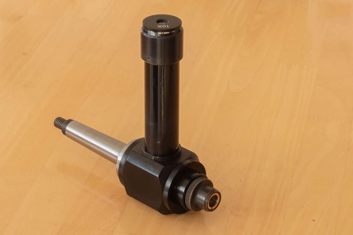

            Roderick Jenkins
              @roderickjenkins93242
              I used the Gateros dye from ebay on my Hemingway centring microscope :
              https://www.ebay.co.uk/itm/256310372822
              Comes as a powder to be dissolved in water.
              Gave a good solid black (the objective lens holder is chemically blackened brass, not anodised ally)
              a centring microscope
              Rod
