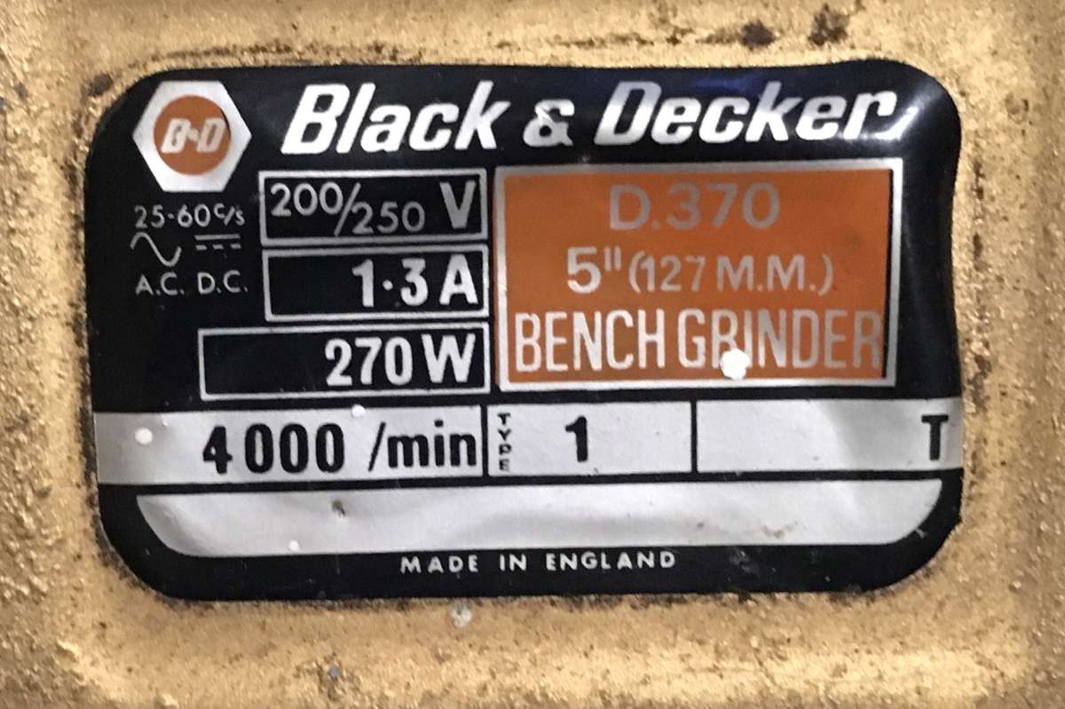

      We all know [don’t we?] that Bench Grinders should use induction motors.
      It therefore came as some surprise to find this:
      IMG_0232
      YouTube to the rescue:
      https://youtu.be/eAvto4zk6JM?feature=shared
      I don’t think I will be asking him to service mine [!] but the first few minutes show Black & Decker’s very interesting design.

        A universal AC/DC motor at 4000 rpm. Noel.
        #761508
        Ian P
          @ianp
          4000rpm is after the reduction gearing.
