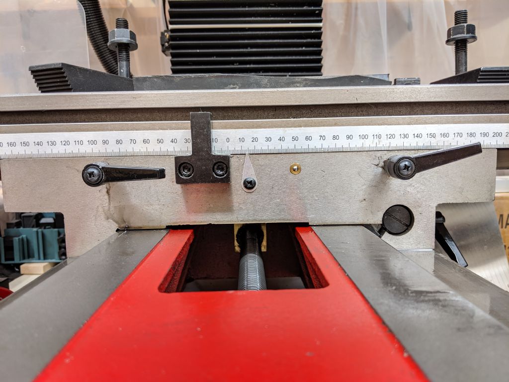

      I was just wondering if anyone could shed any light on a problem I’d been having on my SX4 please? I’ve only used it for about 30-40 hours since I bought it last year and Id like to try and get cutting again soon but I’d really like to remedy this first as it made using the machine harder than I think it should have been.
      What I was finding is that if I locked off the cross axis (the X axis that runs left to right as you’re stood looking at the front of the machine) then the Y axis (in and out) would become really quite stiff to move with the handle -needing two hands over longer cuts.
      I couldn’t figure out for the life of me how locking one axis would cause binding on another. I’d be grateful for any advice.

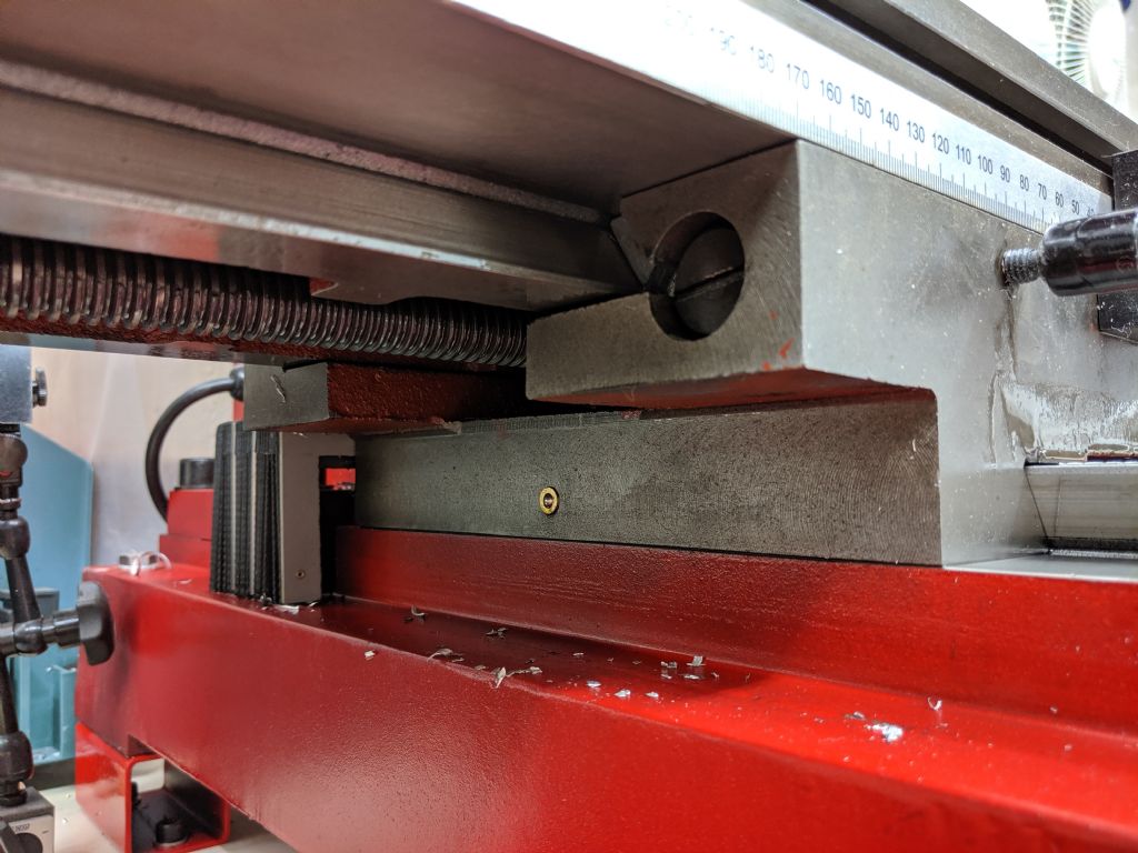

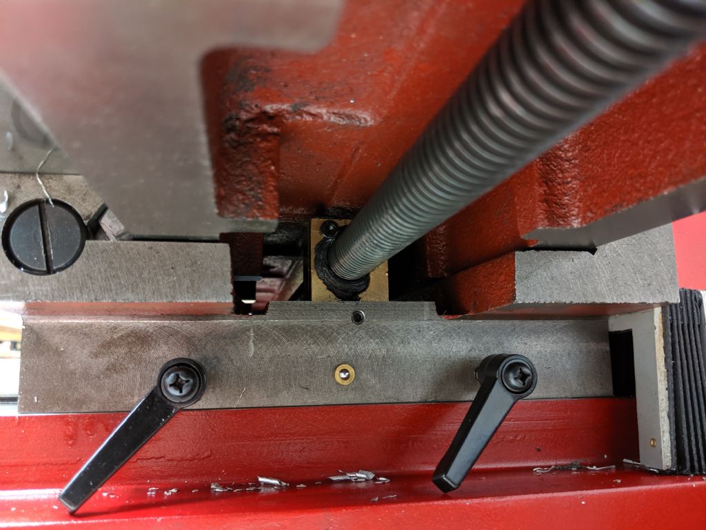

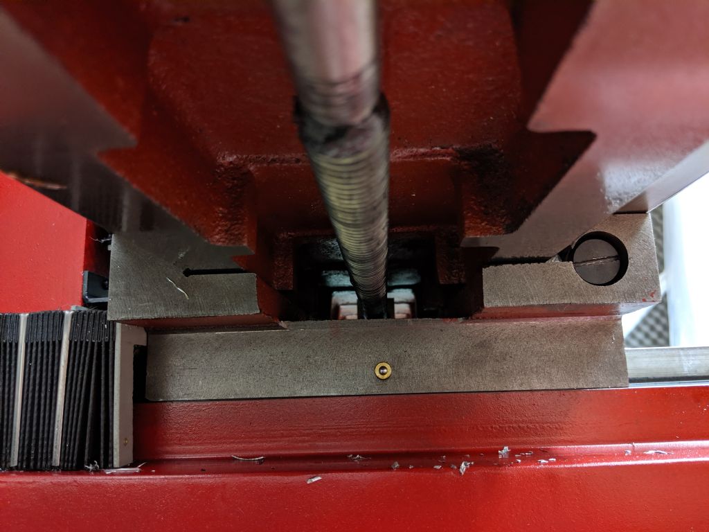

                          I've been and had another 15 minutes winding the table in and out.
                          One thing that might be worth mentioning is that there's a gradual darkening to the oil I'm applying to the machine – I wonder if the saddle is flexing and effectively re-scraping the ways? Over time this might result in an easing of moving the axis (the saddle must get to a deflection and not go any further I'd imagine, surely?).
                          That's assuming there isn't a crack like Mike said – but I can't see one. I've uploaded some pictures in case anyone else can see anything from them (Russ – does this look like a thicker or thinner saddle to you?)
                          Wasn't sure whether a link to the album or the individual photos is best practice so I've included both:
                          **LINK**
                          Saddle - front showing locks

                                      Barrie, the slotted screw is one of the two push/pull screws on each axis to adjust the tapered gibs
                                      There does not look to be a lot of oil on those ways, left hand of the Y axis does not seem to have much and undersides of the two X ways don't either, certainly no sighs of excess oil having run down the casting. Also what oil are you using?
