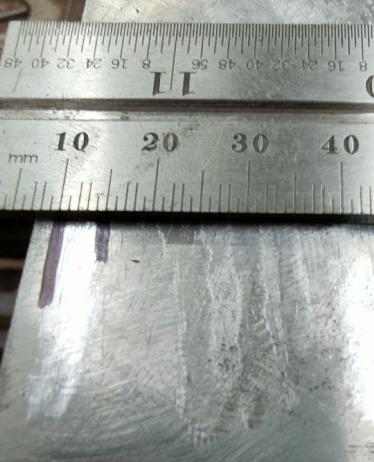

            I thought I'd try making one as a small holiday project. I bought the cheapest reciprocating saw from screwfix (titan) and put a new pin in centred on the diameter of the shaft which then gives 10mm stroke. Would be really easy to do next time now I know…The original pin is pressed in so it might even be possible to press the pin back out and the conversion is then reversible. Now to attach the scraper…

              On a Biax the blade does not point forward in the direction of reciprocation, it's angled down at some 15-20 degrees. I can measure it of you like. There is also a rubber wedge block under the blade to give it some cushion.
              You'll find that 10mm is quite a long stroke. It will do for roughing but you'll want it much shorter for finishing work.

                      So I think the main conclusion is, I don't know what I'm doing with a power scraper. I guess it's good I didn't splash out on a Bax! I'm not sure it is any faster.
                      Here is a vid taken one handed (I hold phone with other).
                      They are used for scraping things flat. The final fit on machine tools. Scraping doesn't take much material off!

                        Jack I watched your video. First off your blade is blunt. If you push it gently across your thumbnail and it doesn't easliy shave a thin layer of nail, it's not sharp. Your stroke is OK for roughing but not anything finer. Your blade could do with being somewhat shorter for better control and with a bit more spring, it looks a bit on the stiff side. And you could do with a bit more radius on the end.

                          Thanks for the tips – the blade doesn't last long if you fall off the edge and then hammer drill it square against metal! This happend a few times while one handed scraping and holding the phone. A rough grind really made a difference. The blade profile is as new, but I agree more radius on end is needed for my skills and this much brute power.
                          I will shorten by 1/3 I think. The scraper is a sandvik and the material is really hard and inflexible. And difficult to drill…
                          I might halve the stroke, but I'll play with this for a bit.
                          The thing is prone to leaving cutter marks perpendicular to the stroke. I think when adjusting the cutting angle there is a fine line between too shallow and no cut, and too steep and plough lines.

                            Cutter lines perpendicular to the stroke are chatter. See Pete's comments about sharpening the blade. A cast iron disk turned smooth and flat on the lathe, with diamond paste pressed into it with a ball bearing makes a good lapping fixture. Use 5µm diamond maximum for sharpening. Make a rectanglar or square bar with the top sloping down by 3° towards the plate to support the blade and give you a consistent angle. You want a mirror finish, if possible, and no visible transition between the front and the bottom faces. The Sandvik inserts have far too large a radius for power scraping, which makes control harder.

                              Modified to 5mm stroke and fettled the scraper. Much nicer to use. Another poor video of the scraper in use with one hand only,  and then a shot of one of the passes for size

                                Looks a lot better now. Turn your speed right down Jack and use more weight if the machine will stand for it. You want a gap between the scrapes equal to the width of the scrape at least, and the same for the ends if you hope to achieve a points pattern. Only when roughing a lot of material down do you want the scrapes joined up, if you do that when trying to achieve a flat plane you'll just keep moving the contact points about the place without achieving your goal.
                                Switch directions every pass to cross the scrapes across each other and stop you ploughing furrows.
