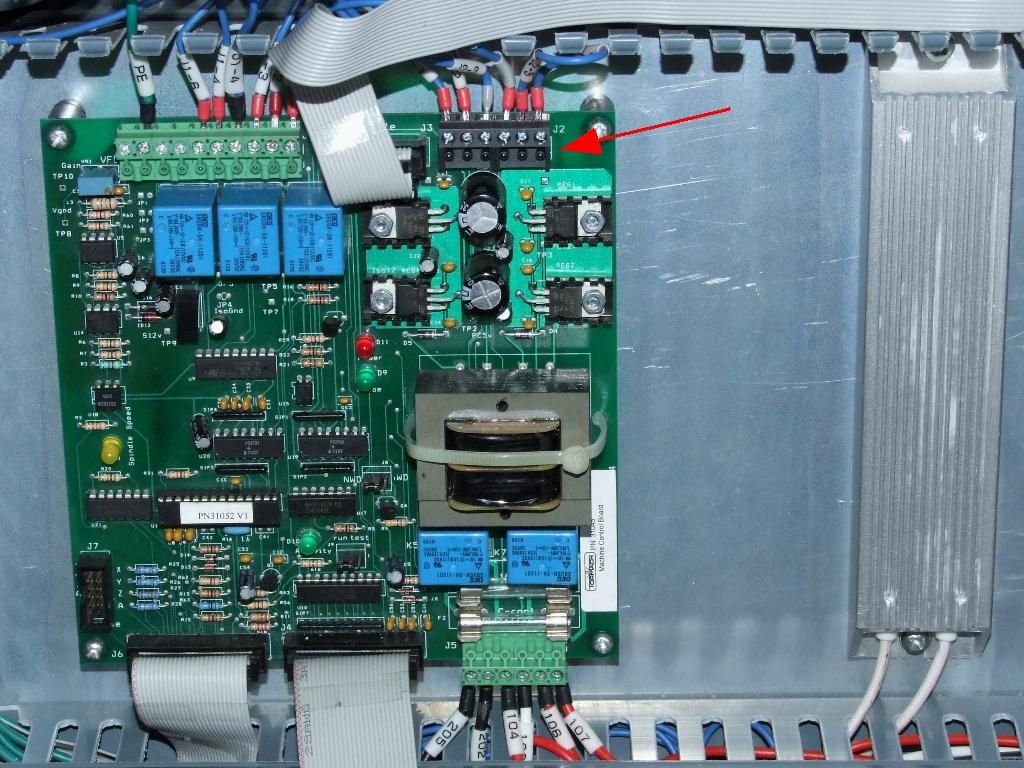

                  Quite so. One of the issues I had with my Tormach CNC mill was an intermittent spindle run problem. I eventually traced it to an 'industrial' push on connector on the control board. The exact same connector, but from a reputable industrial manufacturer, was available from Farnell. I've had no issues since changing the connector. The original connector mated with barely any force needed. The replacement connector needed a significant push to mate.

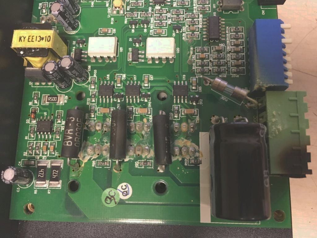

                    it was only last week I read a post on CNCZONE about the same problem with a   Leadshine  3ND883  three  phase stepper driver used on a Tormach CNC machine !!
                    the connectors are used on a large number of drivers from a variety of manufactures

                      The green connector at bottom right is a five-pole version of the 4-pole one on a RAMPS.
                      By any chance is that the one that gives trouble?
                      #301474
                      john swift 1
                        @johnswift1
                        Hi Neil
                        yes that's the one in the CNCZONE post that's burnt – not mine I'm glad to say !
                        going by the Leadshine manual its W phase that drives the stepper motor
                        the same connector is used on some of the infamous TB6560 stepper drivers

                              The problem I had was with a connector on the Tormach custom control board, the green connector bottom right:
                              Although not obvious the PCB part is a header with round pins. The mating half, with the wires, slides over the pins. The circuits are all low current. The problem was poor contact, rather than related heating, due to low insertion force and possibly poor spring contact design.
                              Changing both halves solved the problem. I also changed the similar connector top left, just to be safe.

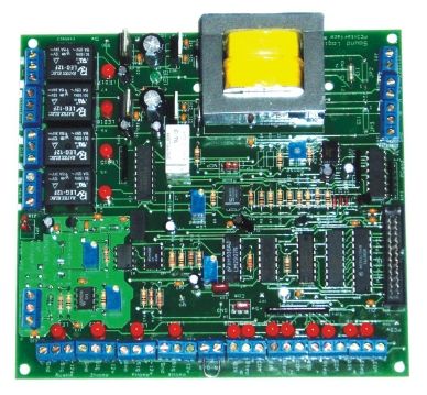

                                the connectors look like the ones used by Gecko Drive on their stepper drivers (G540 for example)
                                and your control board looks like its a version of the boards from Campbell designs / Sound Logic Combo Board
                                http://www.campbelldesigns.com/Combo-board.php

                                      These are the same type of connector that leadshine have been fitting for years. When I was over in China at the Sieg CNC factory which has nothing to do with the manual machine factory, I noticed they used a gun,similar to a cheap cable splicer that fitted over the pins and gave the pin a toggle making it a harder push fit.
                                      We obtained one when over there or rather they got us one as they must be a commercial unit but not seen them anywhere else.
                                      Result being that when we do rebuilds or new conversions we have never had a problem.
                                      John Swift, I can positively say that the Tormach board is a dedicated board, designed in China and produced exclusively for Tormach.
                                      This board came about as the mill needs encoder input for rigid tapping and the lathe requires similar for threading.
                                      Non of the Western boards at that time could offer this and presently only the Pokeys57CNC can do this but only with Mach4 which after 6 years is still a work in progress.
