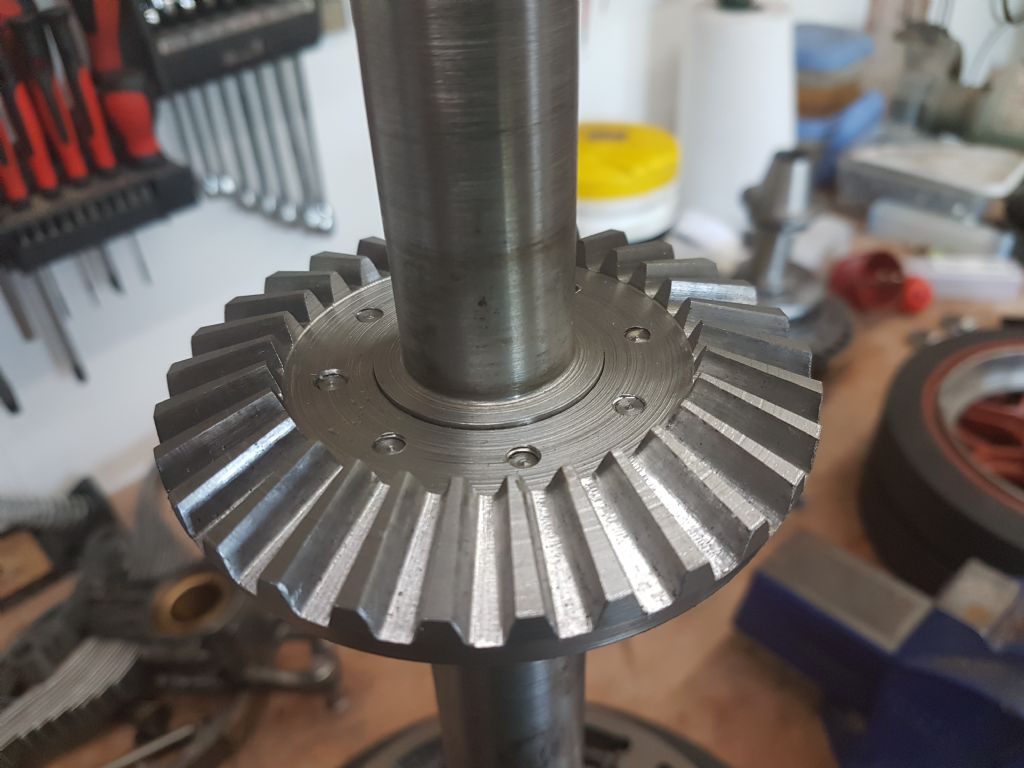

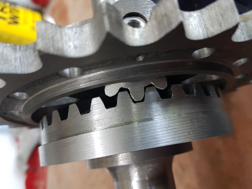

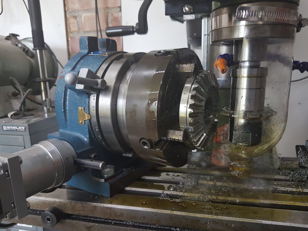

                    Just to provide results, I cut the crown wheels using a No.2 cutter and the pinions with a No.8, the depth was 0.180", the offset for the 2nd & 3rd cuts was 0.0625", the end results seem to work.
                    During the cutting I did have an issue with a crown wheel that meant I had to start again, I think the job moved on the table, so I made an adapter to hold my 4-jaw on the rotary table, this seemed far better. The attached photo shows this, along with use of an old drinks bottle held in place with a jubilee clip to contain the coolant.
