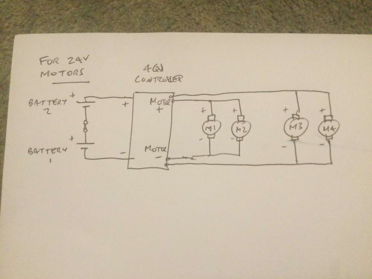

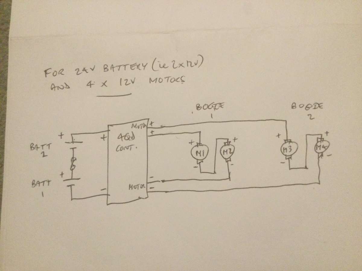

        It depends on the battery and motor voltage.
        If they are all 12v or 24v wire them in parallel.
        If you have 2 xx 12v batteries, you can wire the batteries in series to give 24v into the controller.
        If your motors are 12v, wire the 2 on each bogie in series and then the wires from each bogie in parallel.
        Make sure you set the link in the controller to the correct battery voltage.
        Stuart
        5CDC93C4-0DF6-4336-9C6F-20FBA4A984FF
        A4C267F5-68B0-42A4-ACC7-39DEEE05B7EC
        #786213
        Stuart Smith 5
          @stuartsmith5
          E72F164E-C4B1-4A57-AD53-B77FB90566EB

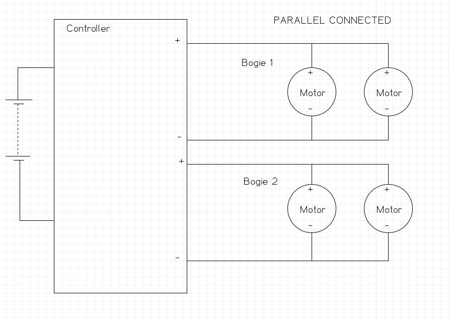

              This is the parallel circuit.
              parallelmotors
              I’m wondering if there’s more to Michael’s question than series vs parallel?   Stuart and I both provide circuits that omit practical details, like suppression capacitors and twisting the wires together.   Also, my circuit implies the motors are connected to a bus, when it’s more likely the circuit would be implemented by wiring each motor separately back to the controller.
