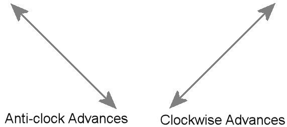

                                      The problem is that although most mills move consistently across all three handwheels, there are certainly exceptions, often the Z axis.
                                      So to be on the safe side first try all the axes and see if they move in the same sense.
                                      If so, make one sign, if not, make three…
