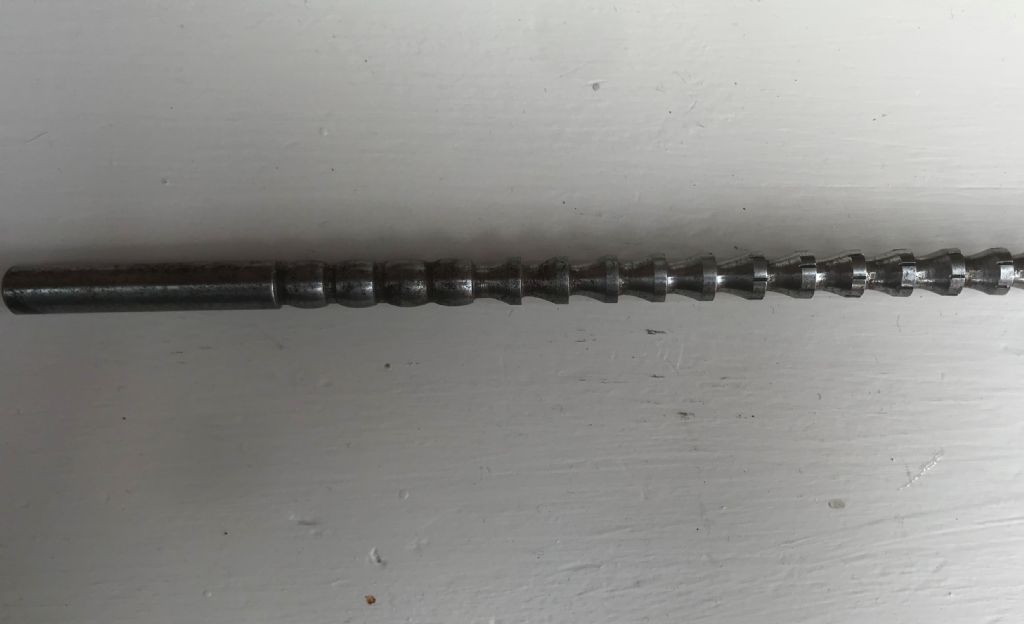

      This winter I intend to do a top-end rebuild on an old industrial petrol engine. The bronze valve guides are 4.45mm bore and 42m long overall. The problem I've previously had on small guides was getting the bore concentric. I've had to resort to finishing the bore but leaving the guide oversized, then mounting the guide between centres to finish turn.
      I saw small guides being commercially CNC machined and the outside was finished first, then just drilled (using a solid carbide drill), reamed and parted off. I've been unable to drill through this length accurately enough, though I was using HSS drills. The drill always wanders and subsequent finishing follows the original bore
      What's the best technique/procedure to use?

              Mick,
              Why not 'gun drill' the bores with a single lip cutter made from drill stock? Guaranteed size and roundness as well as concentric.
              I think this has been covered before, but more to do with automotive size valve guides, in that thread I replied the production method I most favoured was the broached finish with 'ballising'
              Here is the picture I posted from that thread of the Triumph Meriden tool used for producing the PB guides in their engines:-
              Martin

                I'd consider making a silver steel D-bit to your final diameter. After pilot drilling undersize,this can be started accurately centred in the job and should cut true, correcting any minor wandering of the pilot hole.

                        I reference the seat off the guide bore but like to achieve a concentric guide to minimise material removal from the seat. My valve refacer finishes the valve head to within 0.01mm concentricity to the stem and I like guides to have no more runout than this. This makes for a seat that only needs a light dressing to restore the angles and seat width and no need to grind in the valves.
                        My ML7 has a lever tailstock feed, which makes for rapid and frequent pecking to clear chips, but even with premium, new drills the hole will wander slightly with smaller holes. Last winter I checked my lathe alignment as I had a batch of guides to make in a larger size (6.98mm bore) and these turned out perfectly. I was able to use a solid carbide boring tool and then finish ream with a LH spiral carbide reamer and machine the outside and bore without removing the guide from the chuck for the main finishing. They only needed re-chucking to machine the oil seal register. I'll try different techniques and take a look at 'gun drilling' and D-bit finishing – I'd like to improve my methods of drilling deeper, small diameter holes accurately.
