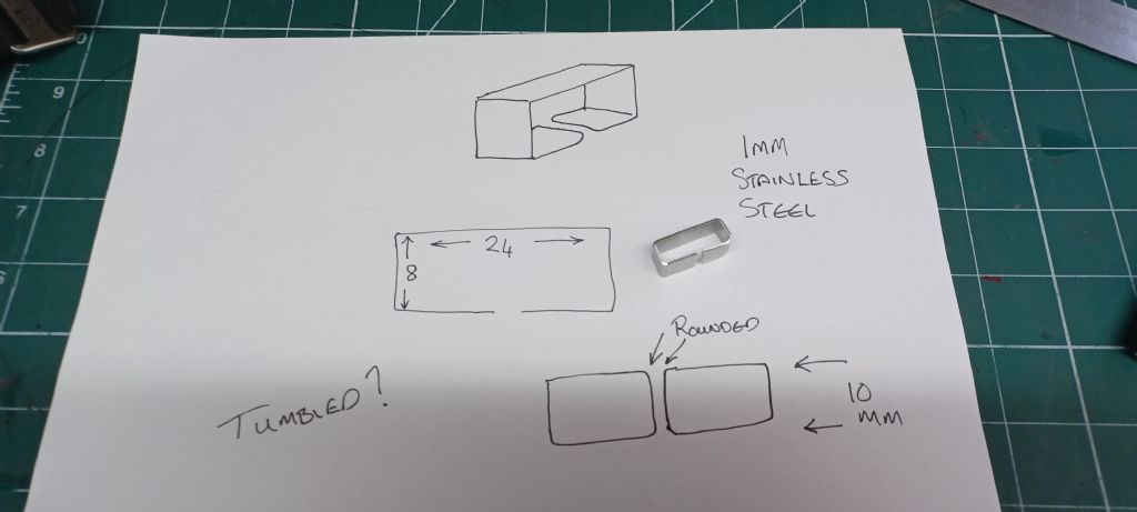

As Jason shows simple pressing works pretty well for curves and shallower bends in less stiff materials such as alloy, mild steel, copper and softer brasses. Hard brass tends to crack when you are least expecting it.
Not so easy with stainless steel which has serious spring back issues. Less of a problem with shallower bends and curves but you still need to allow for it. Found that out the hard way when I tested tooling somewhat similar to Jasons second picture with some ordinary steel rod before switching to (expensive) stainless for the real thing. Had to tighten up all the bends by hand afterwards.
Sharp bends can be a nightmare. Even the professionals often resort to experimentation. Even when you have got things sorted stainless also has a nasty habit of changing its mind on you half way through the job needing "some adjustment" for the last 50!

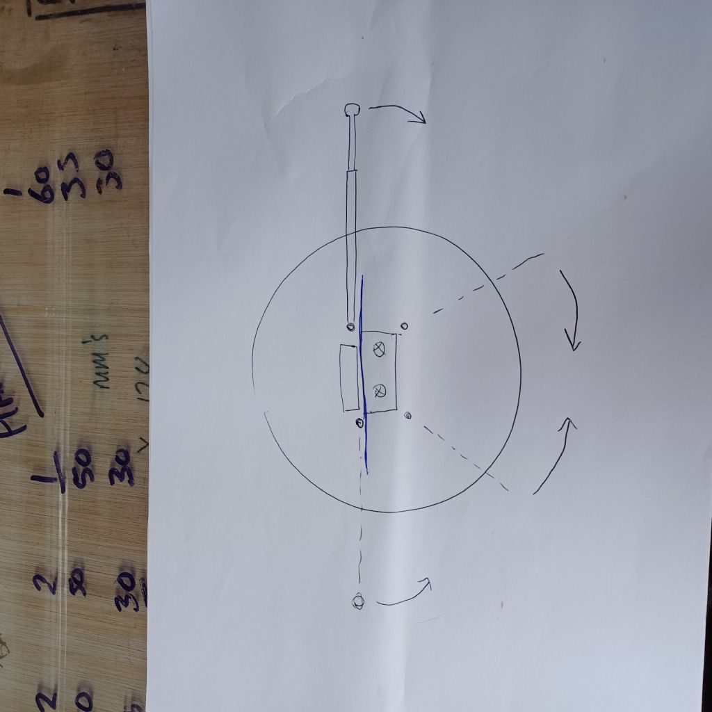

If pressing you are probably best off making each bend individually with a relatively thin forcing blade having a suitable radius tip working into an open ended Vee former. Nice radius on the sides of the opening too so the bent material can push through without marking so it over bends enough to cancel the spring back. Not the fastest way of working but once sorted with suitable end stops to define push distance its effective.
Ordinary hand lever bench press will do just fine in your size.
For obvious geometrical reasons the Vee former has to move rather than the blade so its all a bit inside out. Sort of thing that can seriously mess with your head if you don't think it through carefully. Who once made a bending tooling set up that worked just fine except for extracting the finished job! Yup. Moi. Ooopsi, red faced variety.
Hard bit is devising a set up that aligns the stock material correctly so the bends are in the right place and the thing doesn't come out twisted. Radius end on the pusher means you can't align on a scribed line as you do when using the magnetically held "Vee and sharp pusher" devices in a vice. Very effective on the right jobs. So glad I bought mine. Even with those it can be hard not to end up with a twist in the bend. Like what I've been known to do!
If you had enough to do to make serious tooling up be worth the effort it might make sense to refine a basic inside block former by adding lever operated rollers to form each corner from the outside to work quickly and accurately. Not as easy as it sounds because the lever and roller assembly has to be made so that it can be taken off to remove the finished part. Forked end and pull the spindle I guess.
