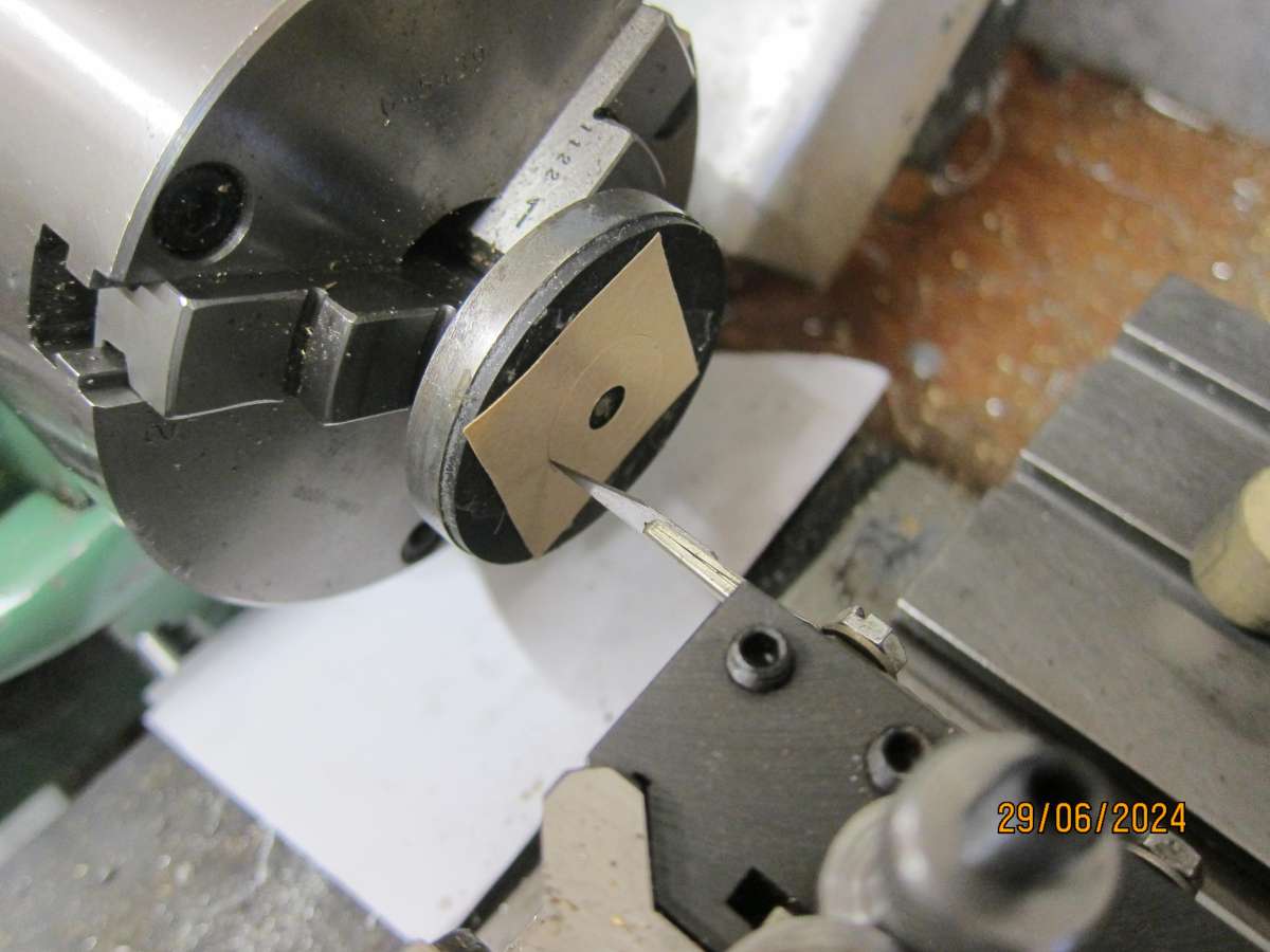

      I would be interested to receive some ideas on the best way to make thin paper seals having a concentric hole for use with miniature steam fittings. In the past I have used an inverted scalpel blade mounted in the tool post with typically a brown paper blank held on a rubber clad face plate using double sided tape. This has the advantage that it is possible to cut a concentric hole for the passage of steam in a neatly cut seal with any radial fixing holes being put in with a suitable punch and guide as a second operation. Cutting Paper SealsI have had some success with this method but I would be very open to hearing the views of others and trying out different techniques.

        I think that any system that works for you is ok as making special tools/punches for low volume amounts is just not worth it but wonder why you use brown paper instead of gasket paper as it is a completely different beast performance wise.

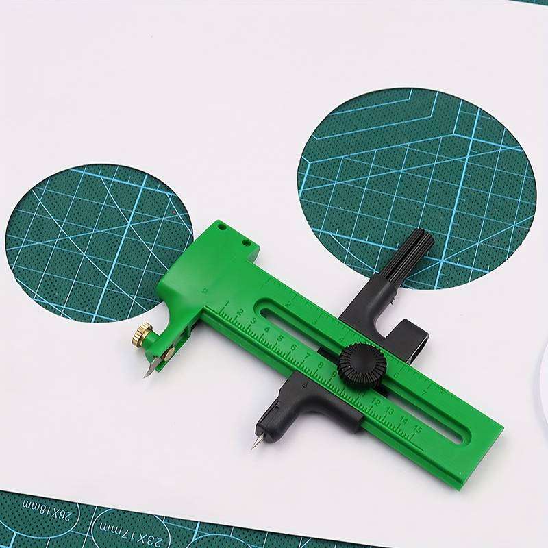

                    This sort of thing works well
