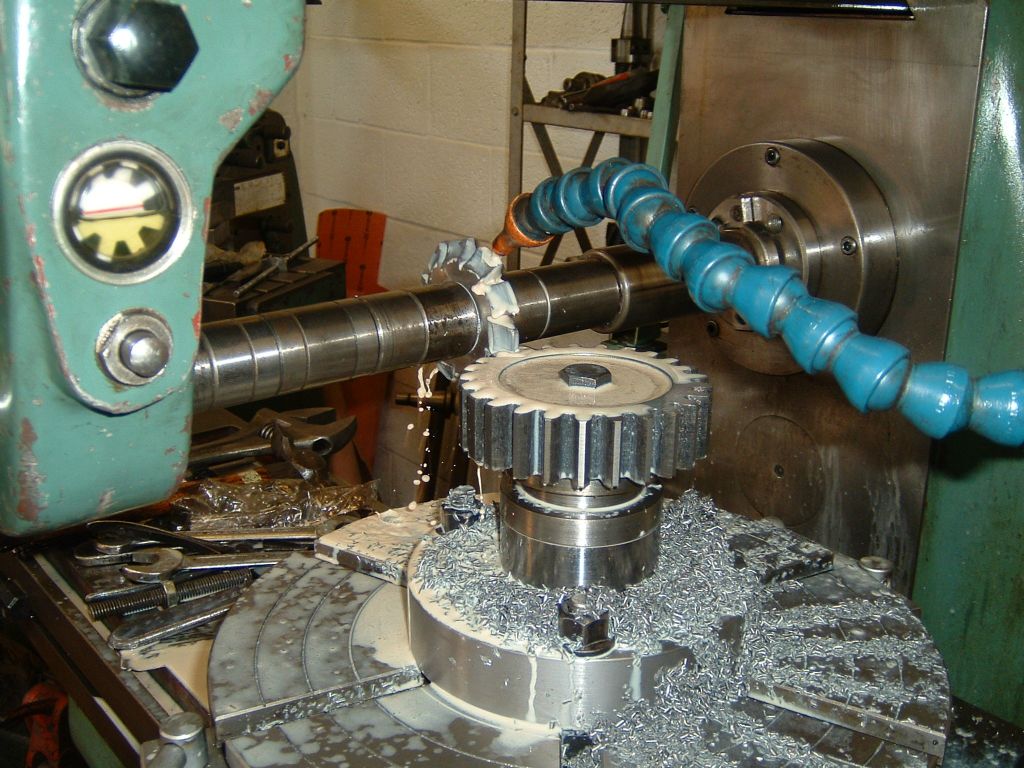

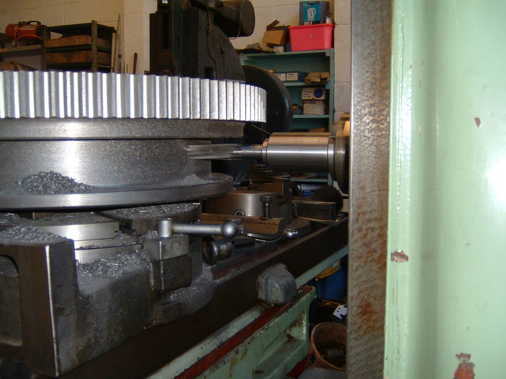

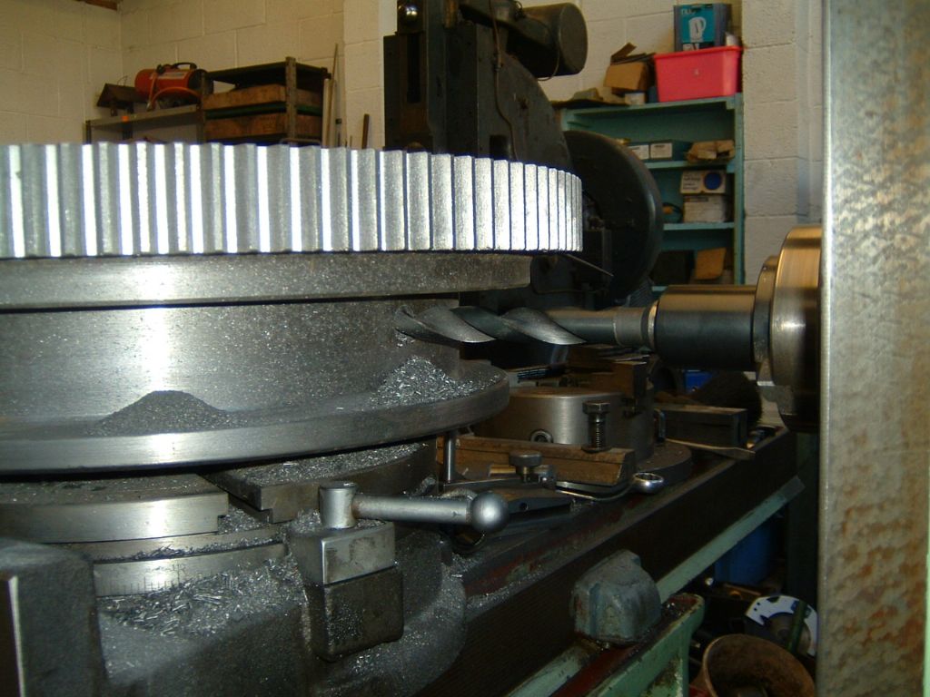

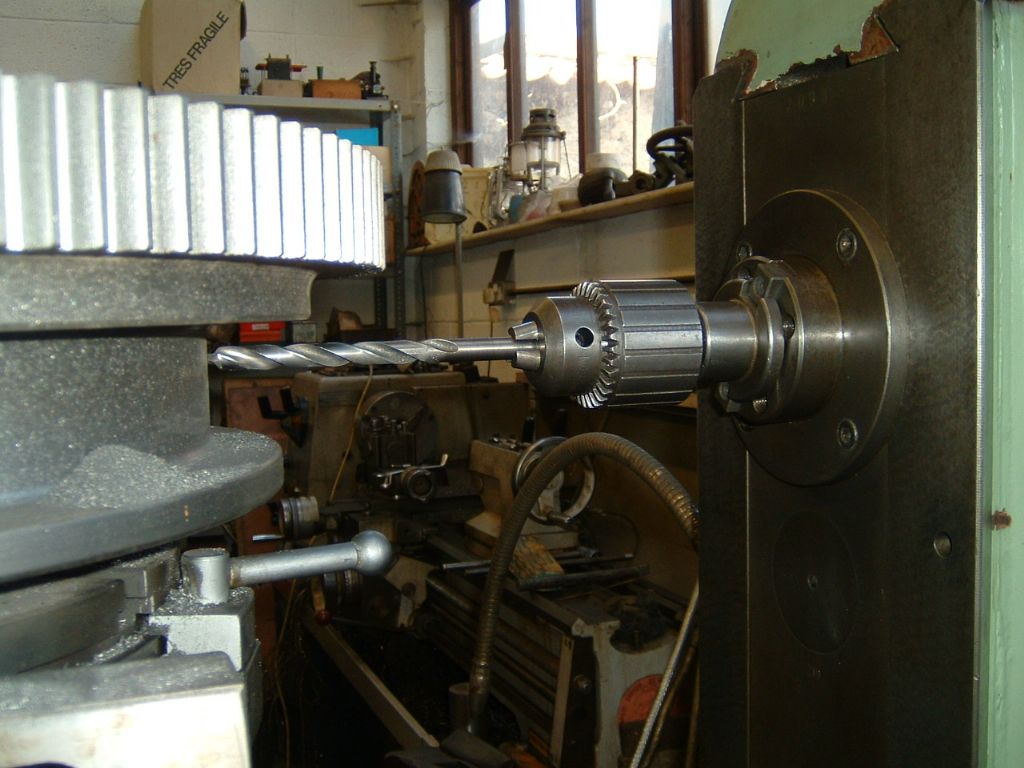

                                  Here's another use for a horizontal mill, horizontal drilling and reaming of a large casting which is too big to get in a drilling machine,
                                  Also using the same mill to cut the gear.

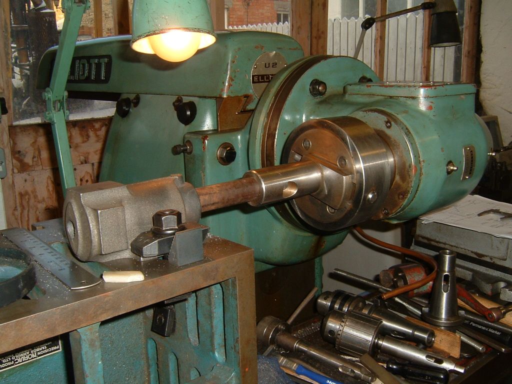

                                  I've also got an Elliott U2 universal mill with a swivelling table, A lovely machine but I've never needed to use the swivel table,
                                  Richard.

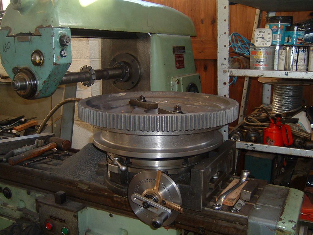

                                      The mill in the pictures is a TOS FA3A, I bought it to do some of this traction engine stuff, as it's the next size up from the Elliott U2, and has quite a bit more table travel, and rapids as well , ( excellent for gear cutting, saves a lot of hand winding when returning the table for the next gear tooth )
                                      Here is a picture of the Elliott U2 ( same as a Victoria ), it shows the versatility of the swivelling vertical head when used for horizontal boring, also a picture of the U2 doing some gearcutting.

                                        Yes, I can see the family resemblance Richard.
                                        I've not used the vertical head turned through 90 degrees like that ( I don't have a large box-angle plate for a start) and was wondering why I'd want to do it (instead of between centres in the lathe for instance) but then I noticed the piece you are working on looks to be effectively a 'blind' bore.
                                        But thinking further about it (even if I could set it up on the Super 7 for between centre boring) I guess I'd still have to pack the work up to correct height and also I doubt it would be quite as rigid (My S7 is also pretty ancient).
                                        So I guess the reasoning is – easy height adjustment using the knee, power feed and a very solid set-up?
                                        Regards,
                                        Ian

                                            PS But your photo does raise even more interesting questions John S – It looks like it's all driven by some kind of CNC or perhaps some kind of electronic interlock (rather than a direct geared connection) ?
