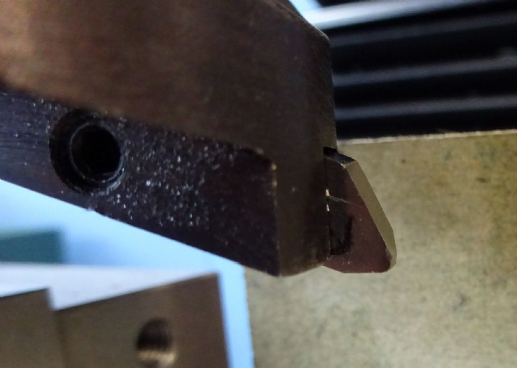

                                          #371850
                                          Ian S C
                                            @iansc
                                            If you go looking through scrap bin for unknown steel, it's handy to have a small file with you to test if the metal will at least cut on the lathe, no use getting home with a great looking lump of steel that is just about hard enough to make lathe tools! Early in my days on the lathe I did make a few things using old car axles, such as this tool holder, turned on the bottom and sides with the bar across the jaws of the 3 jaw lathe chuck, and the area where the tool fits milled in the vertical milling machine.
                                            Ian S C
                                            Edited By Ian S C on 15/09/2018 14:06:09
                                            Edited By Ian S C on 15/09/2018 14:07:23
                                            #371851
                                              I had the same issue with a bit of 1/2 x 1 EN3 the other day took the edge straight off a brand spanking new 10mm sq HSS with 8% cobalt flycutter bit I had been sent to try out and when I say took the edge off I mean turning it into a round nosed tool not just dulling the edge. 1/4" further along the steel cut perfectly well. I have had it happen about 3 times now and am sure it is the material not the tool bit, machine or methods.
                                              This tool did gave a 90deg corner
