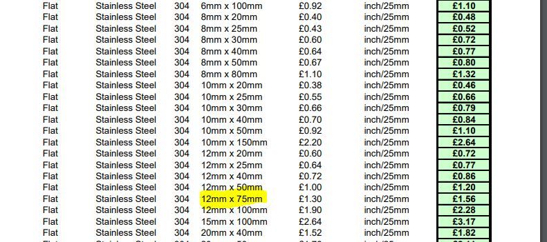

          I am confused by the metal description. 75 x 80 x12 mm BAR?
          #613050
            Does it need facing, Plenty of flat and round bar used as is and finished with a "brushed stainless" look straight onto the mill surface which sounds like to look the OP is after
            It's certainly the way most architectural stainless fabrications are done such as handrails, brackets, furniture, etc.

                303 stainless is the best/easiest to machine, doesn't work/heat harden easily. 304 is a pain the only real advantage it has is weldability which you don't need.
                #613074
                  Posted by old mart on 11/09/2022 15:43:05:
                  As I said earlier 75 x 12 is a stock size flat bar in stainless, cut to 80mm long
                  303 is easier to come by in round bar rather than flat bar or plate so also as mentioned earlier get a piece cut to say 15mm long from 3" (76mm) dia round bar and you will have enough metal to machine to the exact size of 75mm dia x 12mm thick. Someone like M-machine will be able to supply that.

                        Plate is flat like a wall, and bar is cylindrical like a tree trunk.

                            Posted by old mart on 12/09/2022 14:26:23:
                            According to Google many suppliers use the term "bar" to mean a flat fairly narrow strip. Anyway, that's what I meant.
                            Thanks – Rowan
                                  So what do you call a length of rectanglular section?
                                  Most people would use "flat bar" or "#x# bar" or just "flat" and would not call it plate
