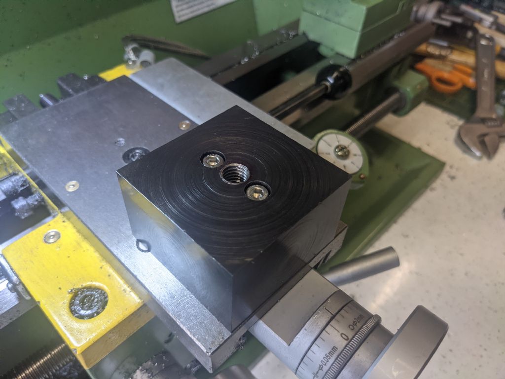

      Good afternoon all,
      I am toying with the idea of removing the taper slide on my lathe and replacing it with a solid block to mount the tool post too.
      There are a couple of reason for this, partly to improve rigidity (particularly as I don't think I will often use the taper attachment), but mainly to aid in the replacement of the 4 way toolpost for a QCTP.
      I was thinking of using mild steel for this, but it occurred to me that maybe I could get away with using aluminium, or maybe I should be using something tougher like stainless.
      What are peoples opinons on this?
      Thanks,
      B

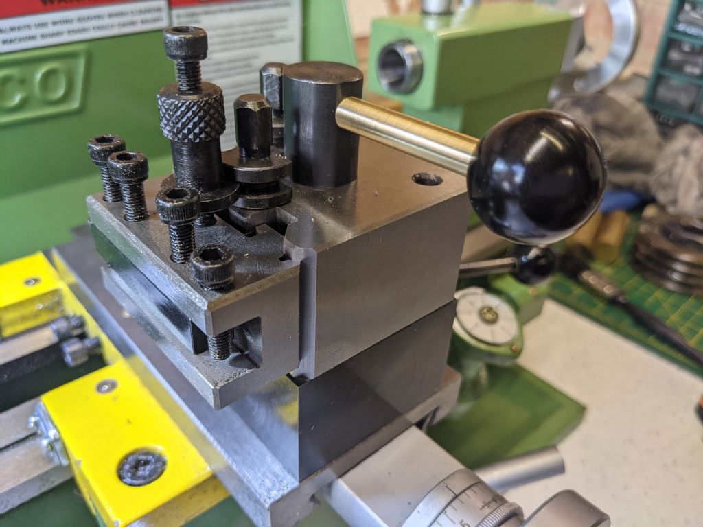

                    old mart
                      @oldmart
                      _igp2771.jpgI happened to get hold of a NOS 4 way toolpost which is bigger than the standard size for the lathe (Smart & Brown model A), and I decided to use it mounted on the cross slide at the same height as the other ones for the lathe. Because it is bigger, 25mm boring bars can be fitted and their increased rigidity plus the rigidity of leaving out the top slide would be an advantage. To partially make up for the loss of being able to make fine adjustments on the top slide, it helps to have an adjustable saddle stop and a box of slip gauges. The block of cast iron which the toolpost sits on helps somewhat with damping, but mild steel would work ok too. That boring bar in the picture is a 16mm with carbide shank which could enter a 20mm hole and bore 96mm deep.
                      Edited By old mart on 10/06/2021 20:08:25

                      Robert Bowen-Cattry
                        @robertbowen-cattry70600
                        Thanks for the replies gents.
                        To clarify, I'm not getting rid of the top slide, it will be kept and stored when not in use. The main reason for my plan is to allow easier fitment of the QCTP. The Warco WM180 has a raised boss on the top of the cross slide which would either have to be removed, or the QCTP bored out to accommodate it.
                        Not iishing to modify either part this seemed like the best option, with the added bonus of improving rigidity.
                        The top slide can always be reinstated with the 4 way tool post as and when needed, its only two bolts. .

                                    Robert Bowen-Cattry
                                      Thanks for all the advice guys, the project is now complete and I have my QCTP fitted.
                                      The box that the QCTP came in is also perfect for storing the original tool post and slide when not in use (with a little modification to the foam) so that is now safely stored until needed.
