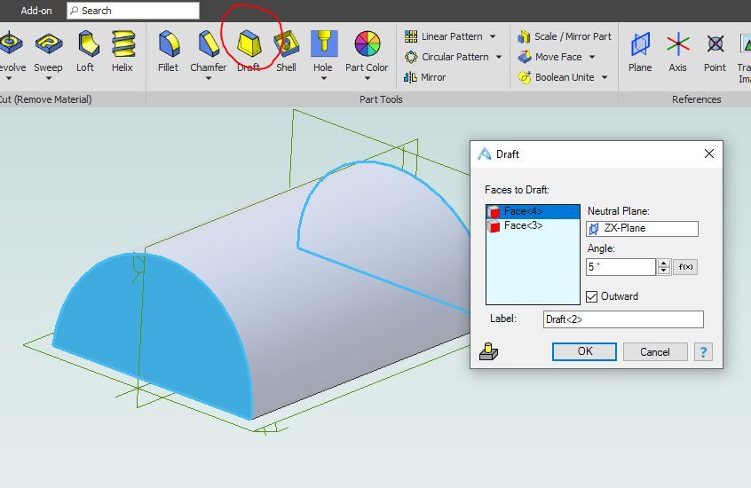

          Posted by IanT on 09/04/2022 12:59:40:
          I have no idea how Alibre CAD compares in detail with other modern CAD packages but it looked quite capable from the MEW articles and Jason hasn't moved his allegiance yet.
          From some of the things that David has said he wants to do the entry level Alibre Atom3D may be missing some useful features.
          I don't think Atom has a "draft" function that pro and expert have, this is to add a draft angle to a face or faces of a part and useful but not essential if you want to create 3D patterns for printing/casting.
          Alibre can also get a bit confused with adding fillets particularly if you don't do them in the right order and they are something you are going to want on patterns, F360 seems a little better at fillets.
          I also don't think Atom has the "trace" function which is nice if you are designing from an old image or old drawings as it allows you to import an image, scale it, correct distortion and then literally draw your part on top of the image. No need for the old way of drawing a grid over a blown up photo copy and getting your sizes and proportions from that. Not sure if F360 has it as I don't design with that.
          The limited amount of drawing output from Free F360 may be an issue, I think it will do a pdf which would be OK to go with a build thread in the mag but if you were wanting to send out for laser or waterjet cut parts then no DXF or DWG file would be as pain.
          Probably best for David to download a couple of free trials, watch some videos and then try to draw the same part or parts in each and see which he finds most to his liking.

              Alibre Atom3D does have the Tracing Image function. It is in all levels of Alibre software.

                  And the draft function is include in the extrude dialogue pane in Atom.
                  #593762
                    Does that not do it to all sides of the sketch being extruded as it does in pro, this is the draft that I don't think is in atom
                    Edited By JasonB on 09/04/2022 20:44:23
                    #593764
                    John Hinkley
                      @johnhinkley26699
                      Jason,
                      Yes. I thought that was what was wanted. I couldn't visualise an object that would need a draft angle on only one face of a projection. Though it would be possible to design such a construction if necessary with separate sketches and extrusions.
                      Edit.  Posts crossed!  That facility is not in Atom.

                            Posted by JasonB on 09/04/2022 16:08:58:
                            Atom does allow you to use a draft angle on extrusions.
                            #594254
                              Neil, see my subsequent posts to that one , Pro has the ability to put draft on individual faces. For example this half round does not need draft on the curved parts but would at the ends
