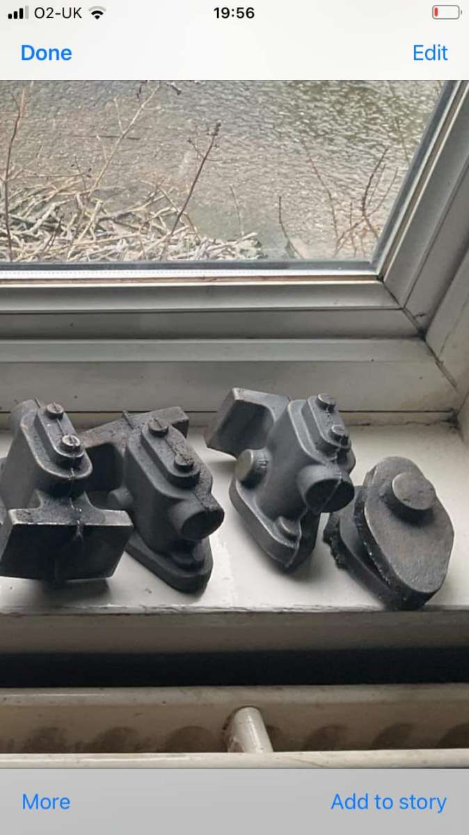

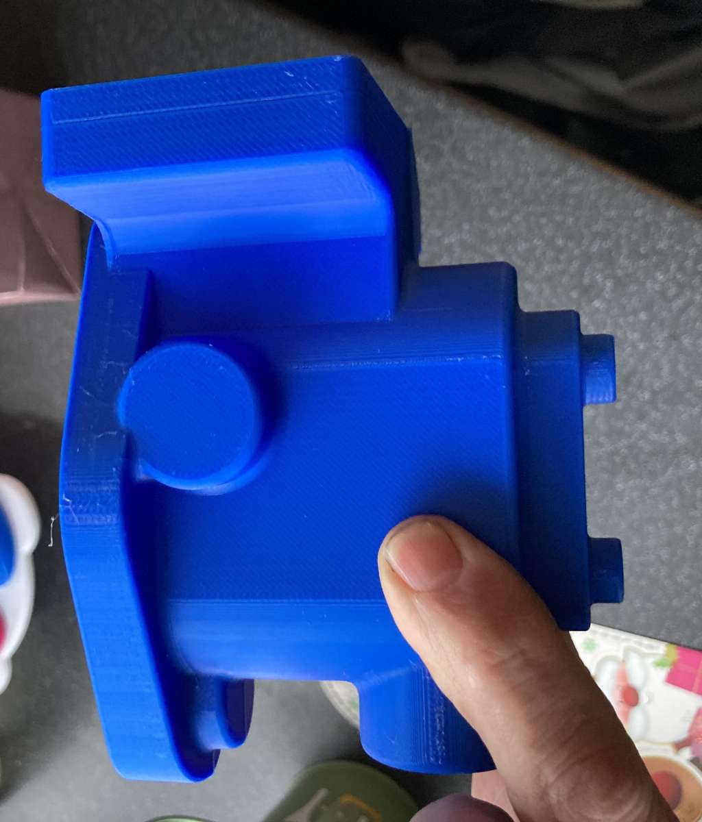

        Both have cast from my wood, metal and plastic patterns and also 3D printed ones by others from my CAD files. Mostly by Graydon and I have been machining some of theirs over the last couple of weeks. Graydon will cast from patterns posted to them and send the castings so location is not such an issue.

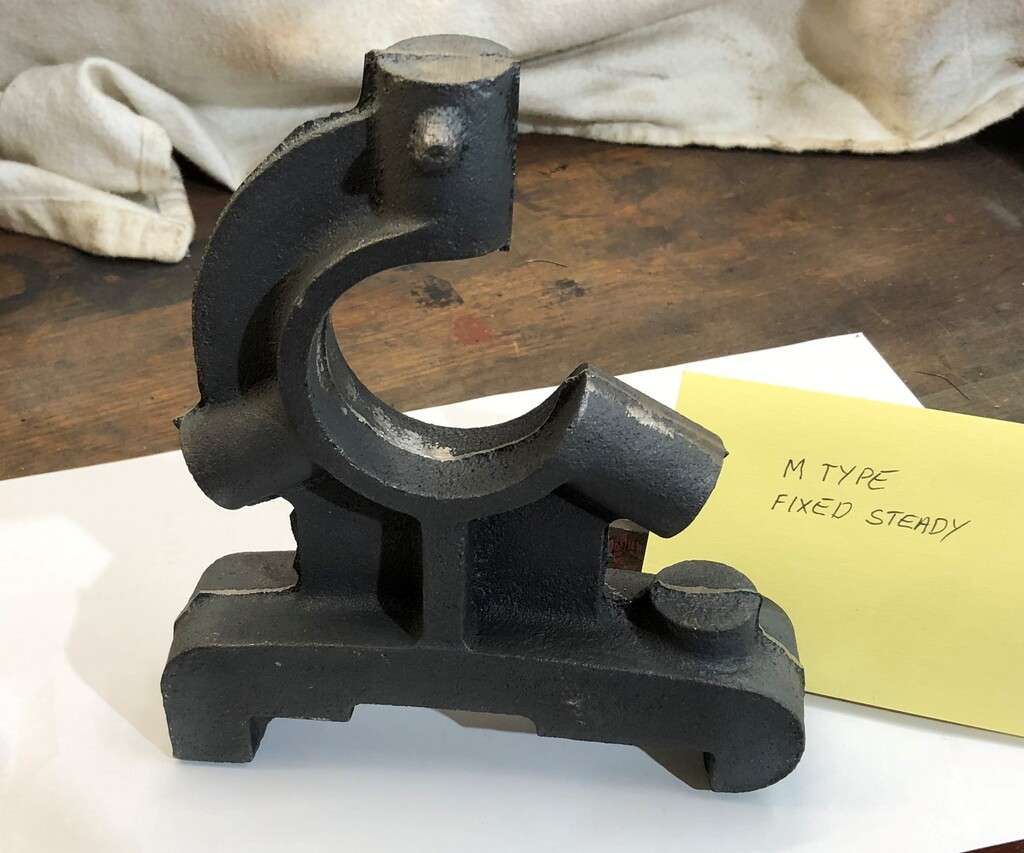

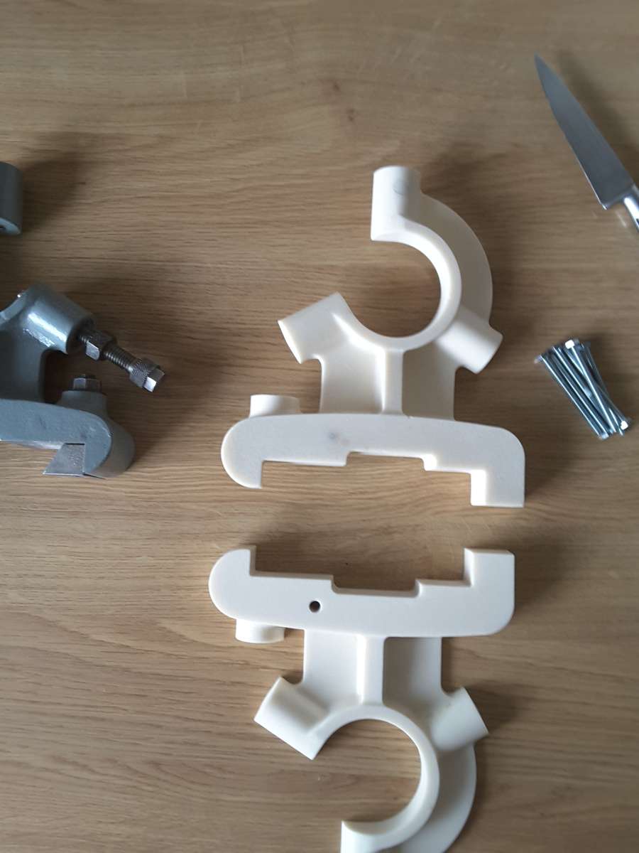

            I have had a few castings made and am in he process of having a handwheel casting made. I use Sutton castings local to me  https://www.suttoncastings.co.uk/     not far from Mansfield and Greenbank Patterns Kirkby in Ashfield to make the patterns. the most expensive part is the pattern which if you could make your own reduces the price dramatically.
            David
            M type fixed steady20220204_121803

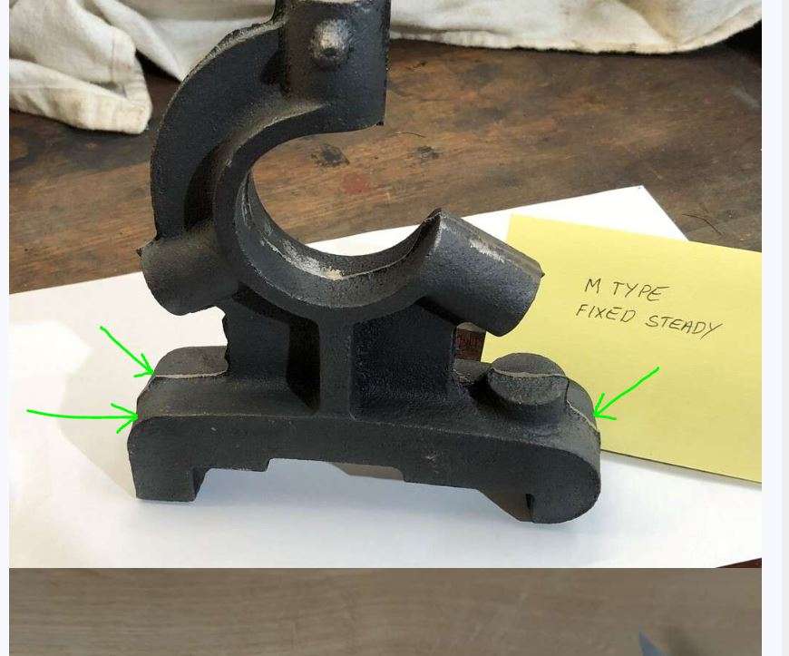

                Looks like a superb finish on those patterns. Plastic? 3D print? I don’t see any draft angle.

                    Photo of the casting seems to show draft better than the one of the patterns. With most foundrys now using some form of airset sand you don’t need much angle I/ve been using 2deg for the patterns I’ve been doing the last couple of years
                    draft
                    2deg draft on these patterns
                    401100228_1297481530949785_5331616546400150489_n
                    Casting came out OK
                    cast2

                      The patterns for the fixed steady were CNC cut by Greenbank patterns from a drawing from the files section which looked like an original drawing. They were cut in a resin plastic block.
