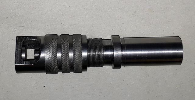

                          Tricky
                            @tricky
                            lantern chuck 1.jpgThis is my version of Bernard's Lantern Chuck. I did have a problem with some of the dimensions on the drawing in MEW 302 as they were a mixture of imperial and metric and there was a spurious 1.2 (inches ? ) which was obviously wrong. I think it would have been better to have the drawing in either imperial or metric or as 2 separate drawings. The other thing I found was that with my fat fingers it was a little difficult to get a screw-holder and screw into position ready for shortening.
                            lantern chuck 2.jpgI was quite pleased to get the 2 parts screwing together nicely as I used a carbon steel tool that I inherited with the lathe from my father and must be over 60 years old for the external thread and a home-made silver steel internal threading tool. At least on my Myford S7 the 8tpi leadscrew makes it easy to cut a 32tpi thread.
                            Richard
                            #542465
                            bernard towers
                              @bernardtowers37738
                              sorry Richard but the 1.2 dimension does not appear on my original drawing. the mix of dims are there to enable people to imagine the sizes as some people think in imperial and some in metric. It looks like you have made a good job of it and I hope it gives you pleasure using it. Try putting your screws in with tweezers.
