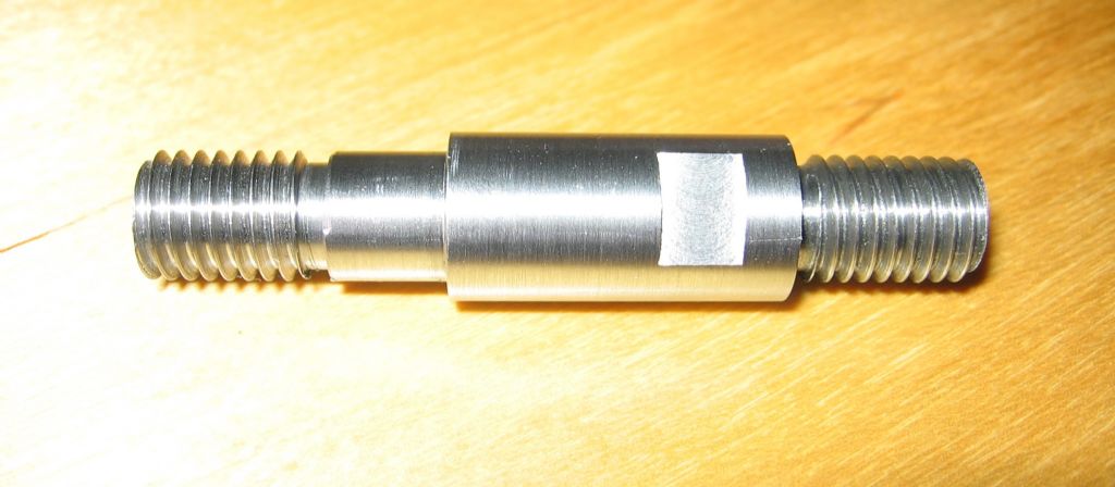

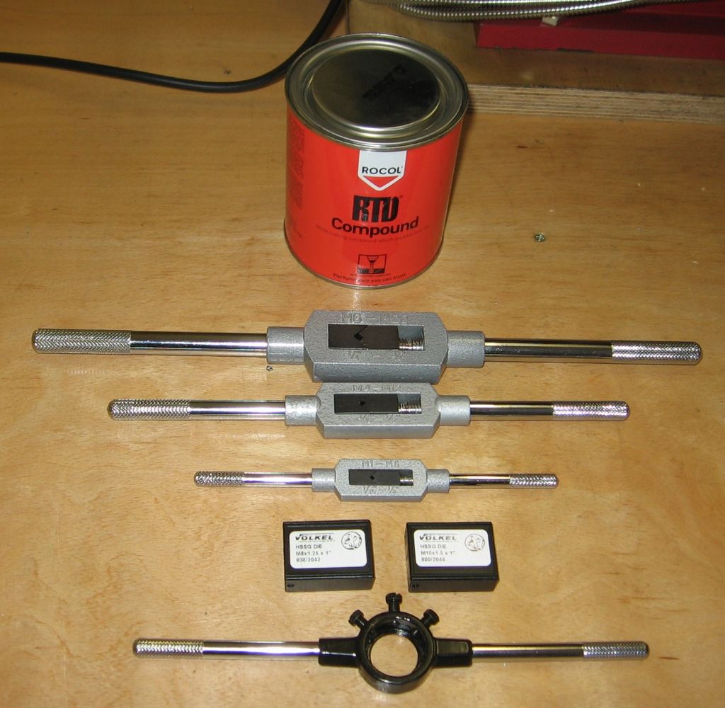

          Right, some welcome further stuff. Apart from my technique which several of you have been kind enough to point out the correct way, I have found two other issues which at best won't help.
          The adjusting screw on the die stock is badly formed at the point and the screw slot is far too shallow which rather makes it unadjustable, and more importantly I found the tailstock wasn't locking to the bed securely enough. Rotating the feed was pushing the tailstock away rather than onto the work so I've adjusted it to lock better.
          I am also going to replace the die, whatever the circumstances around it there is no doubt it is poor. I will also see if I can fix the diestock or replace it. Has anyone a reputable supplier other than Drill Services, I was thinking Tracy Tools as I've had stuff from them before.
          I will also look at single point threading as a separate exercise, some Youtube videos have helped explain things on that front.

              "Before attempting a cut, did you open the die to its maximum internal diameter [within the limits imposed by the diestock's own ID] by driving one of the die holder's screw points into the split and leaving the other screws loose?"
              Yes but as I explained above I have discovered a faulty screw in the die stock.

                              The central screw for opening the die-split is often quite unsuitable – a dog-point is generally useless unless the split has an especially wide vee. Sometimes I've made a new one from a capscrew with a little tommy-bar through its head and a turned 40 – odd degree incl. vee point. This'll open up the die till it's hard against the holder's I/D, but it'll also put a lot of stress on the tapped thread in the mazak holder – remains to be seen how long that'll last.
                              Cheap(-ish) sets of very adequate metric taps and dies in some stuff they call 'tungsten steel' are available from Machine Mart. They work well enough for everything I routinely do and I only need to buy a new set every couple of decades, and that's usually cos of broken taps in difficult materials rather than worn-out dies.

                                      The central screw on most of the newly bought, economically-priced three-screw die holders I've got were originally cone points rather than dog points. Sadly, these screws are generally too soft to do the work of opening the split of a split die; they typically get mulched after a few uses. I replaced them early on with Grade 14.9 cone point socket set screws. These are up to the job.
                                      By way of contrast, the secondhand Dormer and Toga die holders I've got had much tougher cone point screws when I acquired them. These didn't need upgrading.

                                        Todays update, I have bought a new 1" Volkel die from Rotagrip and a new, reputedly drop forged steel, Volkel die stock from another supplier. This is possibly over the top, it certainly wasn't cheap, for what I'm trying to achieve, but I can't see any point in persevering with probably damaged die and stock. It was approaching the point where the workshop wall was going to get dented. I'll see what happens when the new bits arrive, I now have a far better understanding than I did three days ago, thanks all.

                                            This all ground to a halt after my last post. New dies were ordered from Rotagrip and despatched which was the last anyone has seen them, lost in a Royal Mail office somewhere. Obviously new ones weren't going to be sent until the claim period had expired and this coincided with the coldest spell since I've lived in this house. I could warm the attic workshop with warm air from below and turning the radiator upto full, the fuel bill didn't want to be thought about. As it was the replacement dies arrived on Saturday, meanwhile I had ordered various new threading equipment and consumables, I think I may have had a blind spot here as nothing of threading bits was really up to scratch, a decent set of BA taps and dies is due to be bought in the new year.
                                            Having collected all the bits together a new stud blank was turned and duly offered up to the new die and with a prayer to Mr Whitworth, a thread was cut which joy of joys was perfect first time. Encouraged I turned it round and did the other end with the same success. I was so taken aback at the apparent ease that I did wonder why the last attempt was so abysmal, partly my technique which has undoubtedly benefited from the advice here but also I think the die especially was just plain faulty. Certainly Herr Volkel's products seem to work as you would expect and whilst perhaps more expensive than alternatives worth it for the lack of drama. Decent clean threads and not bent.

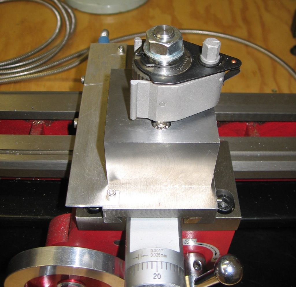

                                            This all ties in with my oversize facemill thread to produce this, a fixed toolpost for a Multifix aa. It's not been without it's stresses but ultimately a nicely finished end result that works, can't say fairer than that.
