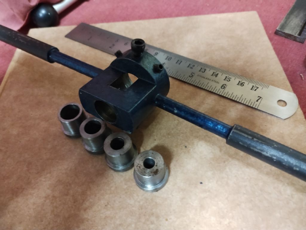

      Although (as I previously commented) I like lathe cut threads, as Nicholas Wheeler says it can sometimes be a hassle to set up for a relatively quick 'one-off' job.
      Something I knocked up years ago (which has a relationship to electrical conduit threading tools) is great for getting common threads started and aligned perfectly staright – was quite easy to make (can't remember where I saw the plans originally) and works a treat if the thread isn't going to be too short. This has a set of common metric bushes for 4,6,8 & 10mm. Other sizes can be knocked up in 5 mins as required.
      One big advantage is the work can be held in your bench vice, avoiding the chance of slippage you get sometimes (particularly on bigger thread sizes) when holding in a lathe chuck when using tailstock die holders etc..
      There may be commercial versions available? But quite easy to make for free from odd stock lying about
      regards Mike

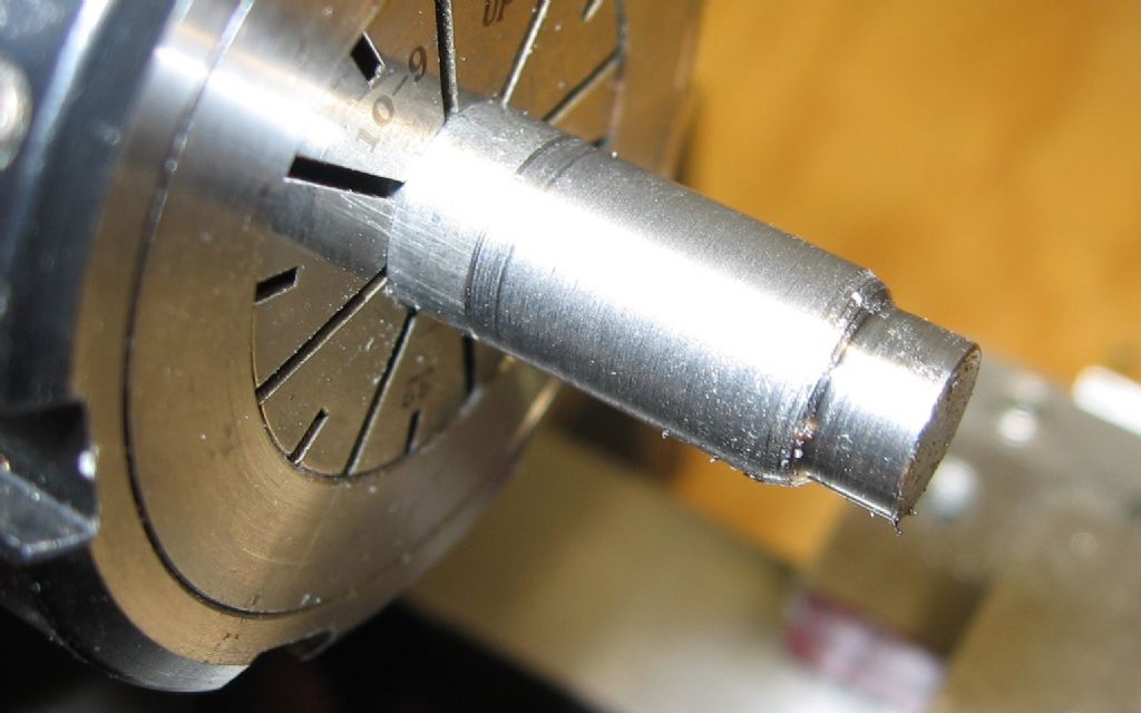

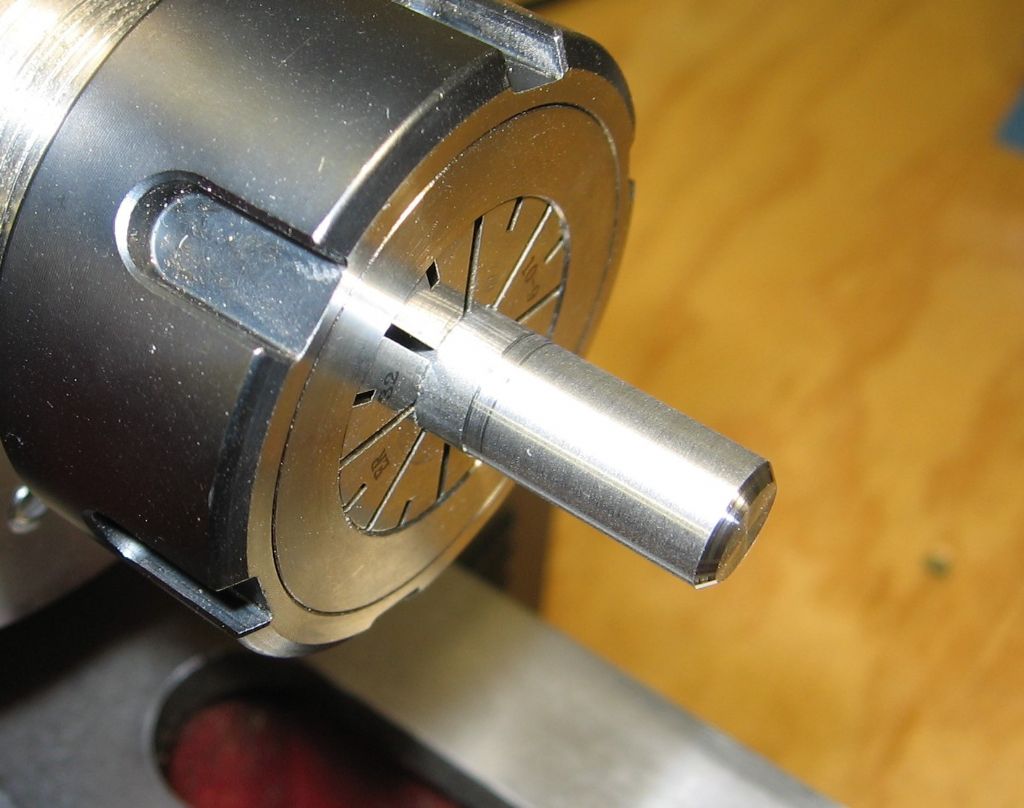

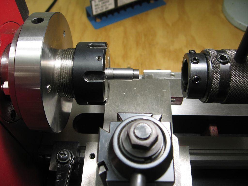

                  Ok
                  A couple of pics, this is where I started,
                  a piece of 10mm bar with the end reduced to 9.8mm and bevelled. I subsequently turned a spigot to just under the minor diameter of the thread to centre it all. The next shows the horrible end result,
                  I have a suitable tommy bar for the collet chuck and the tailstock die holder is a bog standard Arc product. It's a brand new 1" die and I measured the holder at 25.4mm so I think they are intended for each other. I don't disagree with you Nicholas, this really shouldn't be difficult but for some unexplained reason it is. I'm not the most expert mechanical engineer but this is basic stuff isn't it?
                  I've had enough today, a further look at this in the week.
                  Martin

                      Are you using the correct side of the die?

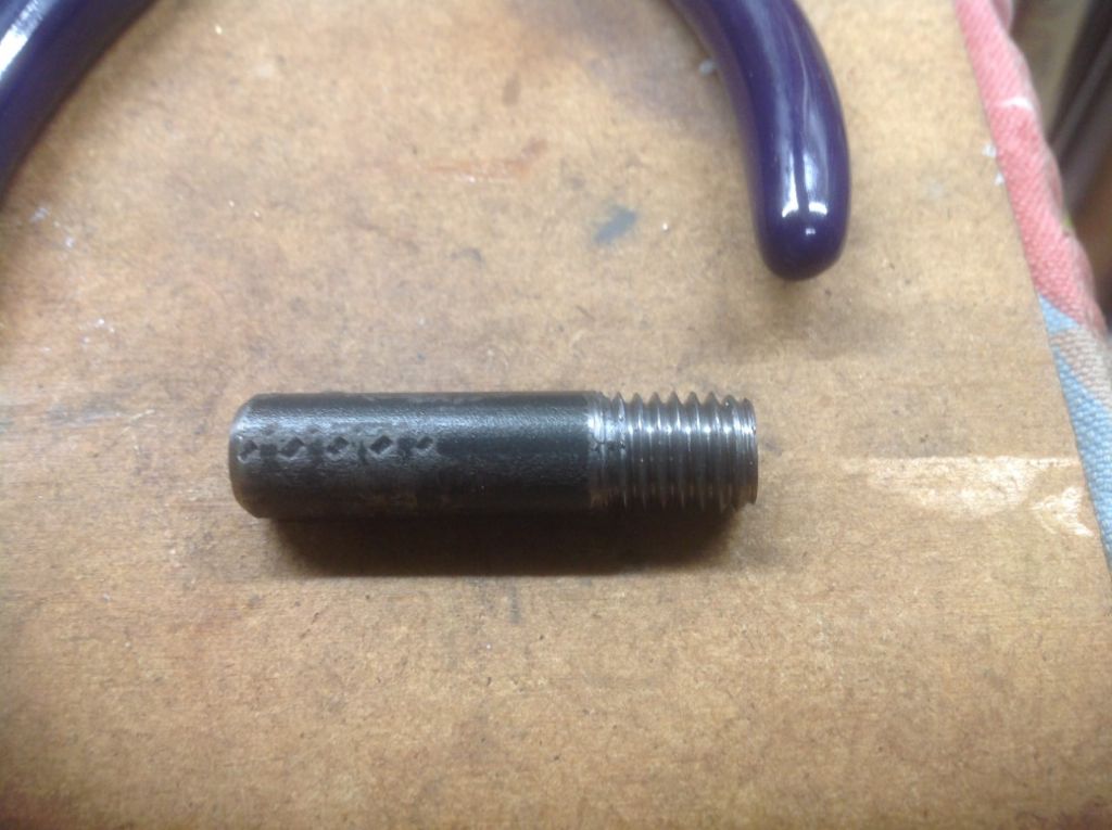

                        Martin, can you tell us the brand of die you're using, what it's made of and whether it's split or solid?
                        The picture below shows an M10x1.5 thread I've just cut on some EN3 mild steel using a woodturning lathe. The bar was held in an ER20 collet chuck in the spindle and the thread turned using a bog-standard two-handled die holder held square against the start of the thread with my drill chuck.
                        The die was a Presto HSS split die, and the diameter of the section of bar to be threaded was first turned down to exactly 10mm using a hand-held piece of HSS rested across the lathe's banjo.
                        I wouldn't want to have to do this sort of thing this way very often, but it is perfectly doable all the same. There is no discernible bend in the turned section.
                        I've tried cutting M10 on EN3 using the wood lathe in the past without success. The only difference in my set-up then was I was using a solid Aldi carbon steel die; it just wouldn't cut. It's that kind of situation that can tempt you to use too much force and then cause things to bend.
                        Having said all this, I can't see how you can have arrived at the result in your second picture using any kind of M10 die. If I looked at the second picture out of the blue I'd say someone has used a file with the intention of turning a dog-point.

                          I think Martin said above that he was using the correct side.
                          I sometimes use steel hex bar to cut big threads with a die so it can’t spin in the chuck and also it seems to be free cutting. Screw cutting in the lathe can be very satisfying if you have a gearbox with the desired pitch. Setting up change wheels is a pain.
                          I agree with Hopper: turn the bar down to 9.8 mm or less. Commercial threads are usually well under nominal size over the crests.

                            I just thought about something reading this. I made a dieholder for my lathe that fits/slides from the tailstock.
                            Now the type I got might work, just thought about it had not tried it yet, and that is to use a steady rest clammed on in my case about a 2 inch smooth round part just after the 4x tightning screws for the die onthe holder's tip, that will hold the die+dieholder in position to start, and in my case it can work for say 10mm or so before it run out of space, just a thought.

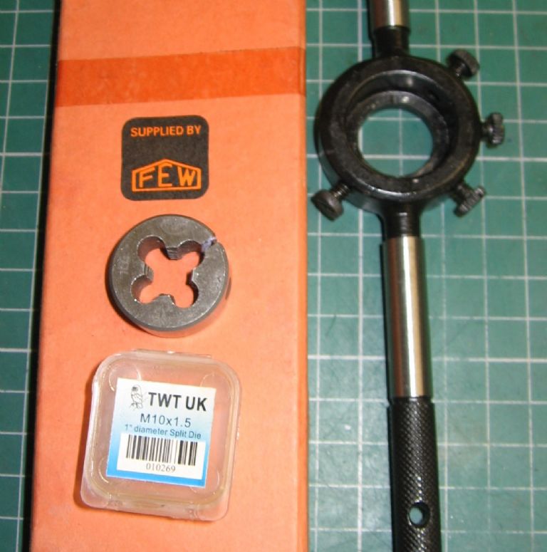

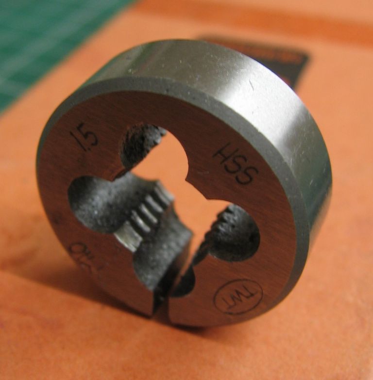

                                Two more pics,
                                a pretty standard M10 split die by TWT UK whoever they may be but bought by me from Drill Services Horley along with the die stock. My understanding is that we are looking at the trailing face of the die and the thread is started on the other side. I do hope I've got that bit right.
                                The general set up for illustrative purposes only. Right back in the first post I showed the stud with threads cut with the same die, which was fine except for the bend in the thread at both ends. They were hand done in the vice and it was necessary to apply some force to the diestock to start the thread and it was by no means easy to cut. Is it possible that its just a cheap and nasty die? The narrow spigot was turned, it's not a result of the die, I was trying out an earlier suggestion.
                                Regards
                                Martin
                                  The penny has dropped. I see on closer inspection that you tried to start the thread beyond the dog point but basically got nowhere.
                                  If you were using the same die as the one you cut the complete but bent thread with, then, in the case of this initial and complete failure, I'd say there was not enough force constantly applied pressing the die on to the work to get the thread properly started.

                                  Looking at your die, I can't help seeing almost non-existent teeth on it.
                                  Edited By Bill Phinn on 13/11/2022 23:06:26

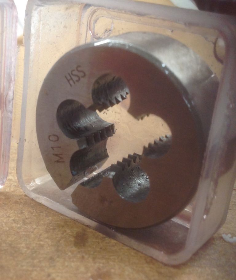

                                      The die looks, Martin, like it's suffered the ancient Chinese torture called lingchi, aka death by a thousand cuts. Either that or it's been cutting very abrasive material. In your first picture of it, it looked seriously clogged with swarf as well. That's never going to make for easy cutting.
                                      I've attached a picture of my own M10 die for comparison purposes.
                                      ETA: I don't think my die is a Presto after all; I think I bought it from Turbine Jon, which may mean it's the same die as yours.
                                      Edited By Bill Phinn on 14/11/2022 00:30:03

                                            Pic is a bit blurry so hard to tell, but that die does not look right. The flats on the tops of the cutting teeth look way too wide. Compare it with the pic Bill Phinn posted and see how pointy his teeth are.
                                            With the set up you have used in the lathe and the lead-in spigot on the job, that die should cut a thread like butter. It is only 10mm diameter, a mere nothing to thread usually. But it may take quite a bit of force from the tailstock to push the die onto the job firmly to get it to start cutting a thread while cranking the chuck by hand slowly, (Purists look away now!) using the chuck key as leverage.

                                                That die is a basket case. If it's properly-hardened HSS, it's hard to imagine how the teeth could've become so severely blunted.
                                                At railway where I volunteer, there are plenty of brutally-tortured HSS dies, but they're chipped and spalled, not bruised and swaged out of shape like that.
