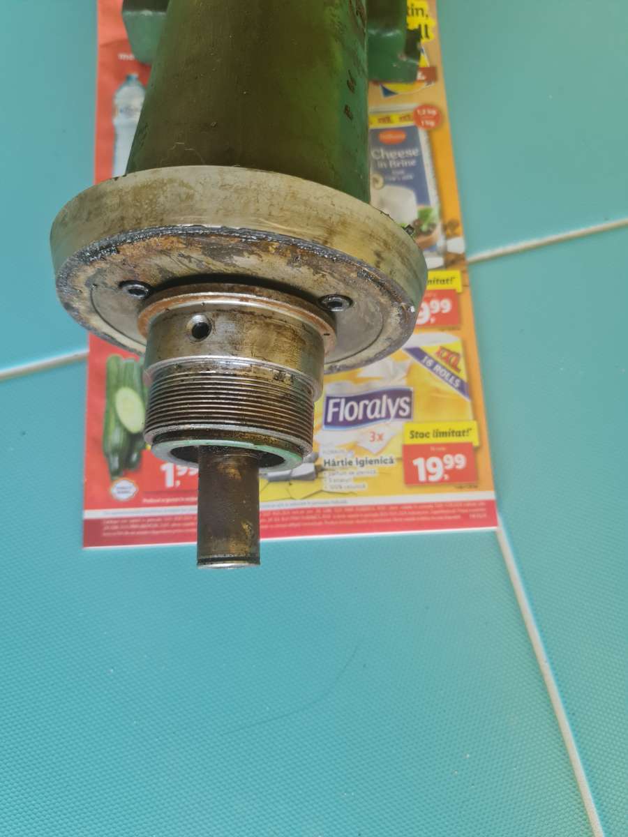

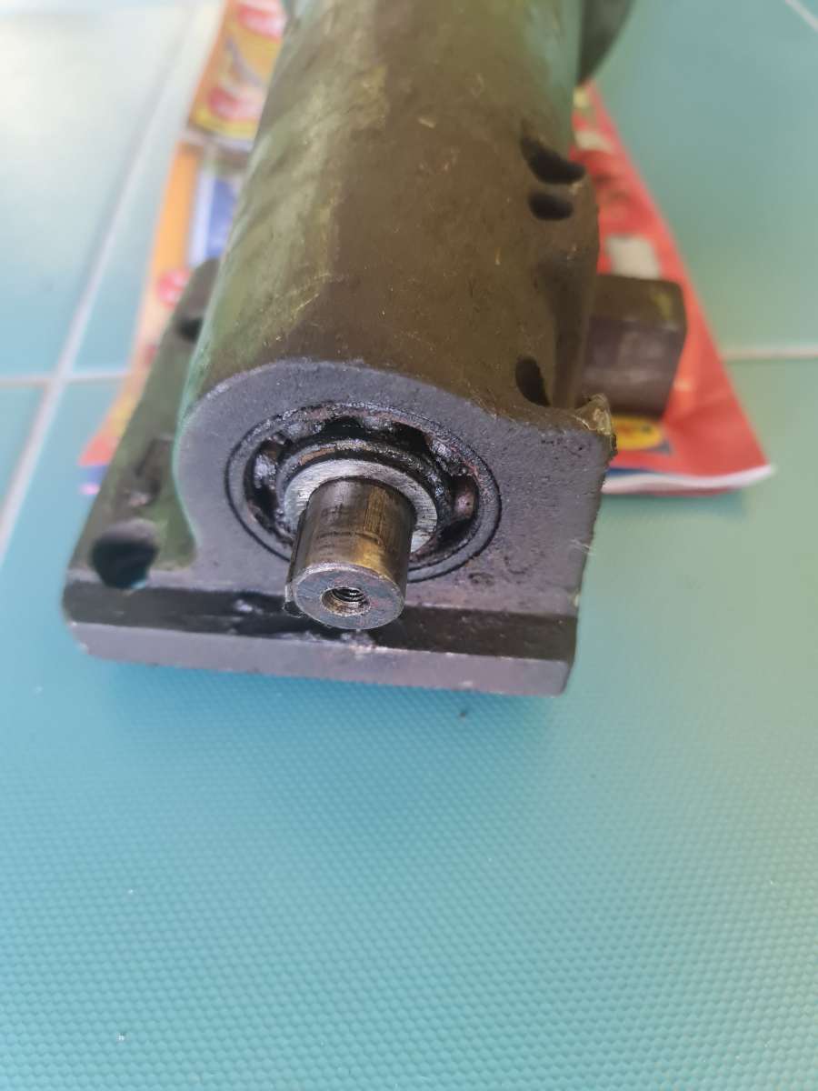

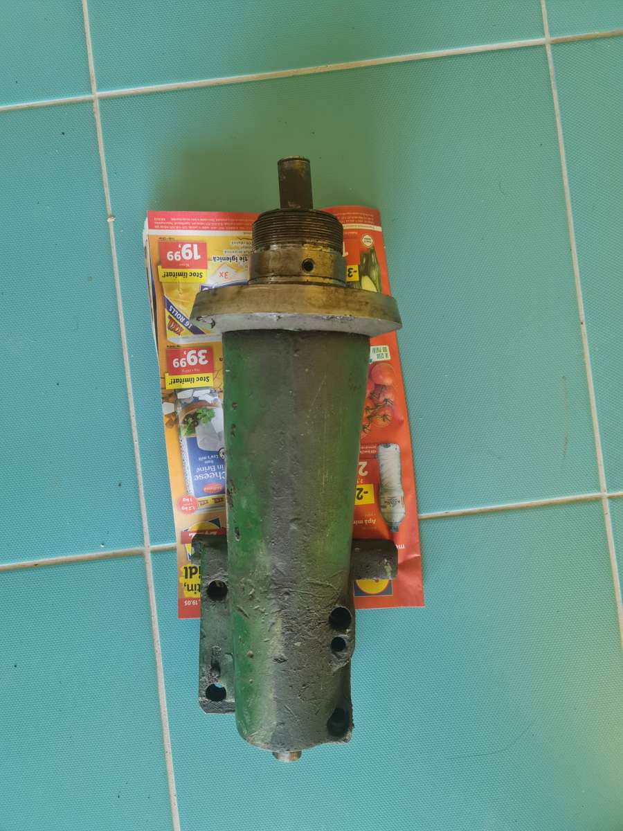

      One of my milling machine has a bent arbor. It is the Y axis manual feed. Because of this it is very difficult to lift or lower the table. And for the same reason I can’t remove that big nut which in turn covers the screws that hold the arbor in that casing. I tried to use the vise but the bent section is too short and you would need a lot of force to bent it in the other way. How could I fix this?

            I drilled a small hole on the edge of that nut. Then I enlarged it with the mini grinder and I was able to remove those screws.

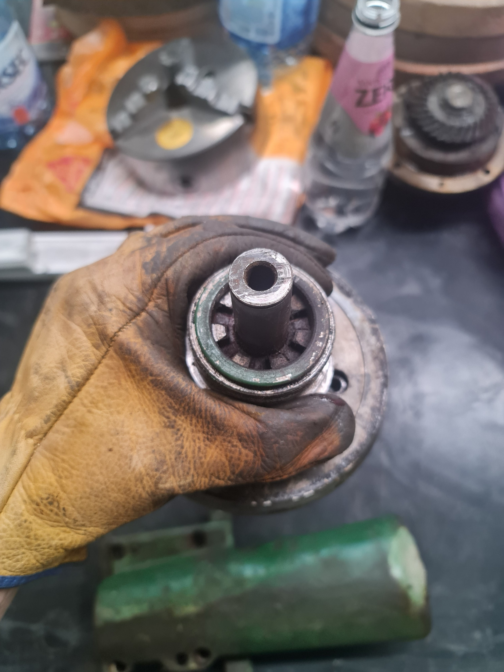

            And I was able to remove the arbor. It is looking like this:
            Cutting it is a good idea. Actually I’m thinking to cut it only enough to make it easy to bend. Then I could fill the gap by welding. Something like this:
            Is it possible that this arbor is made from some high carbon steel that can’t be welded?
            How about if I use a long pipe and try to bend it in the vise? My vise is not very big but it is made of steel not cast iron, so it should not break. Would it be strong enough?

                i would not attempt the welding idea. The molten weld contracts as it cools and exerts VERY powerful pulling forces on the surrounding metal. The shaft would end up bent again, unless you could guess exactly how much contraction would occur and bend the shaft the other way too far. But you can’t get that exactly right so forget welding.
                Can you knock the shaft out of the bearing the other direction? Or is the shaft stepped so the bearing can not slide over the long end of the shaft?
                If you don’t have a hydraulic press as Noel suggested, you could then heat the shaft with an oxy acetylene torch, or maybe even propane, until red hot and then straighten it in your vice with a piece of pipe. It will be very hard, well nigh impossible, to get it back to dead straight because metal will have been stretched etc during the current bending. But if it is just to mount the handwheel on, you can live with a small amount of wobble.
                If you want it dead straight and that does not work, you might have to cut the end off the shaft and make a new end piece and attach to the old shaft with a spigot on the new piece that fits into a hole drilled and reamed up the middle of the old piece. Then carefully secure it with  either Loctite, solder, cross pins or even careful tack welding. Or just make a whole new shaft.

                  These shafts are not usually hardened and if that one was it would likely have snapped before getting to that angle.
                  Even if you straighten it you may still not be able to remove it easily as the section which was bent then straightened will probably be out of round. You may be able to carefully grind it enough to extract it.
                  As for straightening it, if you want it dead straight and true then your best chance is probably to straighten it as much as you can, weld it up and turn it back straight. Personally, I would just re-make it between centres.

                          I just realized that the bent part of the arbor is not subject to too much force. Because the handwheel has some teeth that connect to the nut. So I cut the arbor enough to straighten it. And that’s it, the problem is solved! Now it is spinning very easy.
