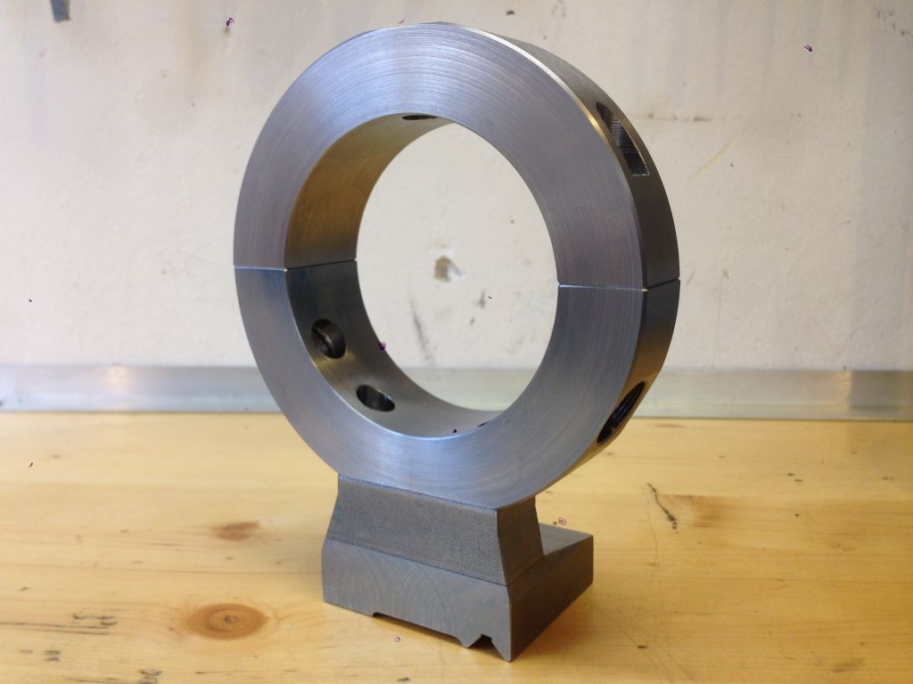

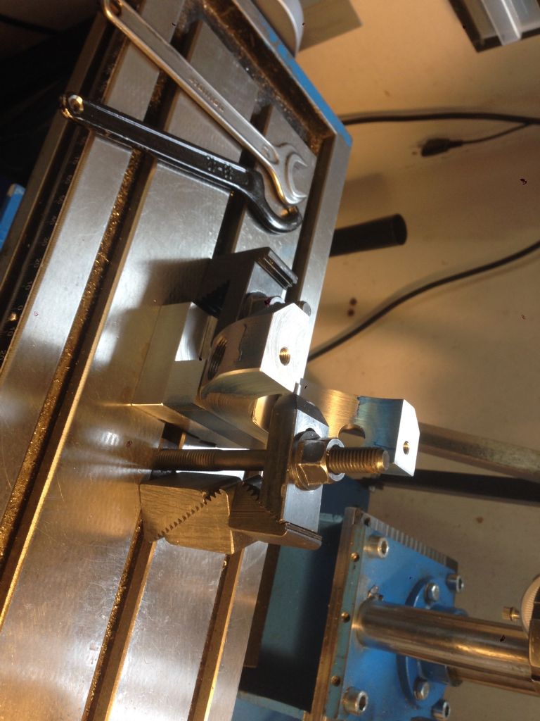

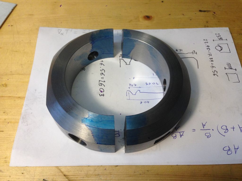

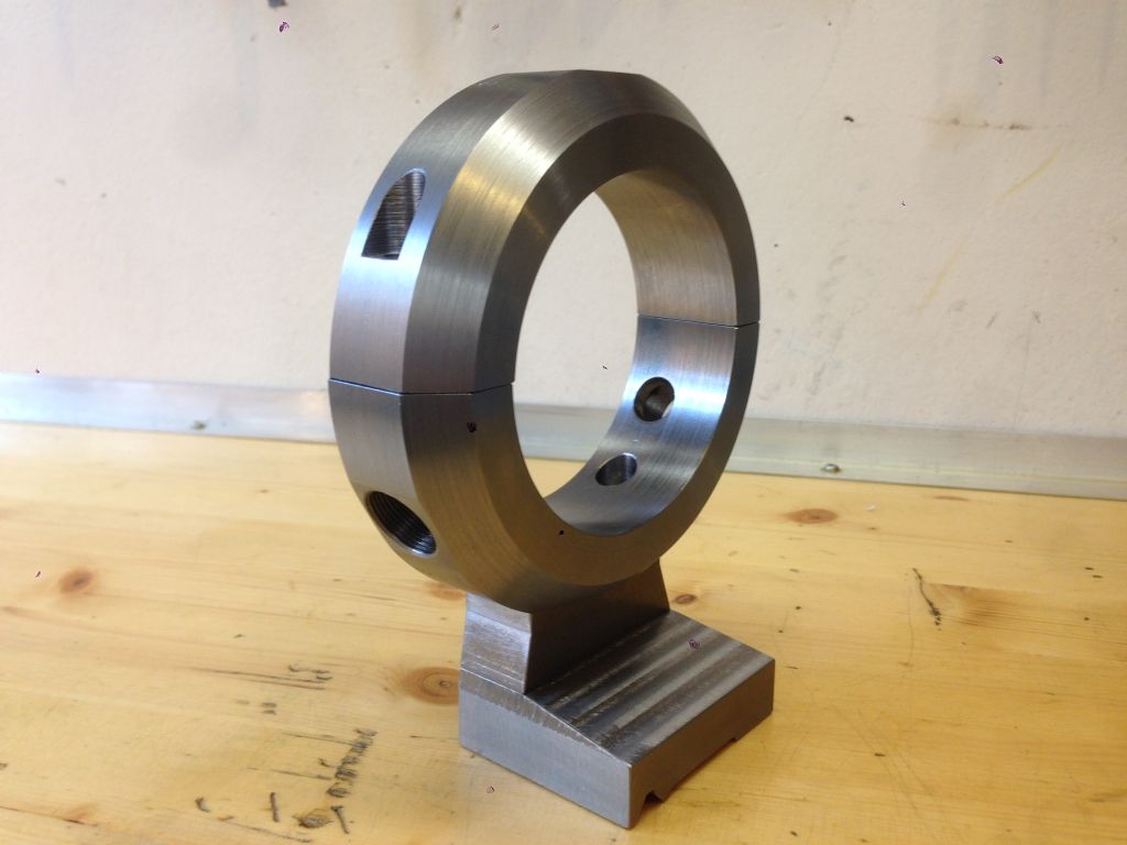

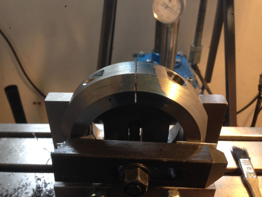

      Measuring the center height.
      The nerve wrecking experience of sawing the ring off.
      It turned out very acceptable, and a cleanup on the mill finished it off.

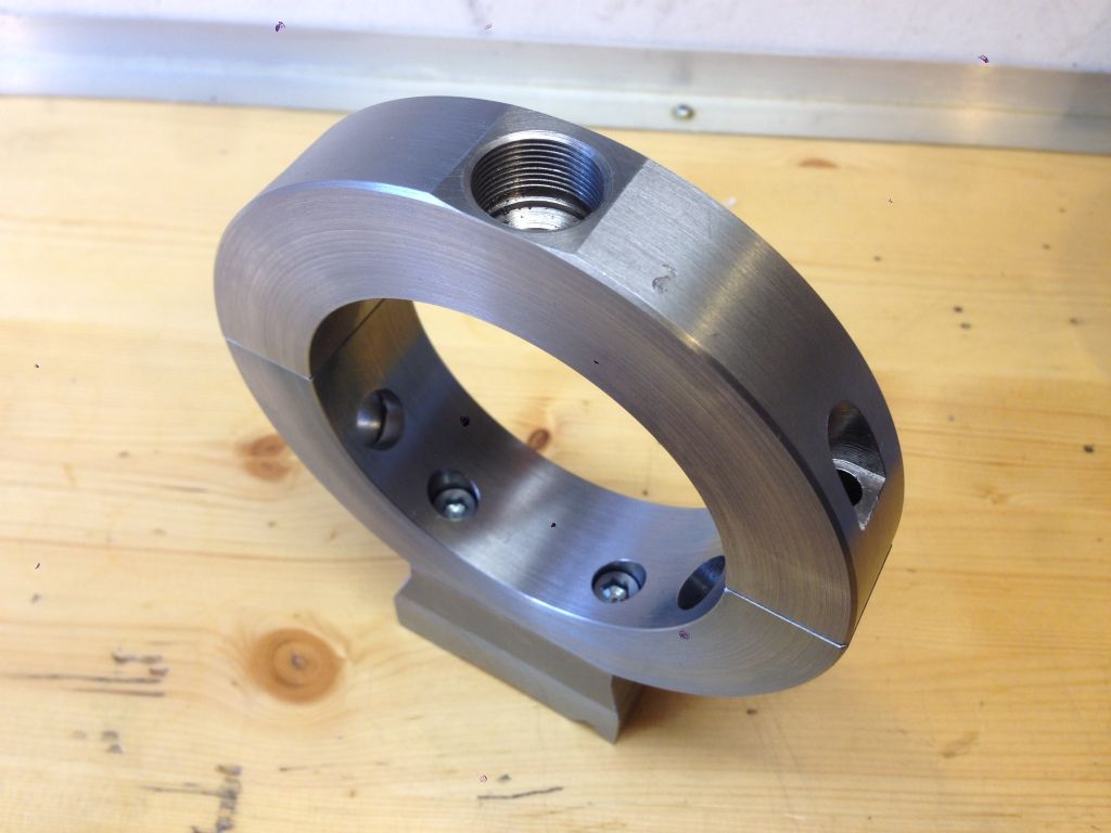

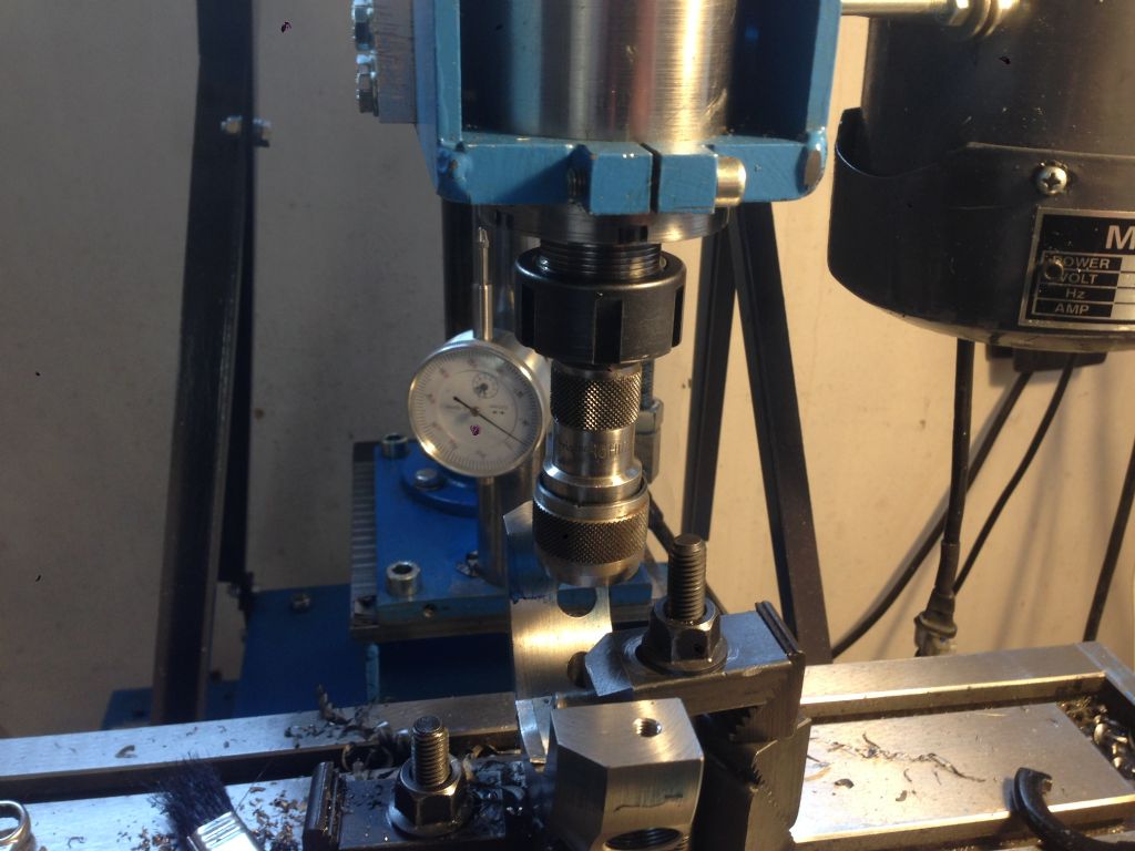

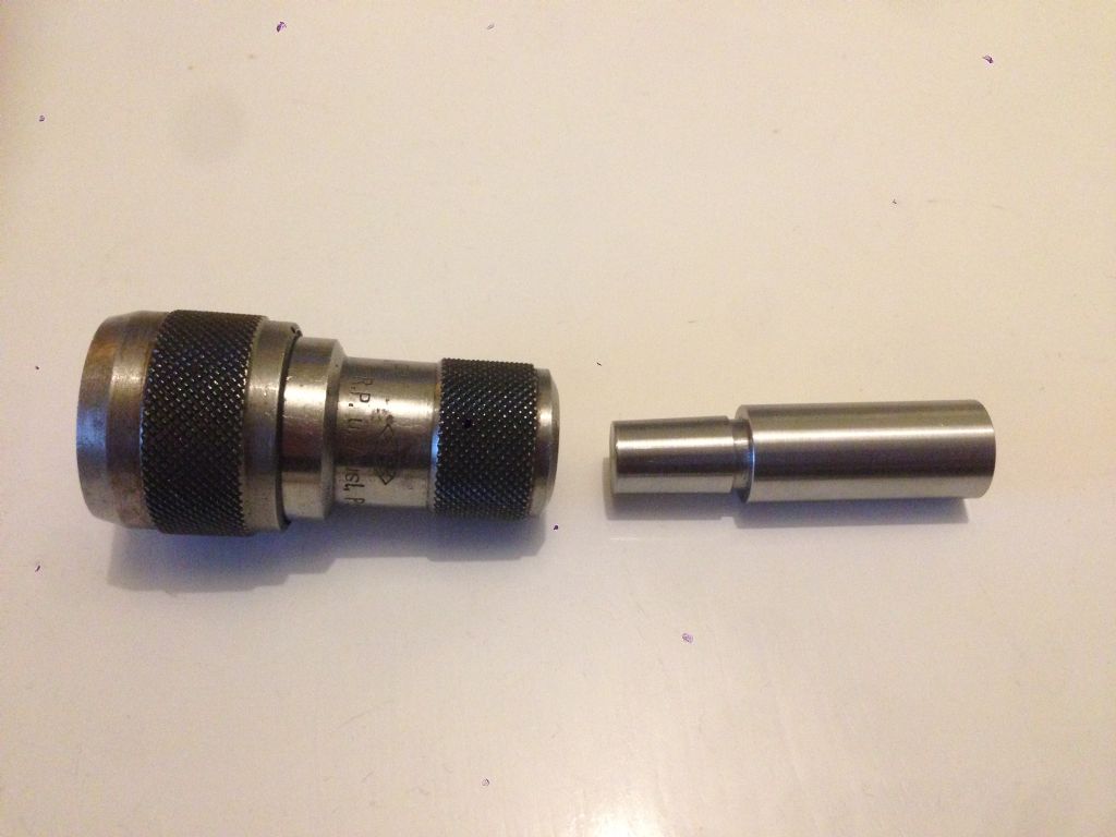

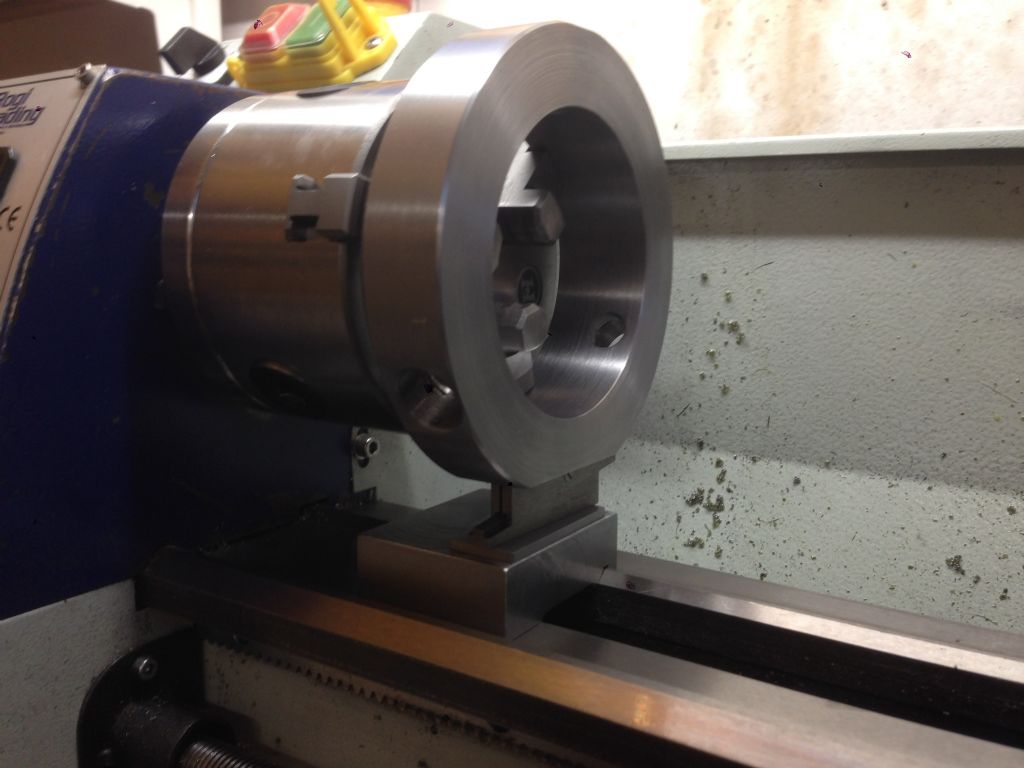

        Setup for drilling the holes to screw the thing together.
        My fat chuck could not reach down far enough to drill through with a 5mm drill, so I made this B12-15mm arbor for this small chuck.
        Annoyingly the chuck did not perform well. I purchased it on a flea market last year but it does not chuck drills in a straight fashion. I have to take some time in the future to disassemble and inspect.

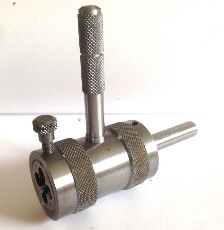

            To proceed I decided to stop and make the following die holder.
            Had some trouble with this particular steel I chose for the screw C45E. I did two attempts to harden it but it cracked both times. I usually dont have problems with silver-steel when quenching in water, and the info about C45E says you can quench in water. For the last attempt I quenched in motor oil and this was a success.

              Btw, the design is based on Dave Fenners tailstock die holder from MEW 157.

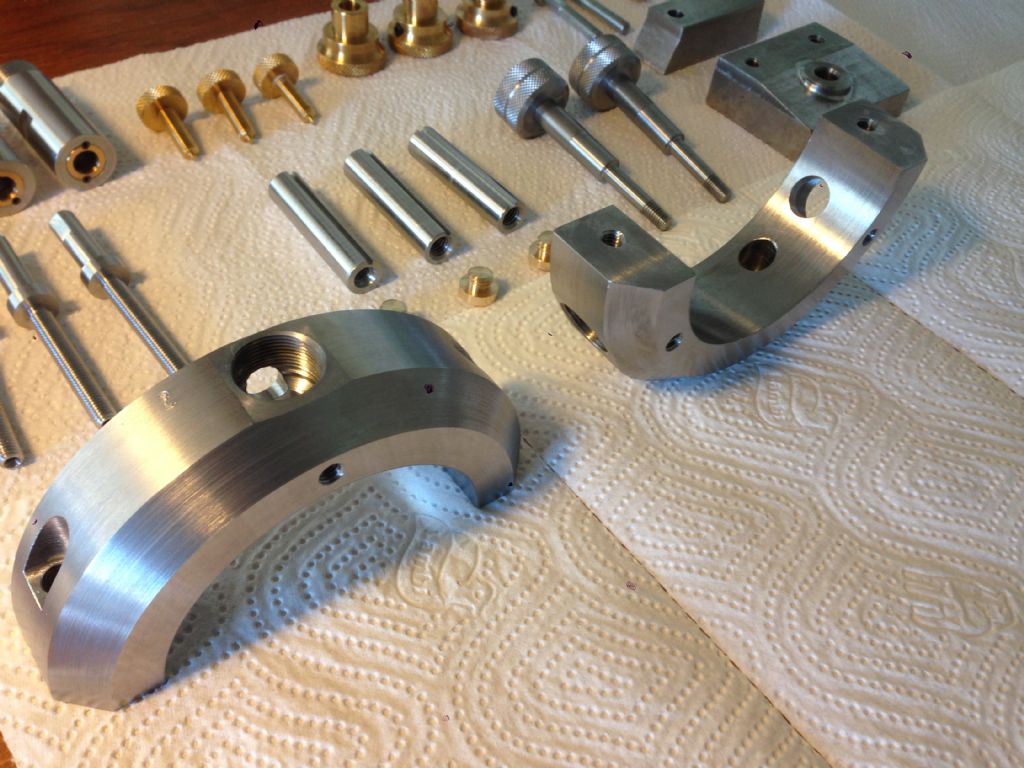

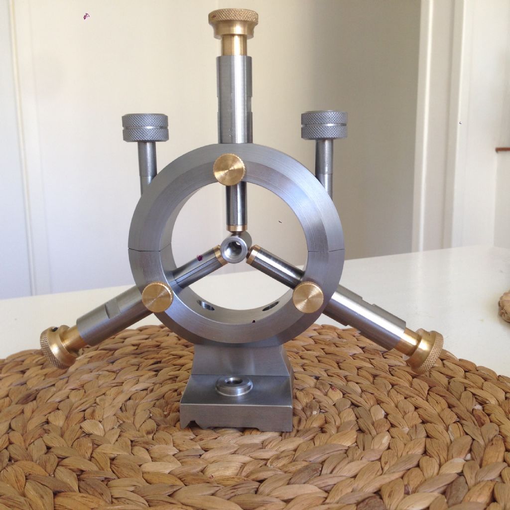

                These are all parts made for the steady rest
                #299122
                Benny Avelin
                  @bennyavelin86238

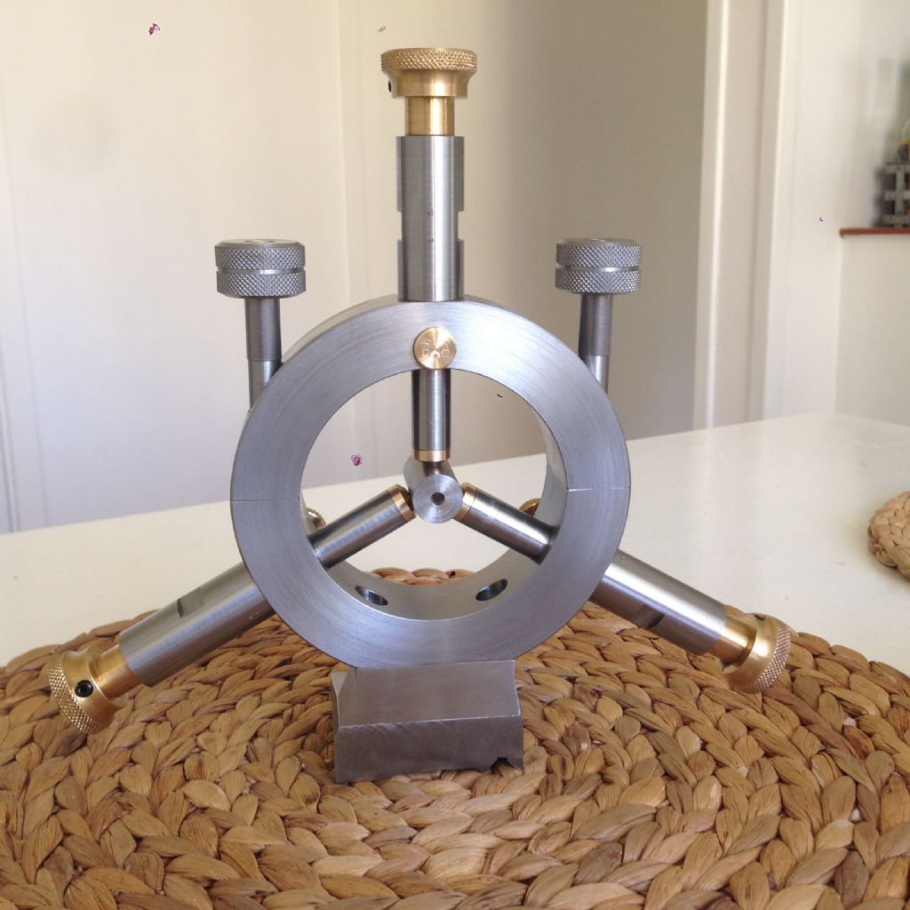

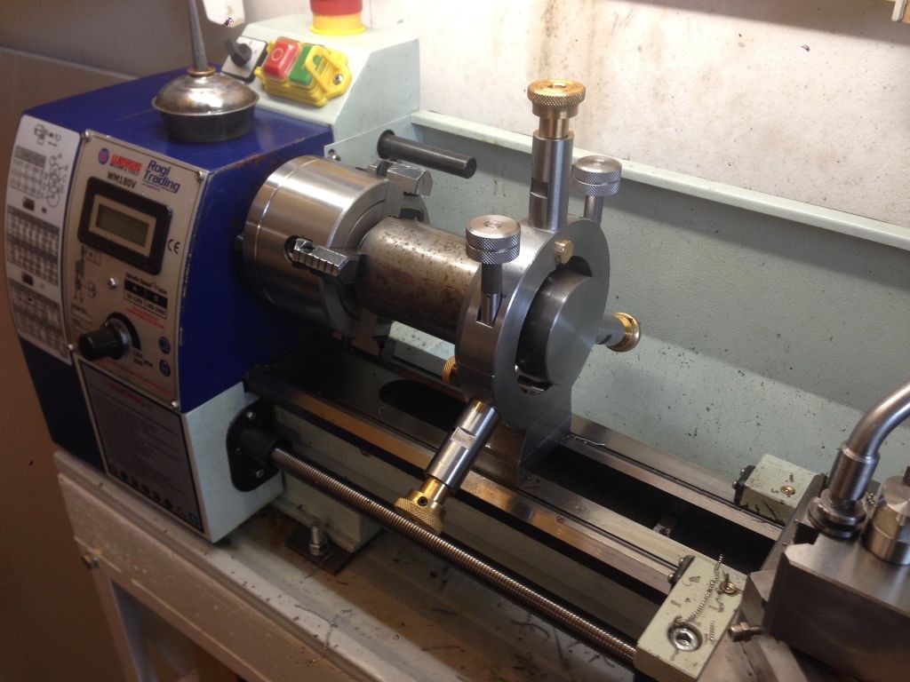

                  The steady rest is now completed, I am very pleased with the outcome.
                  #299123
                  Benny Avelin
                    @bennyavelin86238

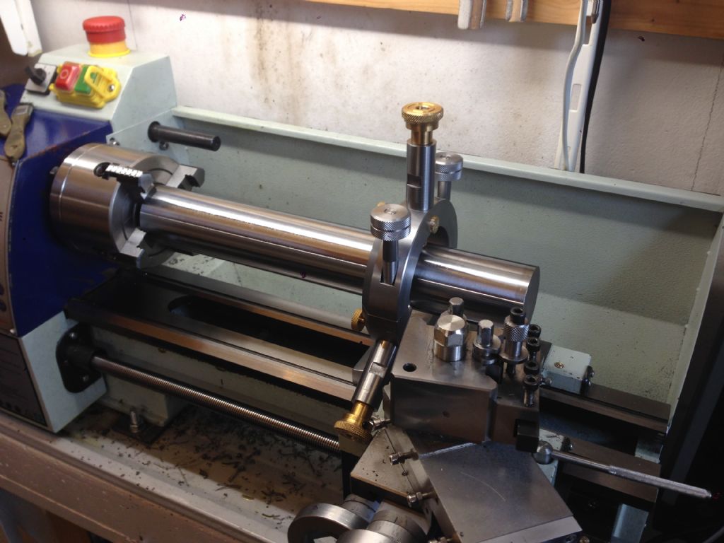

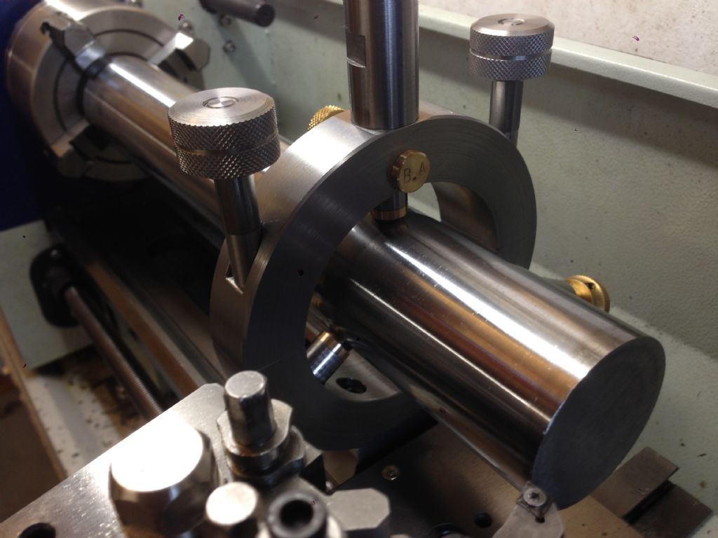

                    I have had the chance to test it some, first I chucked up a 60mm dia s355j2 bar, faced and parted off a small disc. Went fairly uneventful except quite underpowered for the parting process, however no chatter.
                    I also faced the ends of a surface hardened hydraulic rod (given to me by someone at some point in time). Worked like a charm.
                    I am thoroughly pleased with this project, although it took quite some time to complete with my small machines and limited shop-time.
