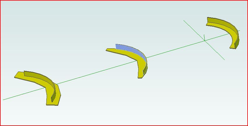

      To finish off a boat boiler I want to use brass angle as trim . How do I bend the angle?, the radius is around 6 inches, Yet to buy the angle, size will be a round 12 -18 mm thickness unknown.

              Roll the piece in 2 halves. One part will be a flat rolled flat & the other part being a flat rolled on edge. Then join the 2 pieces together to form the "L". I did this in my joinery works years ago with some 4mm polished stainless steel . I had to make a 1000mm circle as a surround to a viewing area They were welded then polished. Looked great
              #225341
                As sam says bend a strip to the radius, stand it vertically on a sheet and solder the two. Did the couple of angles above the axle below like that

                              It is only a 300 diameter & 12-18 wide so one could cut that from 6-8 pieces of flat brass
                              #225466
                                Ady you don't bend the flat piece, just cut out the approx shape, rest the rolled piece on it and solder, file/linish the external corner then run round with teh odd leg calliper to mark teh width of the flat leg and file.
