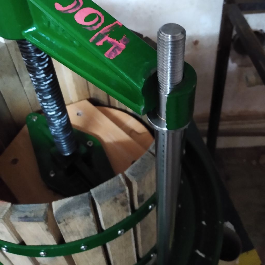

                      Tim, I expect that you're right. I'm doing this work at a distance, so haven't seen the machine 'in person' , but the yoke is cast iron for sure.
                      Among the first responses was this from Jason:
                      Posted by JasonB on 05/03/2020 07:09:03:
                      Can't help thinking that the top yoke casting will fail at one of the ends long before any steel handle, expect its remelted scrap iron and not SG Iron.
                      I think Jason probably identified the source of the eventual 'bang':
                      However, as I think I've said before, the question I was asking in this thread wasn't really to do with beefing up the press, it was more about clarifying my ideas about bending and shearing, using this project as a practical example. Thanks to the discussion I'm getting there.
                      I think I'm probably done with this project – the client's response to my suggestion that replacing the crossbar with a longer single-ended handle would create more problems than it solved was muted. But if I get further feedback I shall report.
                      The nice brazed joint on the post is thanks to advice from this forum – the jaw marks are all my own workblush.
                      Robin.

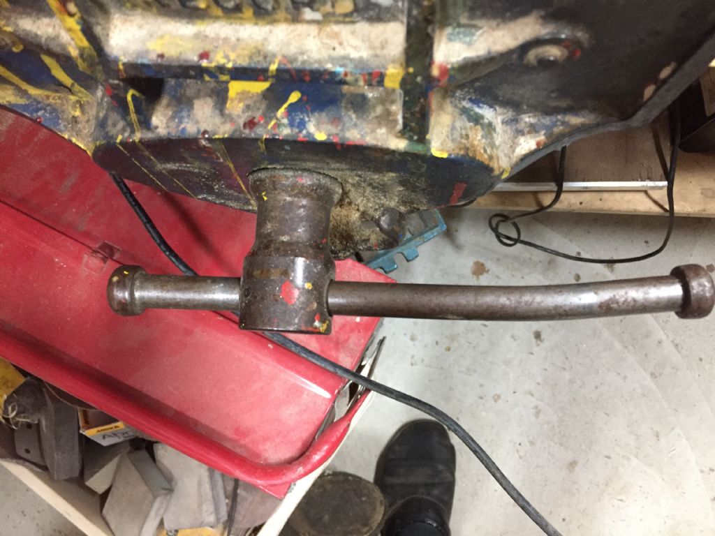

                        I wonder if the press is like many bench vices where the handle is deiberately designed to bend before any other component fractures?

                          It would be nice to think so Hopper, but I doubt it. The reason I was asked to make a new post was that when tightening down the yoke on the post, the yoke jaw would slip out of engagement, which resulted in a thread mangled beyond redemption. Partly operator error I suspect, but I did get my hands on the original post and the metal was pretty cheesy. If they can't get that right they may not have calculated everything out…
                          I didn't know about that deliberate design of vices – I picked up a Record 53E for next to nothing because of the bent handle:
                          It was a punt, I thought it would might well be knackered after that abuse but it works fine. So maybe Record designed it that way. Quite why anyone would have to exert that sort of force on a woodworking vice is a mystery, but thanks for that nugget of info!
                          Robin.

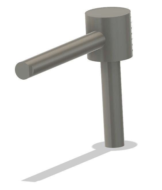

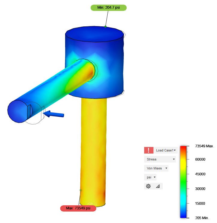

                              I decided to try the FEA facility of Fusion360 on this.
                              I created 2 models. Both with a 30mm diam. boss on the end of a 13mm screw thread. I didn't bother to model the thread so its just shown as a 13mm bar.
                              Case 1. A 12mm diam. tommy bar, 200mm long, passes through a 12mm hole through the boss.
                              Case 2. The hole in the boss is a 12mm socket that 'just' reaches the screw thread. The tommy bar is the same 12mm diam. It fills the socket and extends the same length as one half of the through bar.
                              In both cases I fixed the bottom end of the screw thread and applied a 1000N force to one end the the bar.
                              The pictures show the stress results. The faint dotted lines on the stress diagrams show the greatly exaggerated displacements.
                              Here's Case 1. (I can't put 4 pictures in, so Case 2 is the next post.)

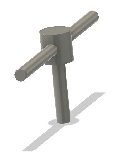

                              #457387
                              Gary Wooding
                                @garywooding25363
                                Here's Case 2.
