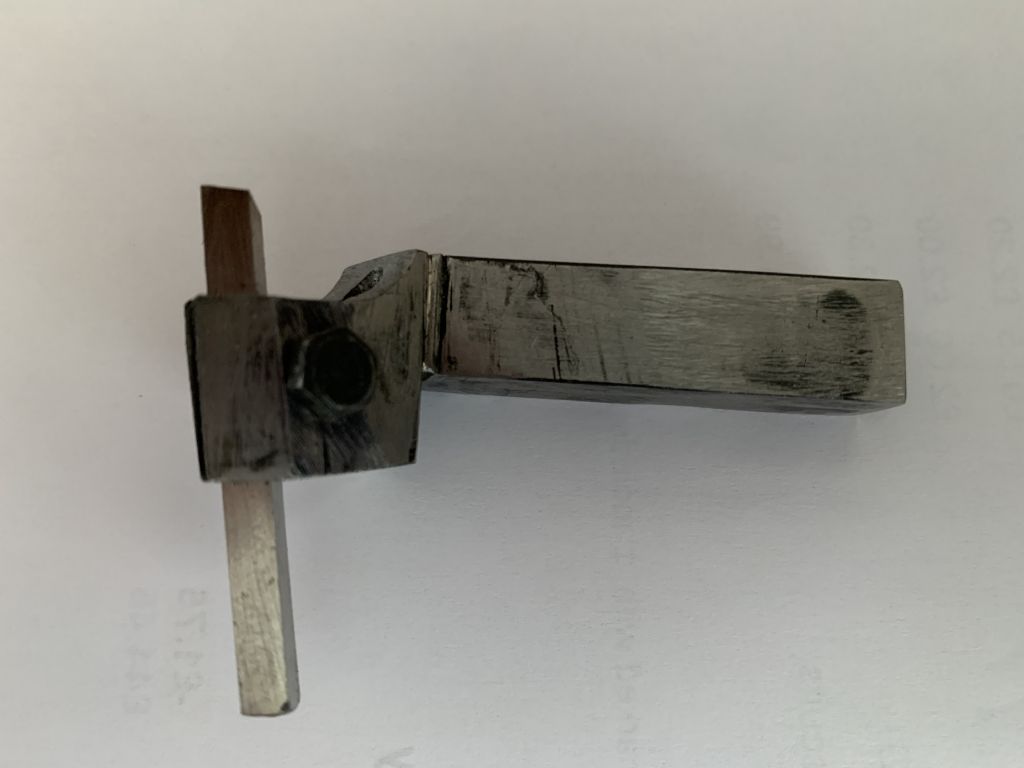

                            #647552
                            modeng2000
                              @modeng2000
                              This is a rather rough tool holder made roughly as I have been describing.
                              It is not very pretty but it cuts mild steel like magic. I think because I wanted to prove my idea that I rushed making it not as refined as I would have liked. Machining the V grove was a difficult set-up because of the combination of three angles. The only way I could do this was to machine the grove before bending the holder, this removes one of the setup angles. Another point I would do differently next time is to have the bolt head on the other side of the holder.
                              Hope this inspires others to have a go.
                              #647613
                              Hopper
                                @hopper
                                Good stuff, well done. A lick of paint and it will look as good as a bought 'un .
                                #647630
                                modeng2000
                                  @modeng2000
                                  I think a polish up would make a lot of difference.
                                  Quite a complicated machining procedure as I only have a mini-lathe with a milling crosslide vice these days. Still it was an interesting experience.

                                    modeng2000
                                      @modeng2000
                                      Howard, having spent some time making this holder and realising some of its short comings I have concluded the Eccentric Engineering design is probably the optimum for such a tool holder.
                                      The reason for silver soldering pieces together is because of my limited machinery. Achieving the compound angles used by the Eccentric holder is something I could not visualise with my equipment so the job was divided into managable sections.
                                      i am quite surprised by the strength of a good silver soldered joint. I would have no concerns about using this method again.
