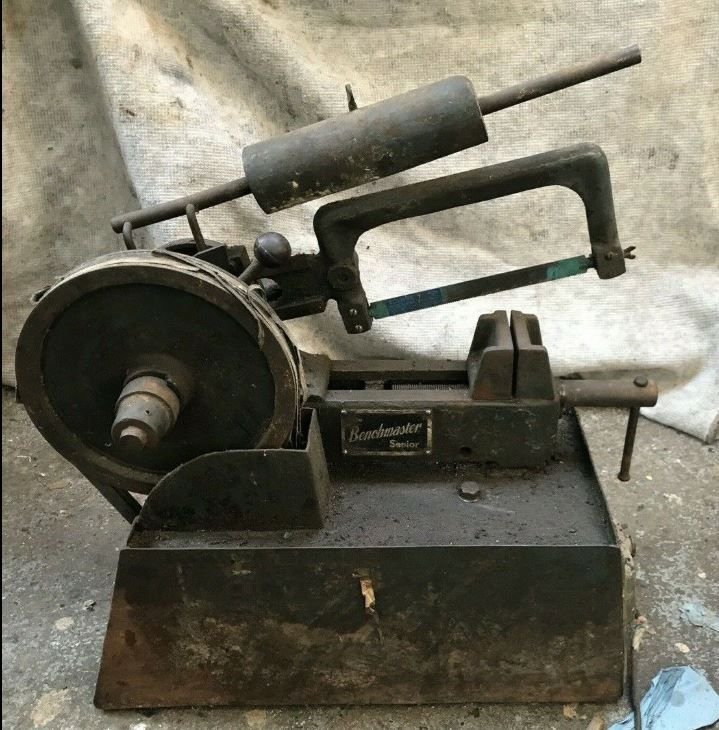

        power saw.jpgI've just bought a rather sad looking Benchmaster Senior Donkey Saw for what I think is a quite reasonable price. It all works, but is in need of some TLC as it's a bit tired after years of use. It's not too big 600 x 200 but still needs two people to lift it.
        The odd thing is tho, that I can't find anything on the web about the makers or the saw itself.
        Just wondering if anyone has any ideas as to its origin. Certainly UK made, but that's about as far as I've got.

          No idea on the history but I have one too, well used but not quite as mucky as yours! Mine has the guard over the pulley which you are missing. Not the most sophisticated of saws. Vice is set at 90 degrees only, and there is no damper or blade lift on the return stroke.
          Uses 12" blades. When the previous owner sold it to me he made a big thing of including a small stock of 12" x 5/8" blades (rather than the more usual 12" x 1/2" hacksaw type) which are a little more robust – he said they were super rare but I'm still using his stash, so never had to search out more.

              A swift google seems to suggest it is a Kennedy product.

                I found this picture which shows a saw with an additional plate from F. J. Edwards of Euston Road but suspect they were just acting as a dealer, their main business being "Besco" sheet metal machinery. Can't help wondering if the name "Senior" suggests there is also a Benchmaster Junior?

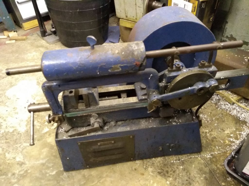

                      As promised here's mine:

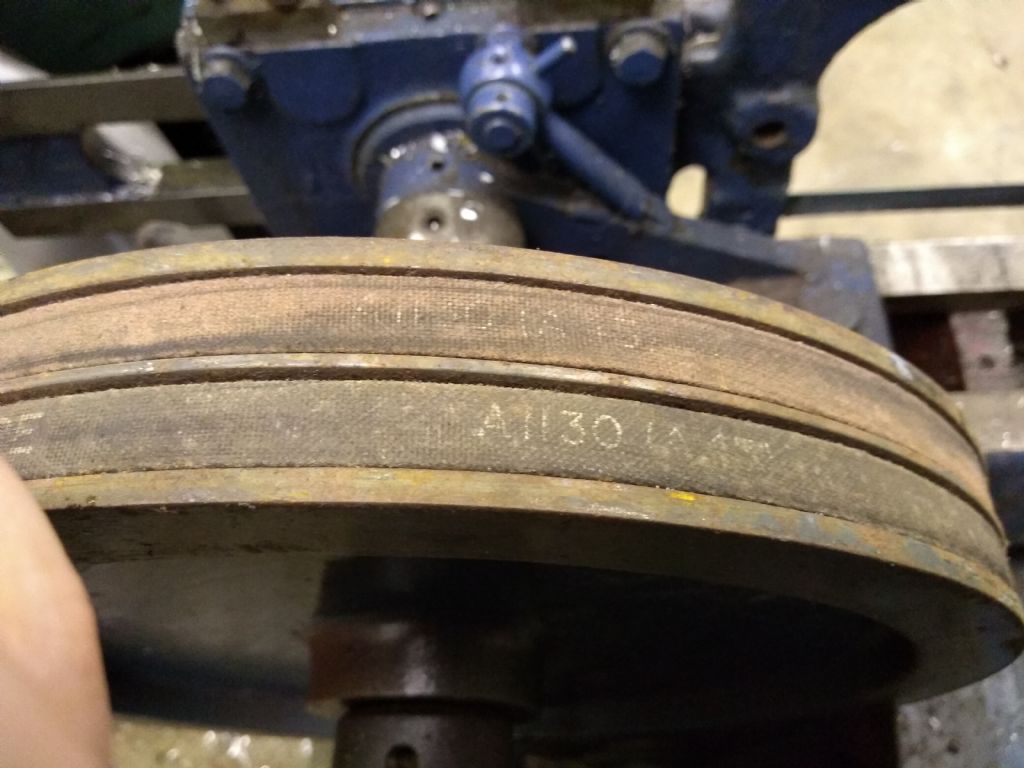

                      Martin asked about belt length for the main pulley:
                      Looks like A1130 to me.
                      Many more photos in my album.

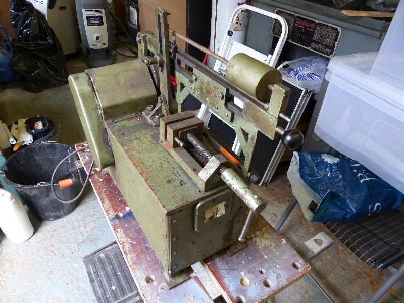

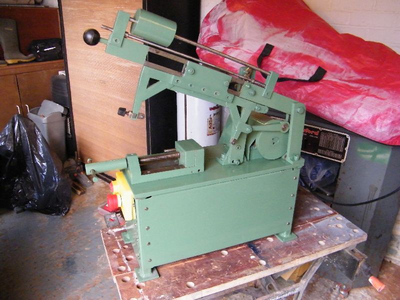

                          Did a saw up recentley, this was a home built one (maybe Duplex), enjoyed doing it, came out well:-
                          1.jpgdscf1057.jpgmore pics in My albums if You would like a look, good look with Your restoration!
