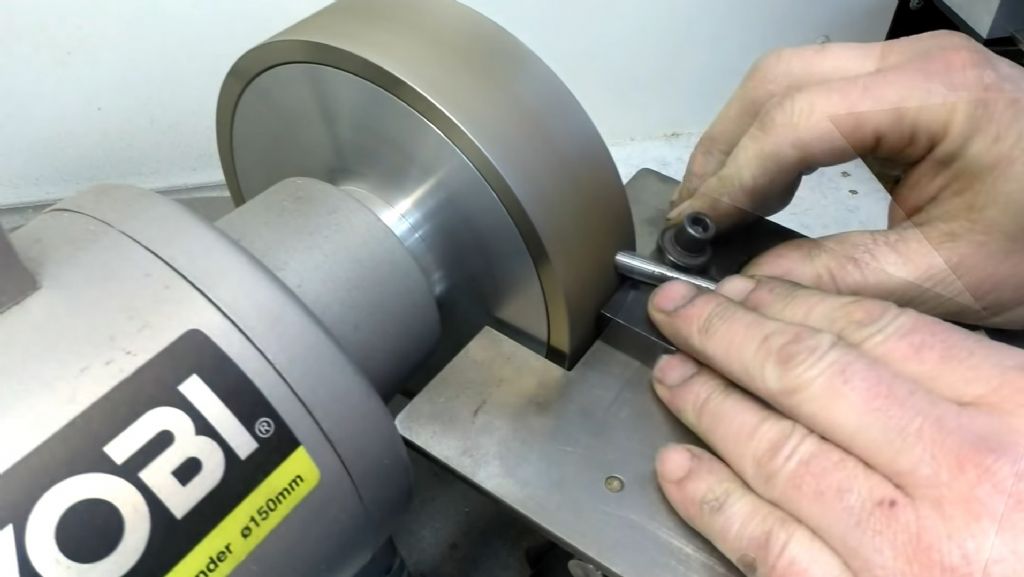

      I was just watching the promo video for the Diamond Tool Holder
      Can any tell me what this Bench Grinder setup is on the Ryobi bench grinder
      The tool rest and wheel type
      Thanks

          It's the table from EE's Acute grinding system; wheel is CBN, I believe.
          Ask Gary for more information.

            I suppose that as a CBN wheel has zero risk of disintegration a guard is superfluous and most of the cut material will be directed downwards. Another good reason to use CBN wheels.

                    That looks like an electroplated diamond wheel rather than a CBN. It could be electroplated CBN of course but typically the CBN wheels are abrasive mixed into a resin bond and rely on erosion to keep them sharp. Electroplated wheels have a thin coating of diamond fused to a metal carrier.

                      That is a CBN wheel, electroplated CBN on steel. I've never seen a resin bonded CBN wheel! If you read Gary's stuff he confirms it is CBN.

                          Thanks for the correction John. CBN is very prevalent in fact a lot of what is called diamond is not natural diamond at all. We use a lot of diamond products at work electroplated and sintered segment.

                              A question that has been aired before: would a diamond wheel be suitable for dry high speed grinding of steel?

                                ega – ..Maybe.. see the 'How to Use.. ..For Best Results' paragraph towards bottom of page..
                                Fortune Tools – Diamond Grinding Wheels
                                ..it gives SFM recommendations for wet/dry – handy..

                                  I invested in one of those large CBN wheels to go with my Acute grinder, got it from Toolpost in Didcot, alas they closed down last September.

                                      There are budget ones Michael, I bought a 8" one for under £50 to use for grinding abrasive stones flat. I also bought a couple of 5" tapered edge ones for my tool & cutter grinder for sharpening hobs. They were just over a tenner each.
