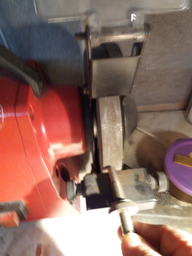

                                        #449377
                                        David George 1
                                          @davidgeorge1
                                          Hi I have a single point diamond with a nut on the stem so I can follow the rest to get a nice straight finnish on the wheel.
                                          David
