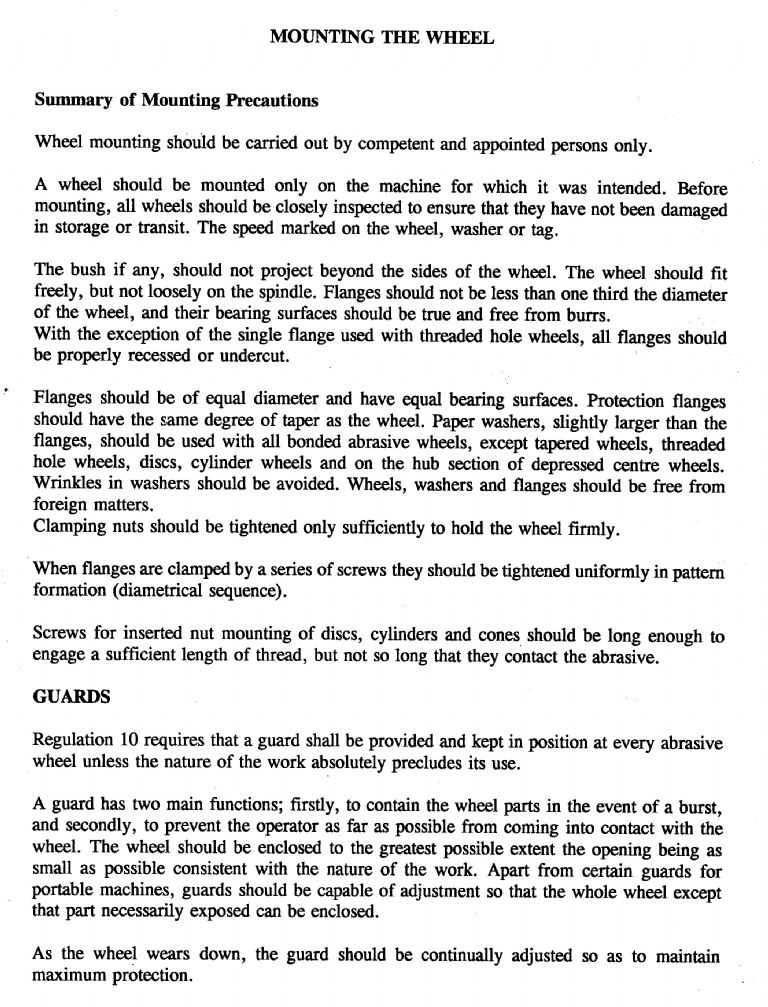

                            #542492
                            Nicholas Farr
                              @nicholasfarr14254
                              Hi, the flanges either side of the grinding wheel should be of equal diameter and have the same bearing surfaces and the paper blotters should be a slightly larger diameter than the flanges. Wheel wobble should be corrected, but not by dressing.
                              Regards Nick.
