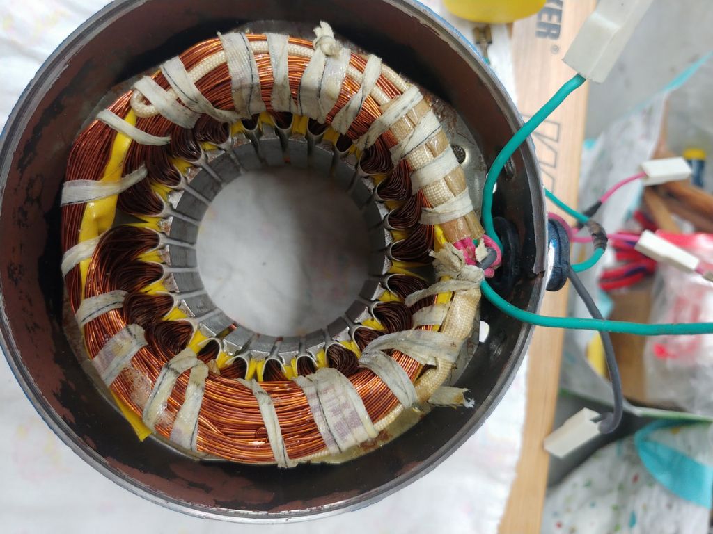

        I've bought an 1998 Elektra Beckum DS 200W bench grinder.
        I was told by the seller that it had never been used. It seems to be the truth, as the wheels appear to be original and are indeed unused, and the grinder itself also looks like new.
        However, when I plugged it in, it failed to start. Spinning the wheel by hand made it start (it took many seconds to spin up to proper speed).
        This grinder has a start capacitor and a centrifugal switch. The capacitor indeed had leaked, and was not holding any charge. I've assumed this is the (only) problem, and ordered a replacement cap (exactly the same model). However, it didn't improve the situation.
        I've then checked the resistances. For the main winding my multimeter is showing 8 Ohms, but there is open circuit between the wire that goes to the centrifugal switch, and the common wire. Making me think either the centrifugal switch is stuck open, or the starting winding is blown. I wonder what would be more likely, considering that the grinder appears to have never been used?
        Is it practical to try and disassemble the motor further to investigate? What would be necessary to do to get inside the motor? Would I have to take off both grinding wheels and motor end caps?

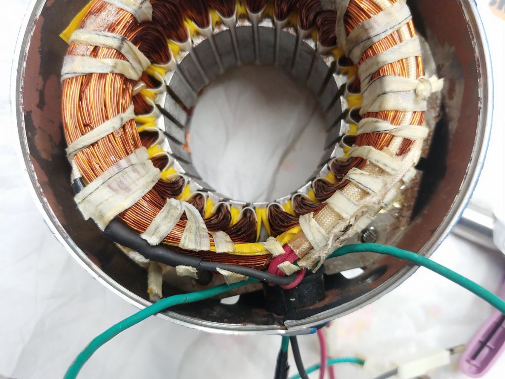

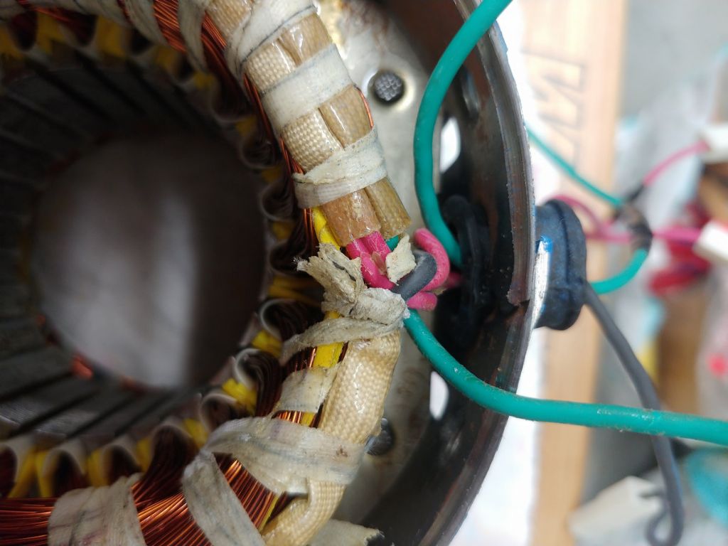

                  Well, I took it apart. Wasn't that hard to do with a block of wood and a plastic-faced recoil-less hammer.
                  Surprisingly, the centrifugal switch turned out to be in order. The starting winding, however, is an open circuit.
                  I've read somewhere that commonly the problem spot can be where the input wire is soldered to the enameled winding's wire. So I cut it open a bit until that spot, however that joint is fine. I scraped the enamel a short distance away from the joint and there's continuity between that spot and the input wire.
                  I am really curious how a grinder that looks like it had not been used, ended up like this.
                  Is it now only good for recycling center? The capacitor and the wheels could be useful (or I can sell them), anything else useful to salvage?

                              I'm in the 'dont give up yet' camp. You've checked one end of the start winding (the green wire), but what about the other end?
                              The windings do not look overheated or burnt and you know it runs if you start it by hand but as it not really a usable machine there is not much to lose delving a bit deeper into the winding connections. If there are only three wire connections brought out then the common wire should connect to both windings. Locating and examining the common point must surely be worthwhile.

                                      Posted by Gene Pavlovsky on 01/02/2020 22:23:21:
                                      That blob of resin on the winding look awfully suspicious ! Could it be covering up a break in the wire ?

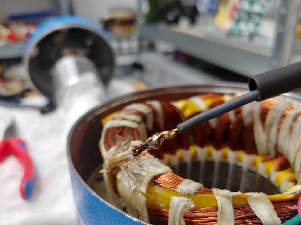

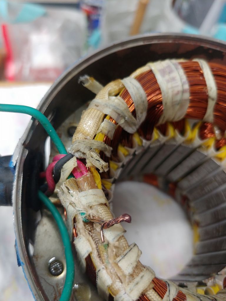

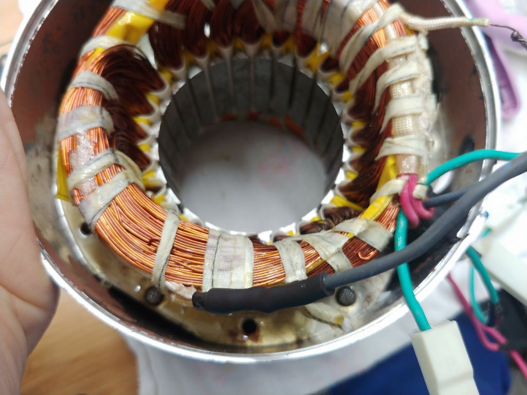

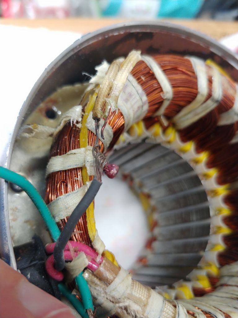

                                        Thanks everyone for the encouragement not to give up. Yesterday I was about to throw it out, but I followed up on the black wire, and indeed there was a break where it connects to the two windings. I also carefully removed the blob of resin mentioned by John Baron, but it was just excess resin, no breaks hiding under it.
                                        The copper was quite oxidized so I cut a portion of both the black wire and the enameled wires, and soldered it all together. I covered it in heat-shrink, and shoved it back where it was.
                                        Both windings now show reasonable values on the multimeter – 8 Ohms on the main winding, 9.4 Ohms on the start winding.

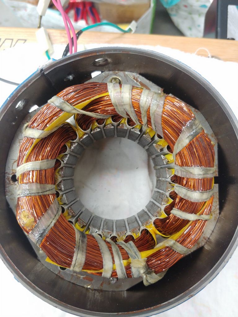

                                        Now to put some finish touches on all of this, before I put it back together… To get to the wires, I had to cut several of the fabric "straps", it would be nice to fix that back somehow, to immobilize the soldered joints (to prevent them breaking later due to vibration etc). I've noticed that all the materials used there seem to be high-temperature resistant, e.g. the wires insulation is silicone, not PVC. I bet the fabric straps are some sort of high-temp fabric (perhaps fiberglass), and the lacquer/resin that everything is covered in, would be some high-temp type as well. I am now wondering if the heatshrink tube is heat-resistant enough, and what would be best to use to do a proper job of securing the wires? I have e.g. polyurethane glue, acrylic lacquer, regular epoxy (the common double-syringe dispenser), polyester epoxy usually used with fiberglass mat for fixing bumpers / making fiberglass parts.

                                          Of your list of repair materials I would probably use one of the epoxy ones. The heatshrink will be OK if the joint and wires are then smothered in epoxy. The woven tape in the pictures may be fabric based or glass tape but for your repair you could use any thread or twine to hold everything in place and augment it with the soaked in resin/epoxy.

                                            So very glad that you have found the break and repaired it. yes
                                            The two part epoxy should be OK and dental floss would work to secure things.

                                              The wiki article about magnet wire mentions "Older insulation materials included cotton, paper, or silk, but these are only useful for low-temperature applications (up to 105°C)."
                                              The data sheet for the epoxy says max operating temp is 100 C. So that would be a weak spot in the motor.
                                              Perhaps a high-temp silicone sealant or a high-temp automotive lacquer (engine lacquer, brake caliper paint, exhaust paint), stove paint or some other product I can buy?

                                                    Great! Perseverance pays off!
                                                    If the connection was poor from the outset, it would have tended to run hot and oxidize – a vicious cycle until failure. Not an uncommon scenario – thinking in general, not just motors. To re-phrase what I said before, all connections are suspect until proven otherwise.
                                                    I wouldn't worry about temperature. Old stator windings would have been bound with linen tape. Modern, warm-running, totally-enclosed, fan-cooled motors can run with a case temperature around 60C. I think that exposing the insulating varnish to various solvents, resins and other chemicals is living dangerously. Epoxy should be safe enough, however. Beware silicone resins also – most evolve acetic acid during the curing process. So-called 'Neutral Cure' types are available, however.

                                                      Use some cable Ties to hold your repair . Looking at your pics I guess the windings are solid hbecause of the age they used to dip these in a type of shellac and then bake in a oven to dry . Most new motors today I have seen Are just wound and tied or laced together and are not shellaced . Sounds very good will now work ?. Motors today cannot be rewound because they weld the cases together . A throw away society
