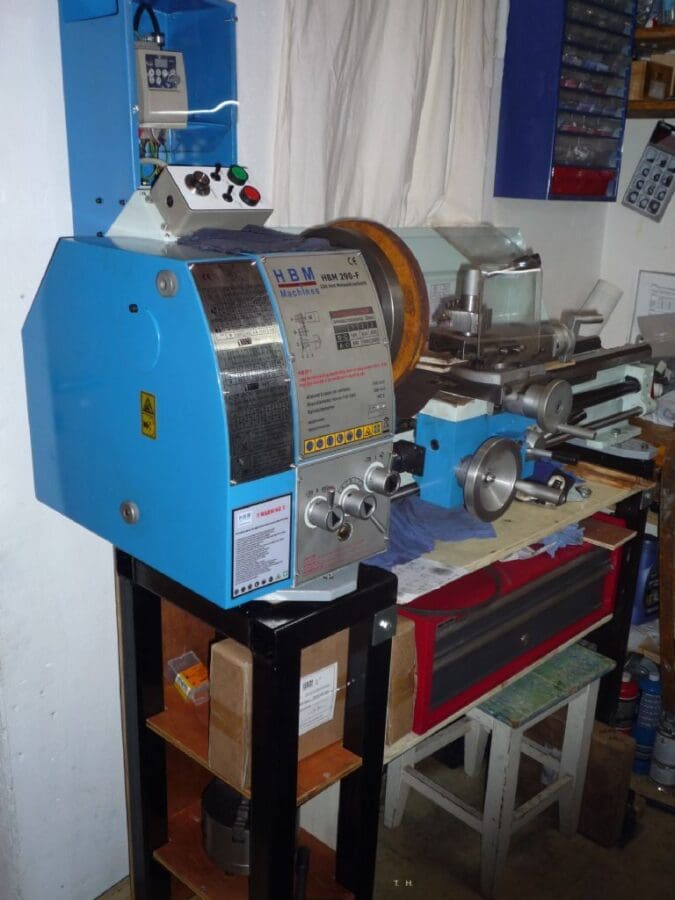

          Thor 🇳🇴
            @thor
            I have a slightly heavier lathe at approximately 210kg and made my own steel stand for it – see photo below. I agree with Bazyle that a railway sleeper isn’t the best choice.
            Thor

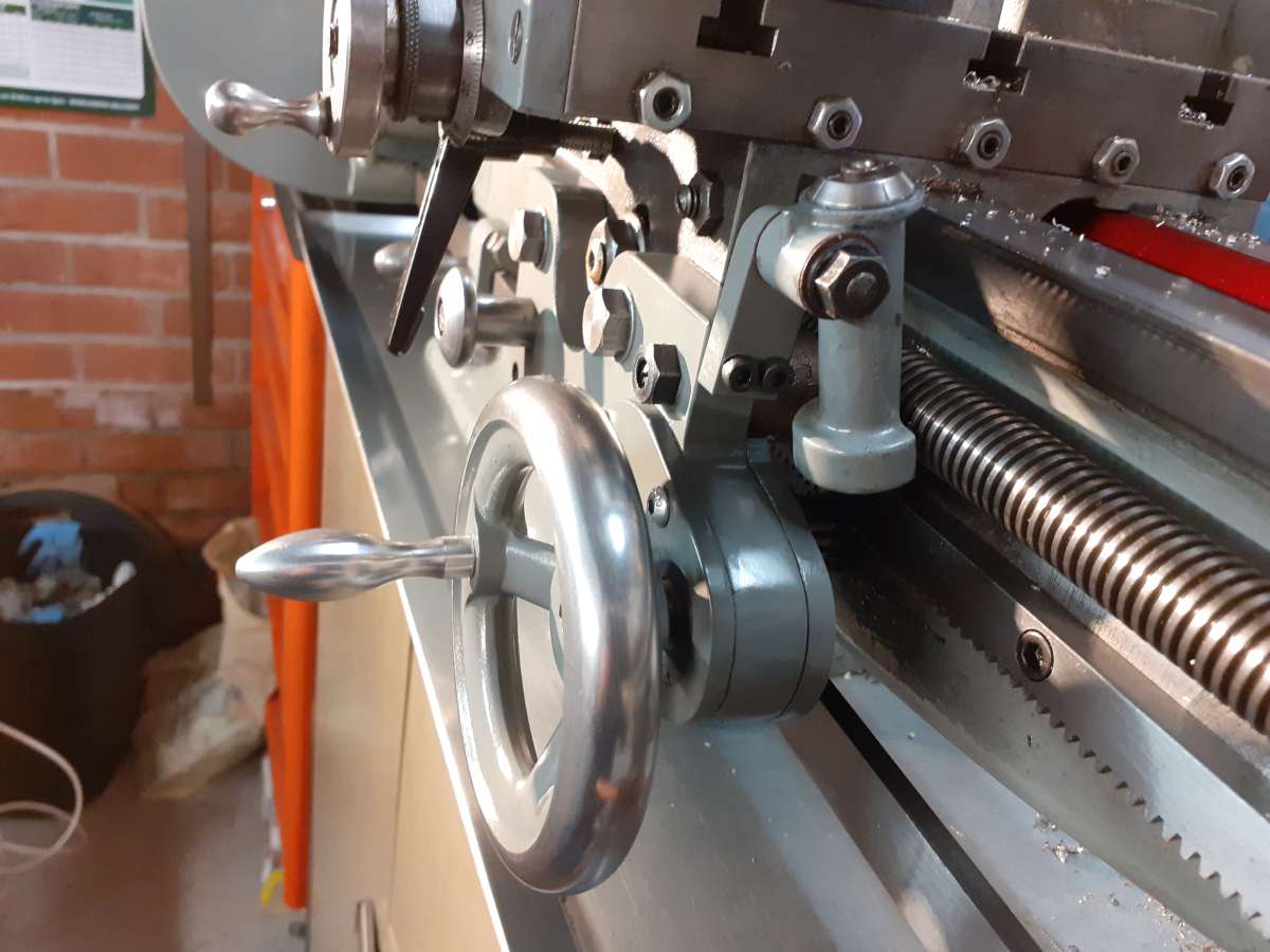

                David George 1
                  @davidgeorge1
                  Hi  Rich I have a metal cupboard with an additional 3mm steel top with upturned angled edge  to collect swarf and oil but easy to clean and clear. Loads of room for chucks and tools etc in the cupboard and sturdy.
                  David
