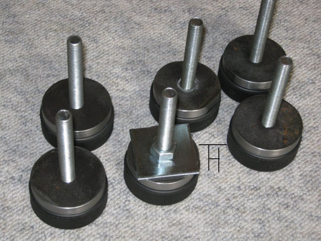

                  soon after reading your post, I bought 6 (4 of them will be used to make levelling feet for my milling machine) smiley.

                        Hockey pucks are great – and they machine beautifully. I'm making some feet for my surface grinder right now.

                            I used hockey pucks to make levelling feet for my lathe several years ago. Here is a photo of I took during the fabrication (not yet finished):
                            The pucks are easy to machine and has served me well for many years.
                            Thor
