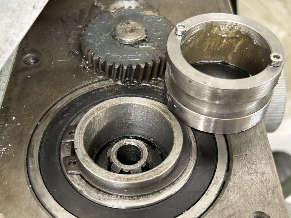

              Brian, I don’t want to rain on your parade, but  take the top and motor plate off your WM16 to expose the spindle drive shaft to check. If yours looks like the picture below, then you have no chance of using the Bilici mod.
              Basically, the hollow spindle drive shaft terminates about 2mm above the bearing. The extension to the drive shaft is just a bush and is only a pressed in fitting that clings on with about 2mm of overlap. The bush has been removed to the two o’clock position in the picture. It doesn’t take much to remove, which is OK because it is only used as a carrier for the slotted speed sensor ring.
              As his belt mod relies on securing the drive pully  to the spindle drive shaft, the problem is immediately apparent – in this version of the mill, there is nothing secure to secure the pulley to! We had a lengthy exchange of e mails before coming to the conclusion that his particular mod cant work on this incarnation unless you want to fit a shaft extension inside the drive shaft and lose the quill operation (some of the CNC boyos do use that method, but it would be no use to me).
              I recently had a major rant about it all on one of the threads if you can be bothered – cant remember exactly title possibly  – Warco mill lubrication – or something similar. Resigned myself to inevitable and spent the money on a better set of ear defenders.
              But don’t let my negitivity stop you from going down the rabbit hole.

                Thanks for responding, doing away with the quill operation is acceptable for me as my machine has a CNC conversion. I had started to draw an arrangement using an expandable sleeve to grip the inside of the main drive tube. If there are no better options before the drawing is finished, I will make a start on machining the parts. I love starting new projects.

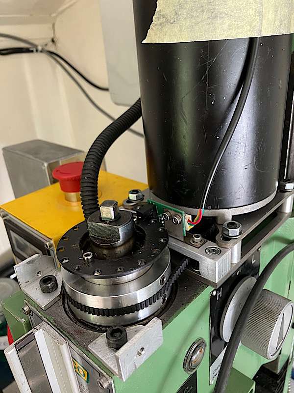

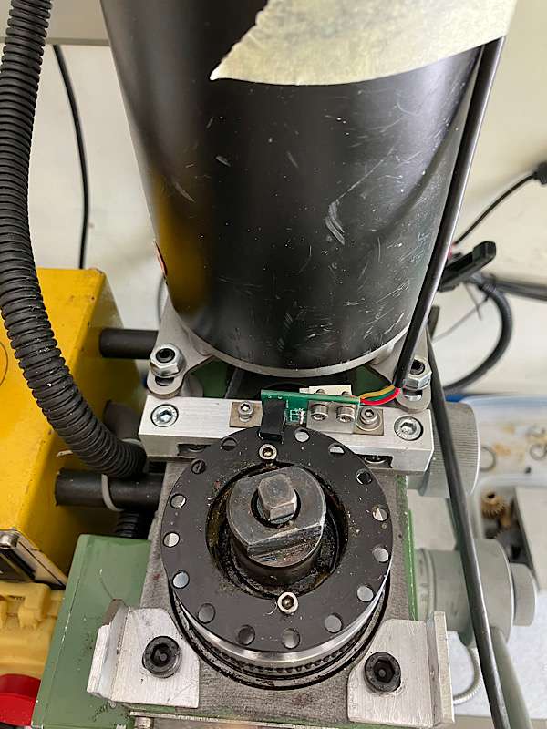

                  I have his kit on my Warco WM12 and Murrat didn’t have a kit for it so he designed & made it to my measurements, we must have had 100 emails going back and forth with pictures and measurements but I can’t fault the kit or Murrat for that matter and I must admit I was a bit sceptical dealing with someone in Turkey but needlessly as it turns out.
                  EDIT I can still use my quill
                  PS if you contact him please say Dell said hi.IMG_2559IMG_2555IMG_2024-05-01-164234
