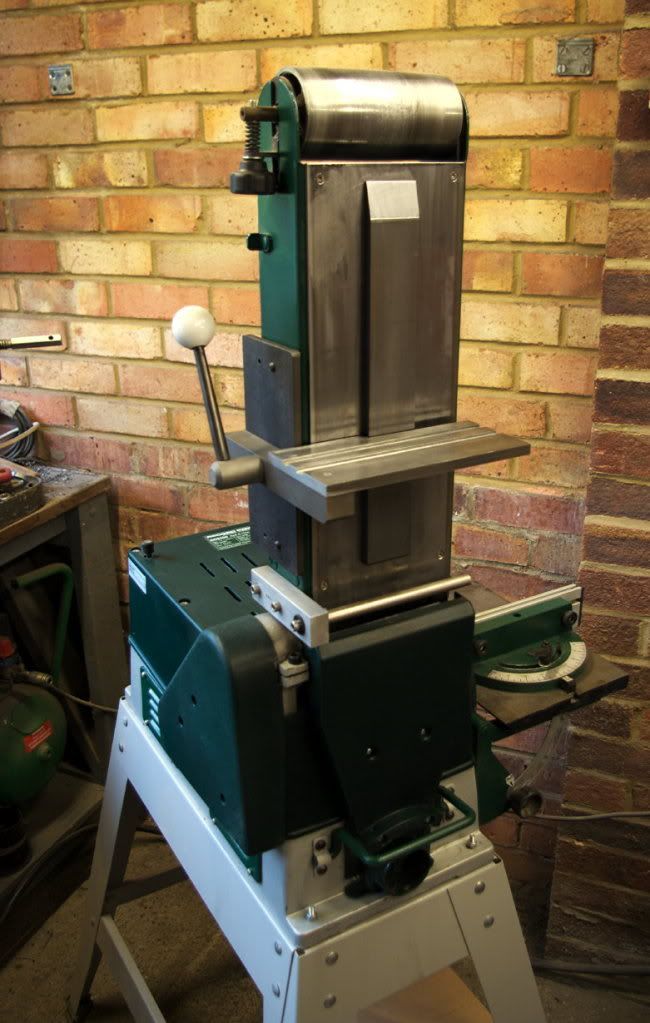

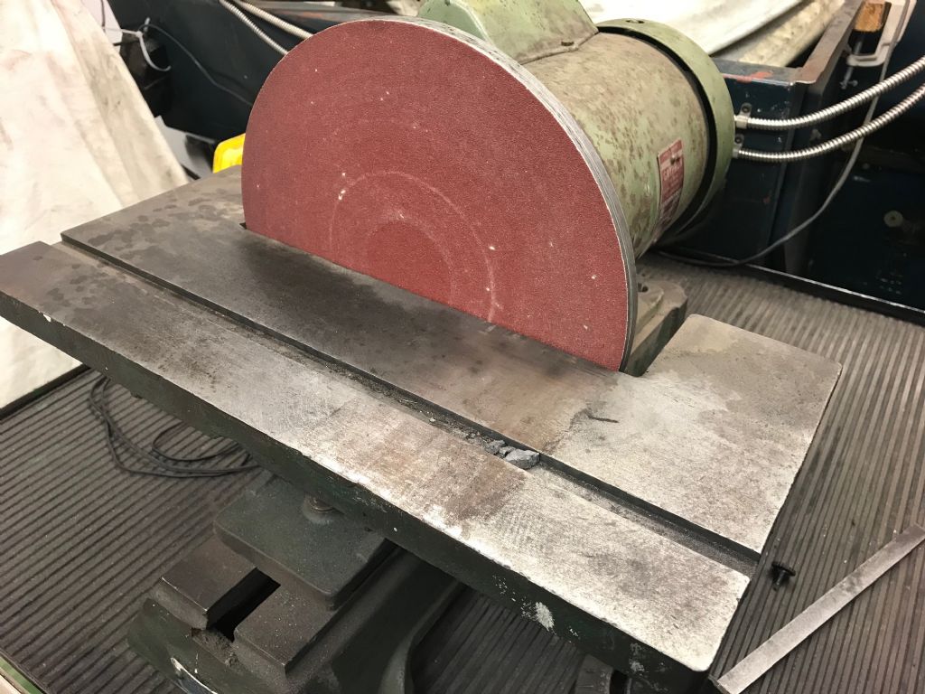

                  I’ve been using a Record Power BDS250 for tool sharpening for many years. I made a proper adjustable table for mine. It’s only fairly recently been retired in favour of an Axminster Ultimate Edge. Mainly because I can get a greater variety of belts for it.

                    This is my BDS250. As well as making a proper table I also added a supplementary removable 50mm platen specifically for tool sharpening. 150mm belts are easily split down into three 50mm ones. The rod at the bottom was used for a woodturning gouge jig.
                    My newer Axminster Ultimate edge has variable speed and forward and reverse which is very handy. And accepts jigs for a variety of different vendors.
