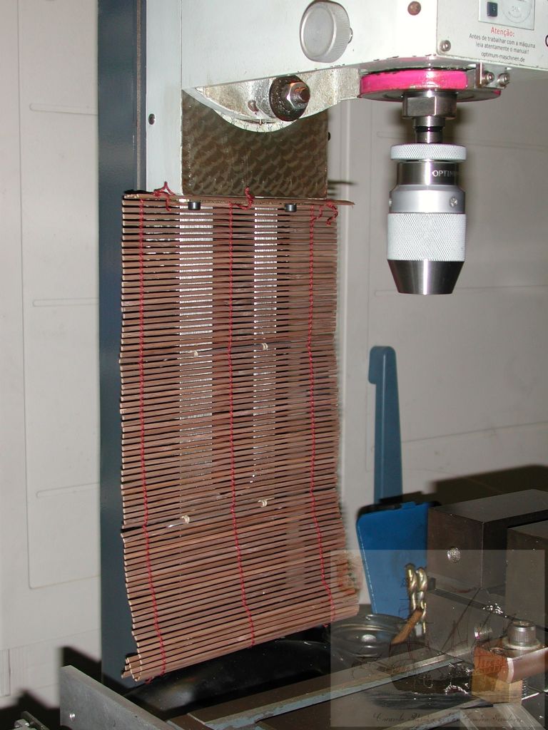

      Hello all,
      My milling machine is an Optimum BF20 Vario and its vertical guides are originally protected by a bellows.
      After some years time, the oil separated parts of the protection which were bonded and now the protection is unusable and the oil prevents re- bonding.
      So, I ordered the distributor of Optimum in Portugal but as a new bellows takes a long time to come, I decided to look for an temporary alternative.
      And I came to the following temporary solution:
      1 – Purchased a shutter from Chinese origin for 4.00 Euros which is described as being made of bamboo ( see **LINK**).
      2 – Using scissors I cut out a portion covering the area of ​​the column from the milling head on its highest point to the lowest point (see **LINK**).
      3 – Redid the knots of the cotton line connecting each element of bamboo to the next (see **LINK** ).
      4 – Made three pieces in wire (with wire from a hanger made for my shirts) to guide the shutter and tied each of two points to one of the elements of bamboo (see **LINK** and **LINK**).
      5 – Finally fixed the small shutter by its top to where the bellows were tied. Did not tie the lowest part hoping that the weight of the assembly keep the shutter taut (see **LINK**).
      See other pictures, please, in the **LINK** album.
      So far it has worked well and prevented the chips pass to where I do not want to have them.
      There are clearly improvements to make on this protection and the amount of shutter that still allows me to have all the tests that I want…
      Best regards
      Dias Costa

          Nice one – but doesn't the swarf stick to the sushi when you roll it?

              Perhaps adding very thin plastic to the back or between two layers would also keep out the finer stuff. It does look like a nice solution to other chip control problems like the sides as long as you don't need to see through it.
              For faster delivery I believe one of the site advertisers does a range of bellows.

                Added bonus..easily moved to allow cleaning if required…
                Many auto matics used something like “tank” track to cover ways again just liftup and clean IF required..usually worked so well but brass swarf gets every where

                            Russel: Nice one – but doesn't the swarf stick to the sushi when you roll it?
                            DC: No. This risk exists because I eat and work at different times.

                            Bazile – Perhaps adding very thin plastic to the back or between two layers would also keep out the finer stuff. It does look like a nice solution to other chip control problems like the sides as long as you don't need to see through it.
                            DC: In my opinion, the use of plastic is a good idea, but not sandwiched because the result would be too thick. But the plastic can be sewn in some points of some elements of the shutter. Or alternatively the length of the blind may be dimensioned so that the elements are closer by their own weight one over the other.
                            Bazyle: For faster delivery I believe one of the site advertisers does a range of bellows.
                            DC: Yes, you're right. ArcEuroTrade (AET) is one of those advertisers and has a very fast delivery system. It's a pitty it's not cheaper! It is a pity that the dimensions of the bellows they sell are not compatible with my milling machine.

                              Jason Udall: Added bonus..easily moved to allow cleaning if required…
                              Many auto matics used something like "tank" track to cover ways again just liftup and clean IF required..usually worked so well but brass swarf gets every where
                              DC: Yes, you're right. Not forgetting that furthermore is very easily (and cheaply) replaceable.
