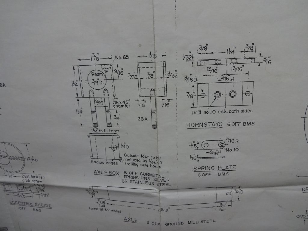

          This is the axle box. Note the lubrication hole is offset.

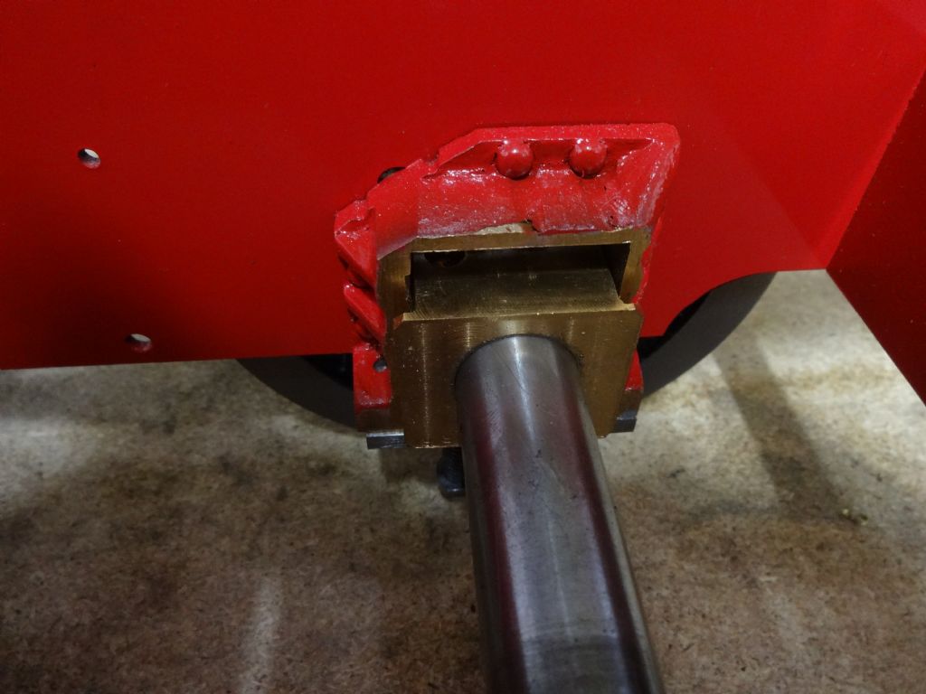

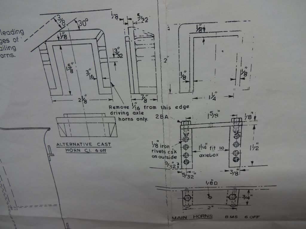

          These are the horns. You have a choice. The cast ones have no hole for getting oil to the box. The fabricated version has a 1/8’’ in the centre of the keep NOT above the oil hole and no explanation as to what it is for.
          This is the actual horn and axle box and the oil hole is in the gap. This is the rear driver which will, if it ever gets that far, be hidden under the boiler and behind the side tanks. Good luck getting an oil can in there. Lubrication of the axle boxes is pretty fundamental!axle box simplex 1.jpg
          If the axle boxes are lubricated from the tanks referred to what size pipe? Does it rely on gravity? Where do the pipes run so as not to interfere with any other part of the mechanicals. Straight forward for a novice?

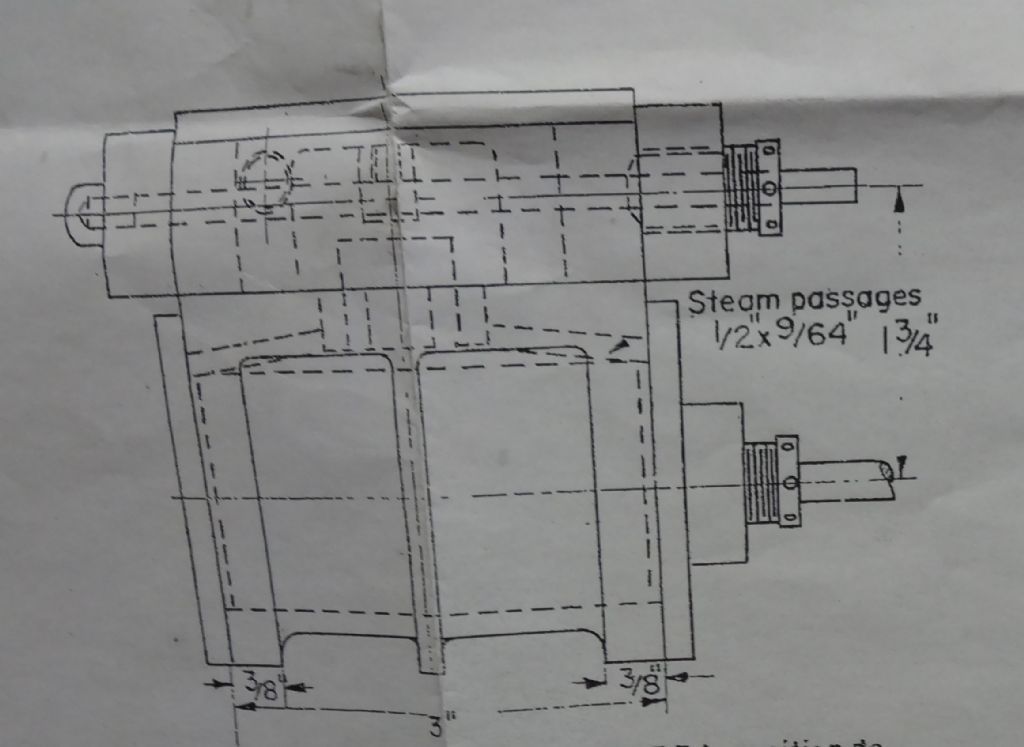

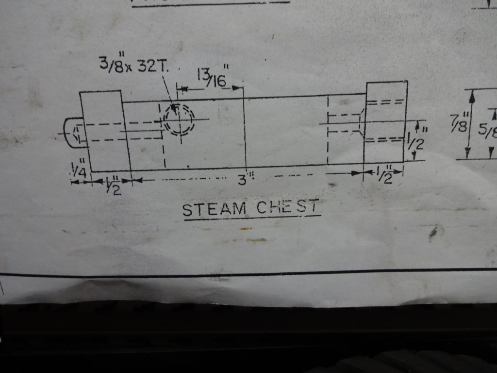

                  This is the full size drawing of cylinder and valve chest, notice the vertical line in the bore of the boss. To a novice is that important and if so what does it represent:
                  This is the full size drawing of the valve chest on the same sheet:
                  That line must have been a draughtsmans smudge ‘cos it has disappeared. Note to novice – ignore it.
                  Can you see any screw thread? The builder of my Simplex 2 could not either and made a close fitting insert to slide in the valve chest with a blind hole for the valve rod. No fixing shown and of course as soon as air pressure is applied the insert shoots out. Cured by some Loctite high strength retainer. However this design is contradicted by Martin Evans in the text where he says “This end must be tapped and plugged, using 7/32” x 40T tap if available, otherwise open out the last 3/16” to 7/32” and tap ¼” x 40T”. A contradictory case of do as I write not as I draw!
                  This is what the valve chest drawing should look like, taken from Terrence Holland’s series on a Fairlie Complex based upon Simplex running gear:
                  Keep calm and carry on!

                    Posted by Old Crock on 28/05/2020 21:47:18
                    At a guess, I'd say it represents the end of the valve rod, which is included in the cylinder arrangement drawing.
                    Clem

                        The "draughtsmans smudge" is clearly the end of the valve rod. The upper drawing shows the rod in place and the rod terminates inside the boss with a little space between the ebd of the rod and the bottom of the blind hole in the boss.
                        In the lower drawing, the "draughtsmans smudge" dissappears because the drawing does not show the valve rod in place, or the slide valve, or the packing nut.

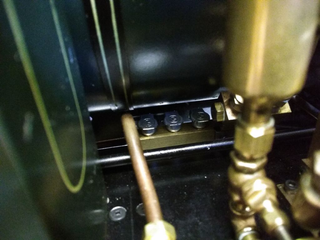

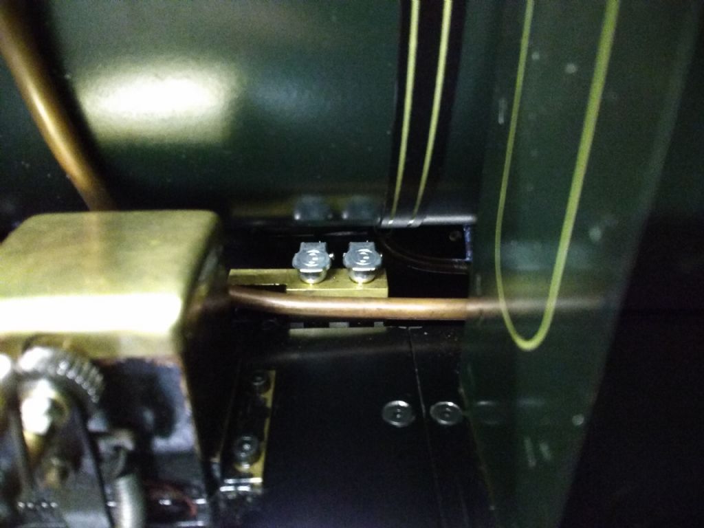

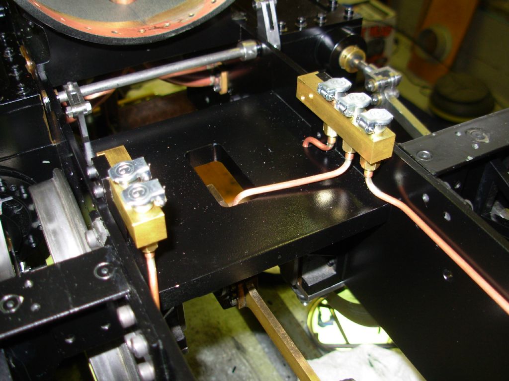

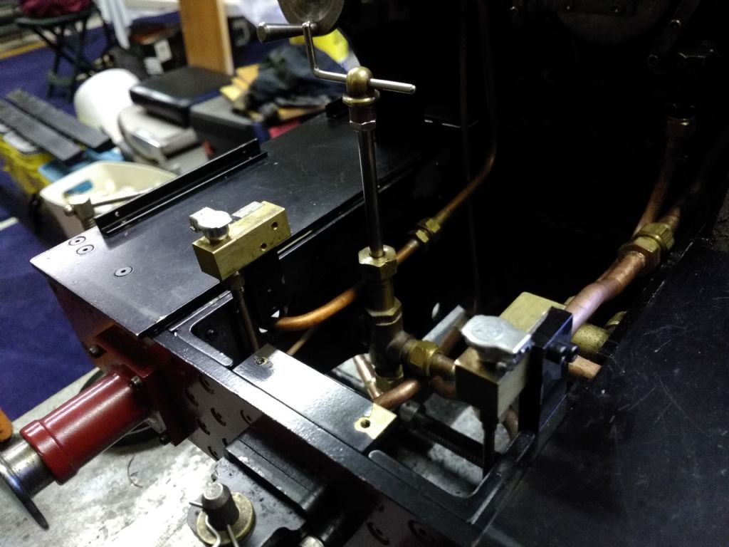

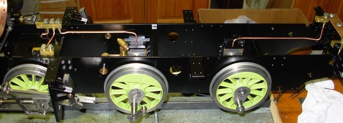

                            Having built a Super Simplex, it is not perhaps a "beginners" locomotive, but, it certainly can be treated as a first locomotive for a model engineer with some experience. I would probably never recommend building a locomotive as a way to learn model engineering, the learning curve would be pretty steep this way. An easier way to start would be to build a stationary engine before moving on to a locomotive.
                            The "simple" thing about Simplex, is that it is devoid of all the detail components that can make a locomotive build seem to go on and on forever. It is designed to get you on the track in the least amount of time with a locomotive that has a real locomotive style boiler and valve gear that operates much like the full size and can be notched up. Six driver wheels for plenty of traction, and no tender to build. A freelance design that can be made as detailed as the builder chooses, or, just as drawn. Yes, there are problems with the original Simplex, and some of the issues were addressed with the Super Simplex.
                            I got my chassis running on air in 9 months and running on it's own steam on my club track in 23 months.
                            As for getting oil to the main bearings, yes, there is nothing about this in the drawings, only the oil holes in the axle blocks and in the horn block castings as shown in the Super Simplex drawings. I created mounting blocks for oil cups and made 3/32" pipes to connect the oil cups to the horn blocks to allow the oil to drip in to the cup on the top of each of the axle blocks. I added a small wool punching in the oil cup so all the oil would not run out. The forward, center axle and eccentric strap for the axle pump have an oil cup mounted on a little block tucked under each side of the boiler. The aft axle has oil cups mounted on blocks inside the cab. A long spout oil can and a stick to open the lid of the oil cup makes it actually easy to oil all the main bearings and the axle pump strap.
                            This oiling system I installed a year after the locomotive was built. Not hard to retro-fit. The first year, I simply oiled up in the steaming bay from below with a long spout oil can.
                            Edited By David Wasson on 28/05/2020 23:57:00

                              Great photos David thumbs up I've got lots to think about. These are all future problems but worth understanding early on in the build so I can prepare.

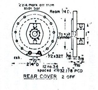

                                        Iain I see that you are only working from the drawings from GLR. I assume they are the same as mine originally from Nexus. When drilling the frames don't forget the 3/16" reamed hole 4 3/16" ahead of the centre axle and in line with the weighshaft. Your drawings will give you no information what they are for! They are to line up the pivot points in the motion plate link brackets, something which Martin Evans failed to mention until "a large number of builders of Simplex have been after my blood the last few weeks".
                                        In the original build in ME this appeared six months after he described the motion plate and link brackets, where he said to locate the motion plate, pull the crosshead right out, slip the motion plate into position and allow it to assume its natural position relative to the slide bars. Fix in this position. This is repeated in the book. No mention that I can find of those little 3/16" holes. In the later admission he says of the large number of builders "They complain that the slide bars are 1/8" too short! Unfortunately for me, I have been telling these good folk that the mistake is not mine, when all the while there has been an error, though not actually in the length of the slide bars themselves". He goes on to explain that error is in the distance of the rear edge of the motion plate from the centre of the driving axle.
                                        This error was caused because he left the drawing (on cartridge paper with a 6H pencil) in the sun and it shrunk. One of the first things I was told in this hobby was never measure from a drawing!
                                        Anyway we are getting ahead of ourselves. Before you get to the motion plate and valve gear you need to tackle the rear cylinder covers! This is the full size drawing

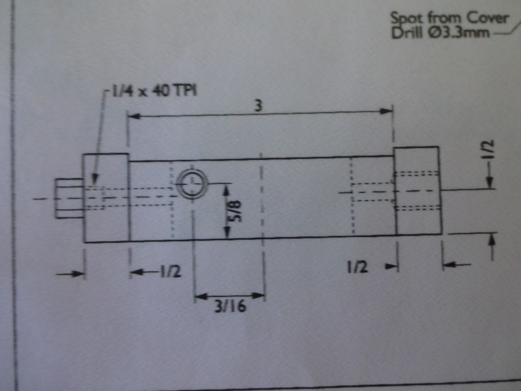

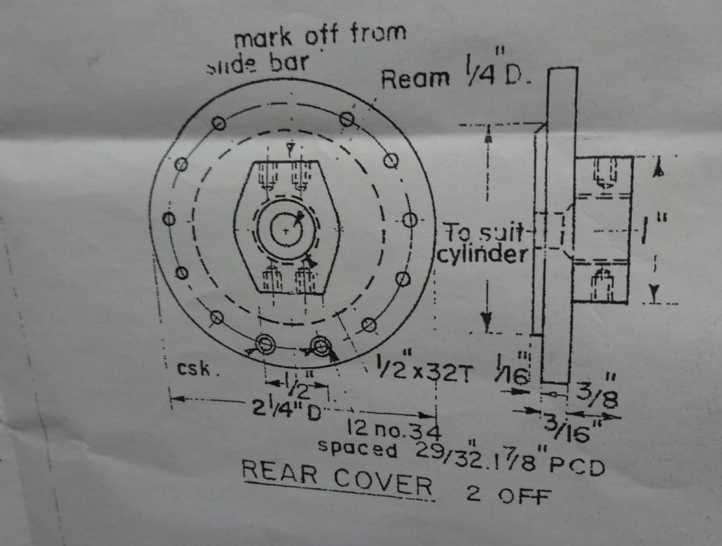

                                        This is the same item in the book with two 2BA bolt fixing for the slide bar:
                                        And this is the slide bar:
                                        Why is there a .010 relief? No mention of threaded hols for the rear of the slide bar where it fixes to the motion plate.
                                        Enough of my whinging. The Simplex will work but not "out of the box". A beginner will need help, possibly lots of it..
                                        My conclusion is that the drawings and write up were a mixture of original work and copies from other designs and they lost, in video terms, a little in continuity.
                                        Keep going though Iain and do let us know how you get on. Good luck.

                                                    @davidwasson11489
                                                    The eccentric is mounted on the front axle. There is plenty of room for the eccentric strap.
                                                    #478623
                                                    Jon Cameron
                                                      @joncameron26580
                                                      Posted by David Wasson on 08/06/2020 17:04:10:
                                                      My appolagies, must have been having a bad day yesterday. Don't know how i missed that??
