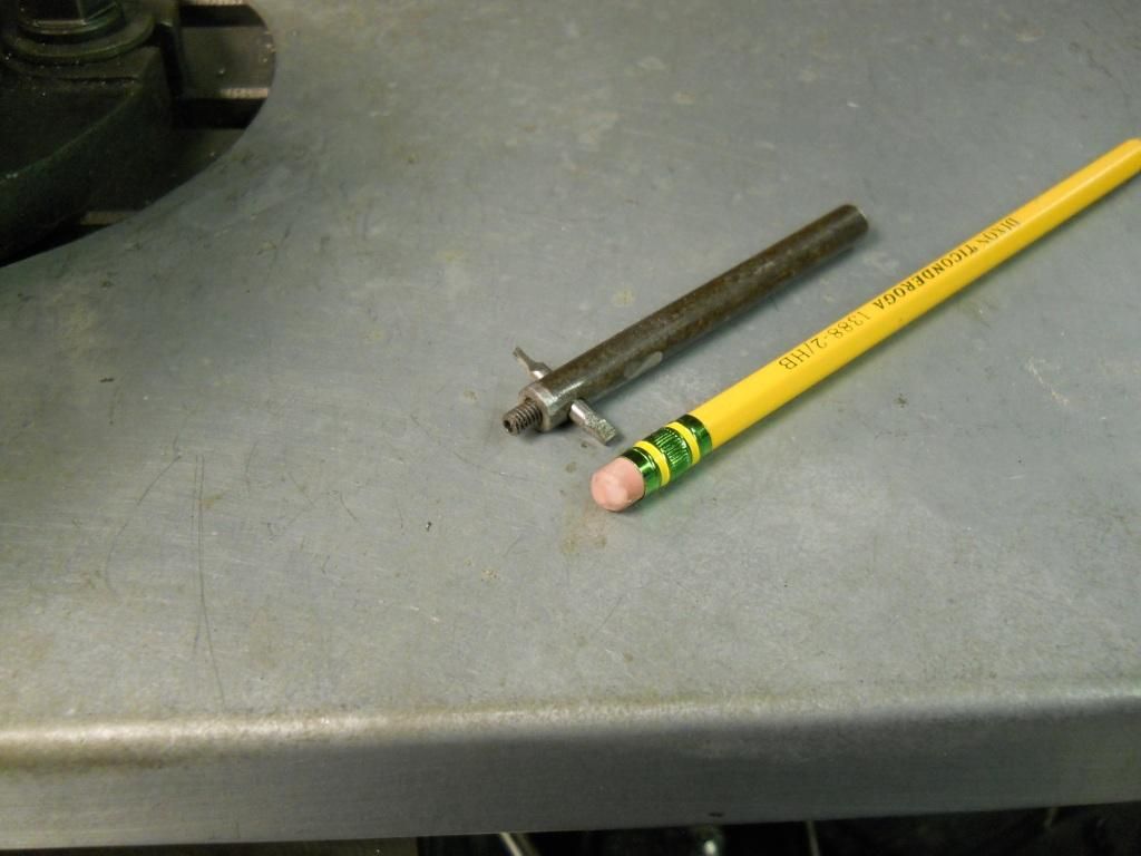

                                    #500992
                                    Jeff Dayman
                                      @jeffdayman43397
                                      A tailstock die holder, pin and centre punches, boring bars of various types, and grooving tools as shown below are all easy but very useful beginner level jobs. The grooving tool can be made from any scrap of mild steel bar that fits the hole to be grooved, the cutter can be made from a broken tap or twist drill, held in place by a setscrew. Flip the cutter over and you can groove outside dia's for e-rings or o-rings grooves too.
