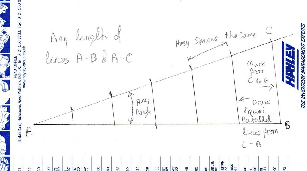

                        Nicholas Farr
                          @nicholasfarr14254
                          Hi, in answer to Gary Wooding's question.
                          To divide line A-B equally, draw a line A-C at any angle to line A-B, mark off line A-C by placing a straight edge square to line A-C and starting at point A, then draw a line from C-B followed by lines from the other marks on line A-C to line A-B and parallel to line C-B.
                          Regards Nick.
                          Edited By Nicholas Farr on 16/04/2022 12:03:57
                          #594681
                          John Doe 2
                            @johndoe2
                            Sorry, I am missing something in your explanation.
                            Gary says just a pencil and a straight edge, How do you get the equal spacing of the points on line A-C with only those?
                            How do you ensure a straight edge is exactly square to anything?
                            With only a pencil and a straight edge, how do you ensure that all the lines between A-C and A-B are truly parallel – for any spacing?
                            Apologies for being dim !

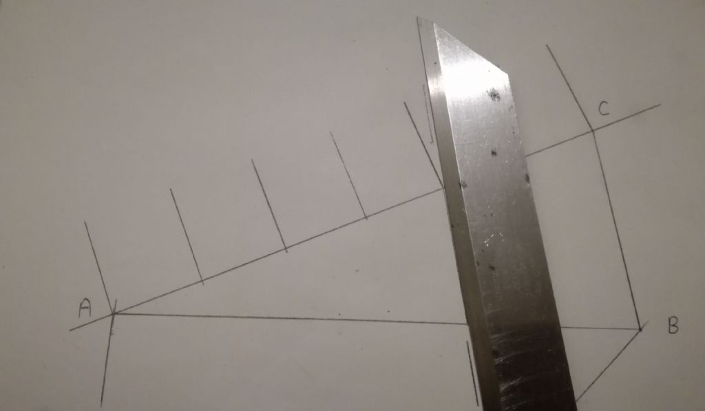

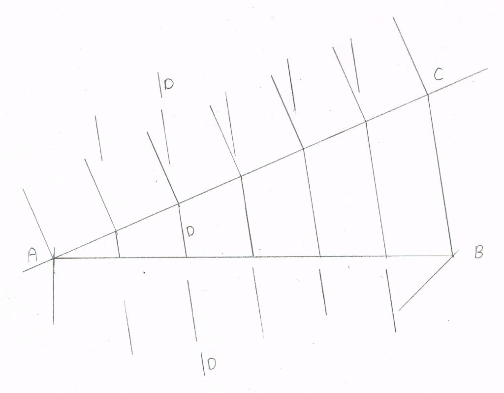

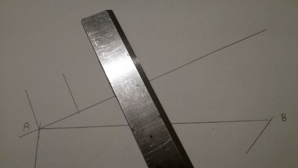

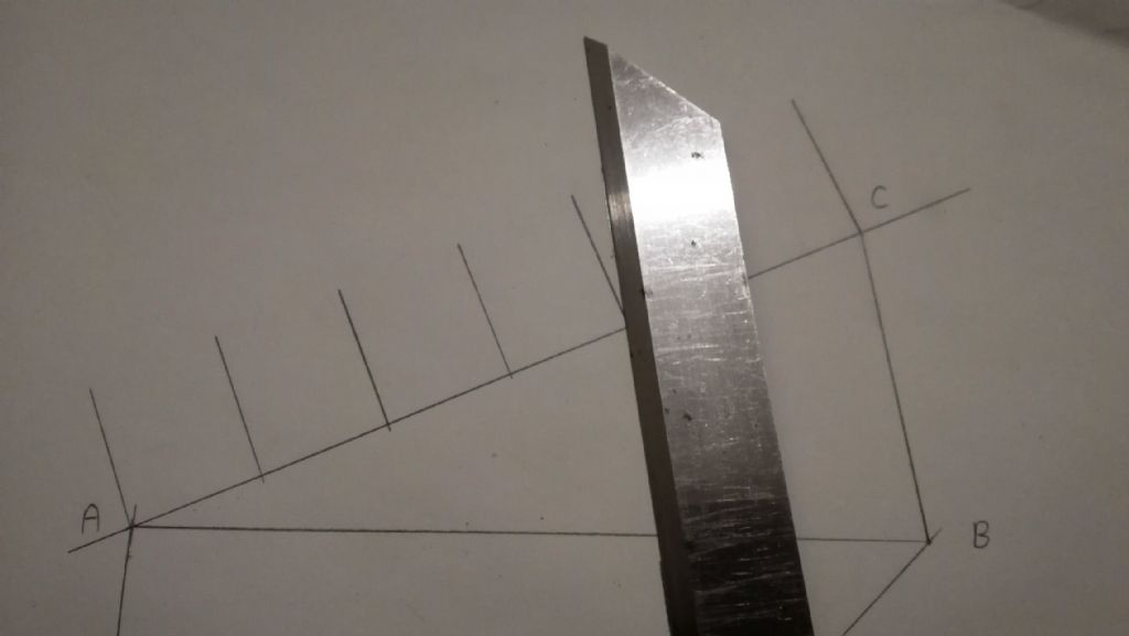

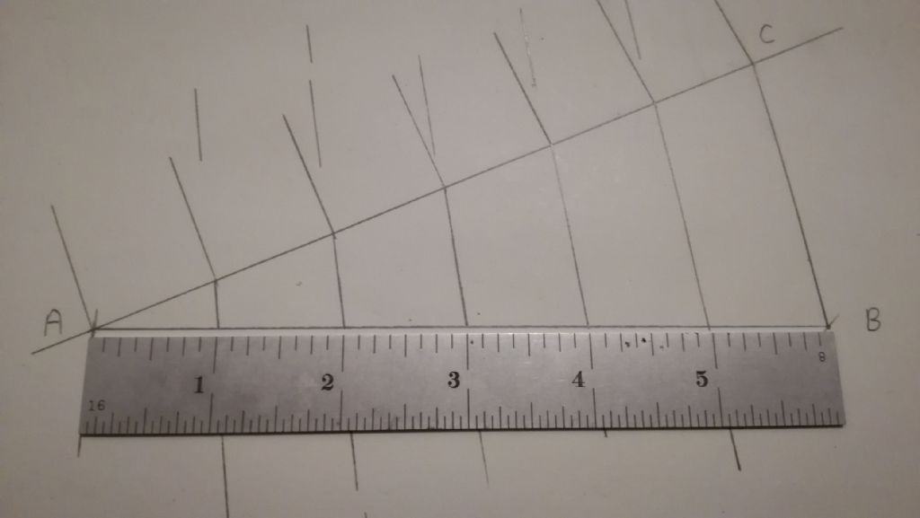

                            Nicholas Farr
                              @nicholasfarr14254
                              Hi John Doe 2, I did the above with just a my Moore & Wright No. 315 straight edge and a pencil, and as it happens the line at an angle was just right to get all the division lines just the right distance apart to allow each one to be taken from the previous one, but I don't claim it to be absolutely accurate. These next four photos show how it can be done to good effect. First draw lines A-B and A-C, then you can place the straight edge at about square to the angled line with one edge touching point A and draw a mark across line A-C, notice I've extended the lines upwards, that way you can line the back edge to each line and mark the next and so on, this way all the points on the line A-C should be equal.
                              Once you have all the points required, you next join point C to B with the first line. In the case of this drawing, my straight edge is wider the the divisions, but putting the back edge to the line C-B, two short guide lines can be marked on either side of lines A-B & AC and the straight edge can be placed on the next point and adjusted by eye to get an even gap between the guide lines and the straight edge.
                              It is a bit long winded and you need to be fussy with the points and lines and the finest pencil will help. I'm still not claiming that it is absolutely accurate, but the rule in the photo below shows that it works very well and I have only used this straight edge and a pencil.
                              Below is a scan of the drawing without the rule and when I drew the division line marked D, drew the other two lines at the top and bottom the get better alignment for the guide lines for drawing the last line, as the division line D was a bit short.
                              Regards Nick.
